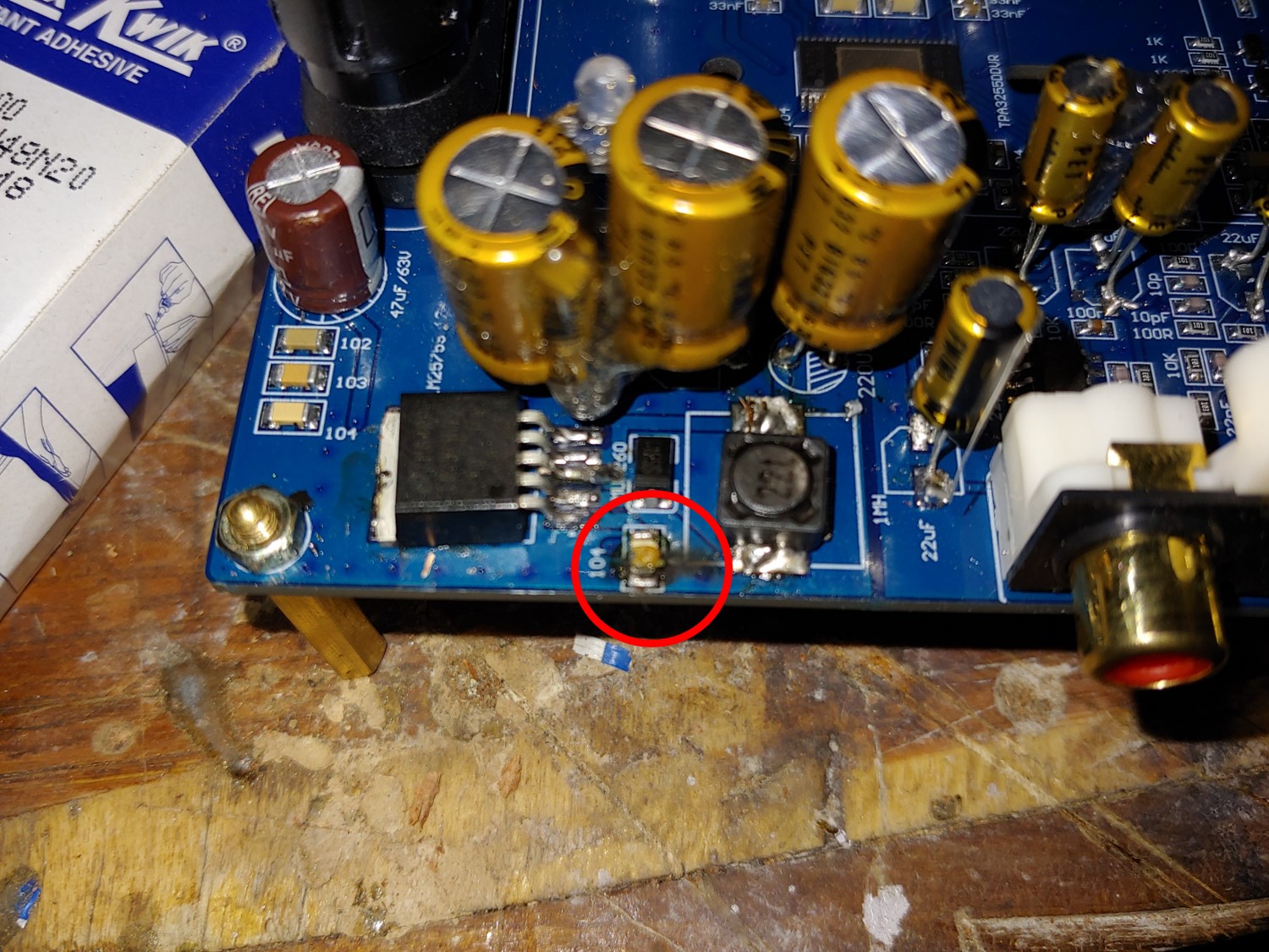

got a tpa3255 board from aliexpress. changed the 10uf and 220uf caps. changed inductor, changed the LM2575 to HVS -12. switched on and magic smoke from this resistor which is exploded. what resistor/cap do i use to replace?
Does the board worked before modding?
now its more complicated to look for the correction.
future proposal:
modification step by step...
this is a cap..104 ....SMD 0603 size ---- brown cap capacity is 100nF
setup is in pF-> 10 +4 digit zeros = 100000 pF --> 100nF
resistor should have a number labeled - e.b. 4k7, 473, etc.
actually im in the office and my time is limited..this caps should be a filter cap for the output or input...i am not sure - i am not an expert at regulator .....look at the datasheet
check if the LM2575 has no shortcuts.
measure the input voltage and the output voltage if the regulator is still working.
chris

Thankyou. Board worked before mod. though not played musicDoes the board worked before modding?
future proposal:
chris
checked for any shorts/continuity before switch on. not checked output voltage. will check and try again after replacing the o.1uf cap.
in middle of moving house so not much time. thinking of just settling with a class AB board from a local manufacturer.
thankyou
