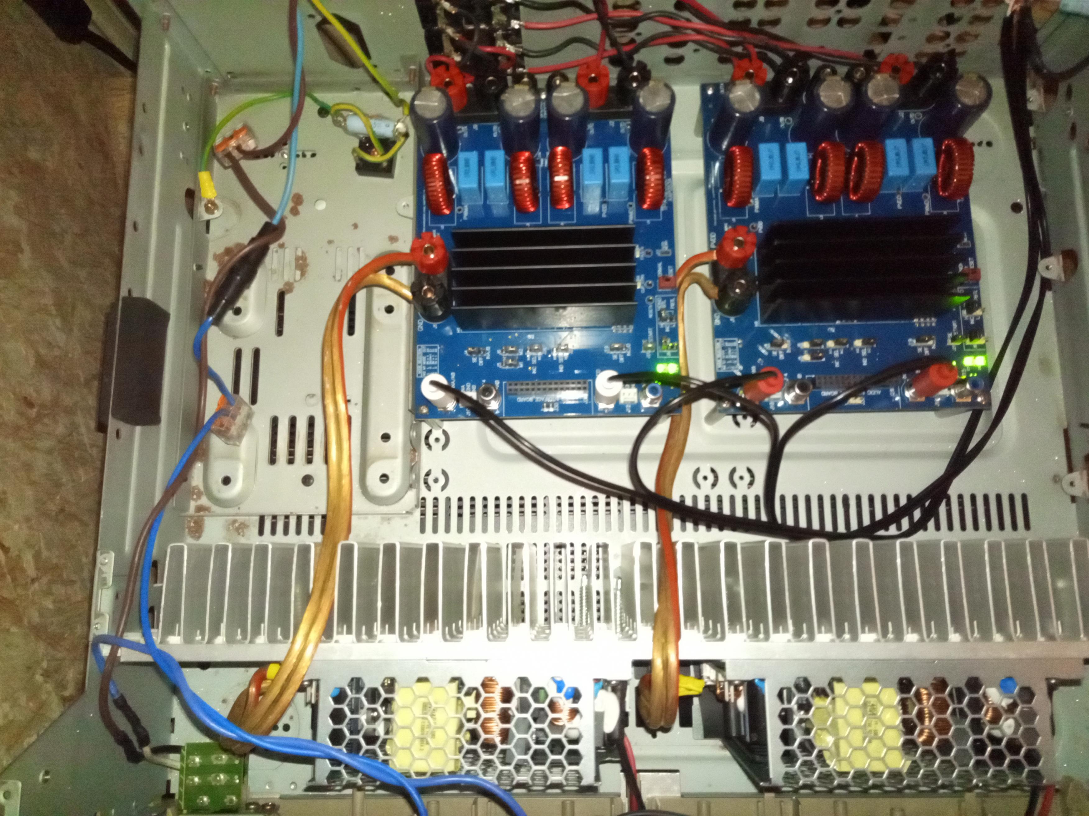

... Been a while. Finally got my 2xTPA3255 EVM setup in a box, with dual mono psu, but there's white noise. I got sensitive speakers, so the noise is somewhat intrusive.
They sound very nice, just can't handle the noise, so I put it back on the shelf for the time being.
Tried numerous pre-stages, same thing.
Any hints or tips?

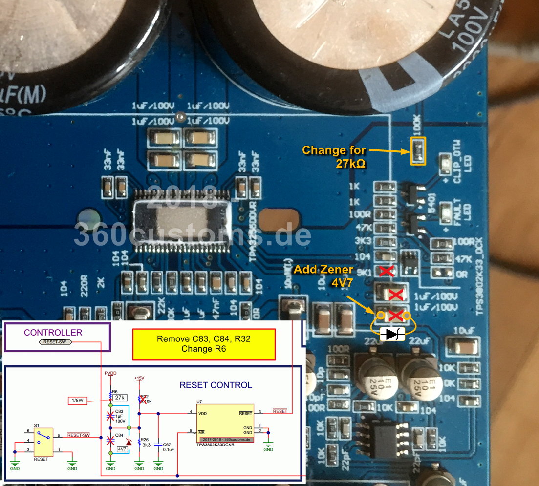

yes this smal 5 pin is the tps.....😀
ok let´s try at latest on the weekend something...
chris

Wiring is very important. Can you share detailed pictures
Hi Chris,
I had a quick look at the circuit proposed by "The Doctor" and The Doctor is clearly the best to advise a solution to your problem.
My immediate doubt was to the 4V7 zener that, if used, will result in a voltage in the order of 4.7V on a /RESET input that as "absolute maximum" allows 4.2V (3.3V logic)! I may have overlooked a detail but else, complaining about performance when the operation is above the absolute maximum rating could seem illogical. Perhaps a 3V3 or 3V9 Zener?
As Zener tend to limit quite “softly” quite before they reach their hard knee point, 3V3 will not work nicely as the threshold point will reached current and temperature dependent. The VDD pin at TPS3803 can handle a maximum voltage of 7V. The RESET output voltage is then roughly VDD-0.1V. BUT when using the correct resistor divider tightly bound to supply voltage, the voltage seen by the TPS never reaches 4.2V which is the maximum input voltage fr the TPA32XX Reset input. Additionally the current into pin is limited by the upper resistor dividers value. (Noob proofness of course would need an additional Zener at the TPA32XX Reset line)

Was thinking I should flip the heatsink with the 2 x SMPS firmly attached, maybe a little bit of distance and metal would fix it.
Grounded the chassis, even tried some of the old gnd tricks to isolate noise, as I originally assumed it was my source, but no. Moving the signal wires about did a little, but not much.
I *could* put the signal wires under a steel shield, but have to make it first.
Thanks, you have taken account of it.

Pictures and a wiring diagram would help. Are all your heatsinks isolated from GND?
The heatsink with the two SMPS is grounded, through the chassis. I tried without gnd first, was a bit worse.

Any shielding may be helpful to reduce hum. But you wrote explicitely "white noise" - and this normally originated inside the amp or pre-amp.
Could you pls upload a sound sample of your noise? Or, could you measure the noise with ARTA?

Yes, it comes from the amp, not the pre-stage. Sounds a bit like white noise.
Here's a picture after I flipped over the heatsink, a tiny bit better, but not much.
I'll try switch to the se-600-48 psu just to check.

It seems a bit quieter with the 600w psu, but the thing is LOUD, gonna disconnect the fan so I can actually hear anything.
Edit2:
Oh, wow. That is much better. Even less noise on the speaker with no fan, must be some disturbance thing going on.
Still not 100% quiet, but I have to listen for it to notice the noise now. My dawning tinitus is a tiny bit worse, then there's the heat pump fan. But yeah.

Hi KaffiMan
Are the SMPS earth connected? cant see it on the pic?
avoid crossing of RCA and power cable -look at the right amp...my poroposal is to keep as much as possible the distance between signal in and power cablesand
drill all the cables...if possible...
chris
Chris, yes they are earth connected, through the chassis. It was the PSU's.
Changed to a single SE-600-48 and it was much better, at least after I removed the fan.
I am familiar with the various cabling issues. Tried holding the cables in various ways and also having a sheet of steel in between, just to find out which cable placement would work. With the dual mono PSU there seemed to be noise everywhere, some places more than others.
Having signal wires cross power cables can work well enough, provided the cross is perpendicular.
Now I want to add a resistor to the psu fan, just to have a tiny bit of movement in the air. And next is using a better source than the minidsp 2x4. Will try the ADAU1466 EVM board and use optical in to isolate everything as much as possible.

Hi KaffiMan
ok.
if i build my amps a always get the mandatory hint to connect an extra cable from the AC socket to the chassis.
some surface of new (black anodizied...) or old chassis are not really give good contact--> so i scratch on the chassis at the point where the earth should be connected
chris
