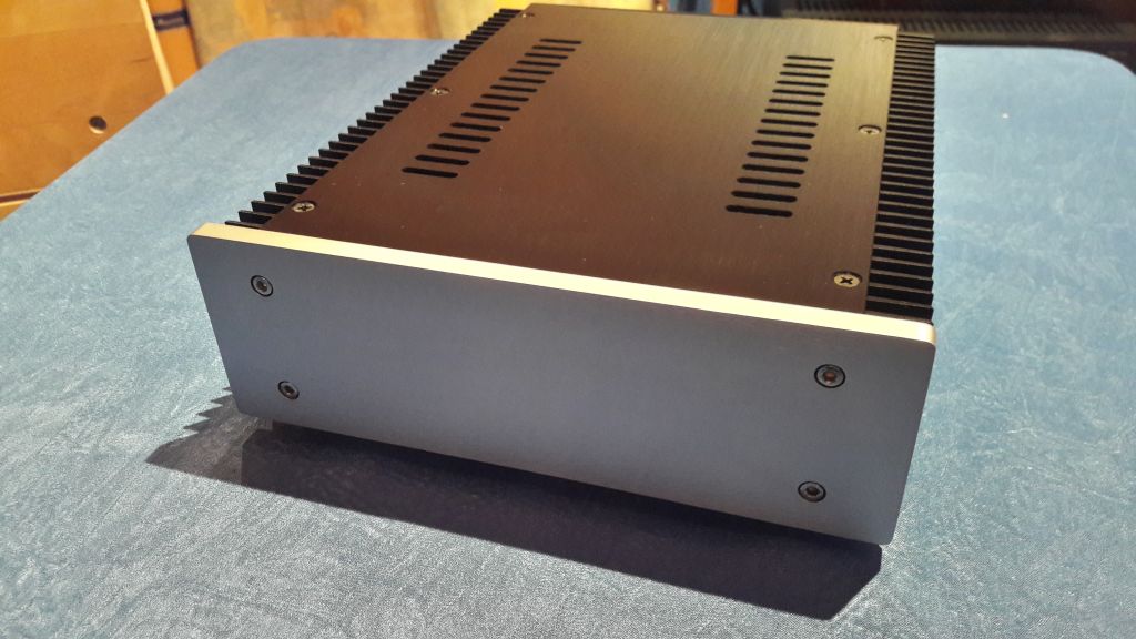

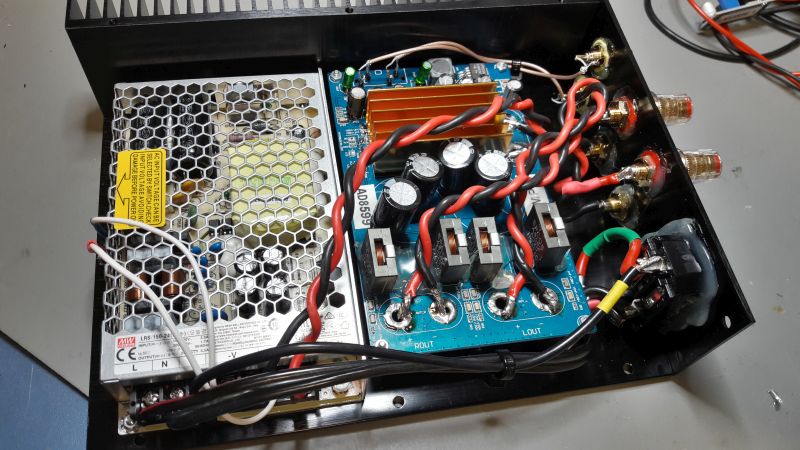

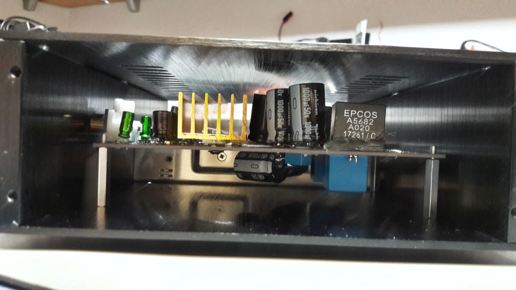

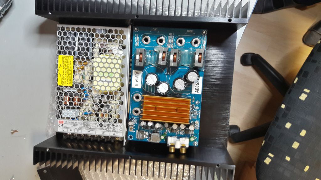

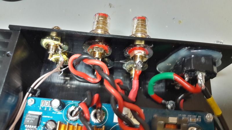

Fake Amp

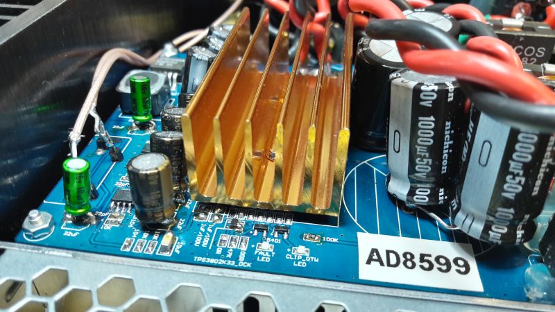

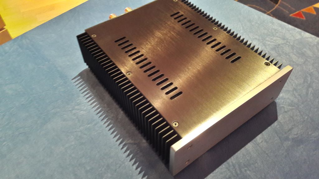

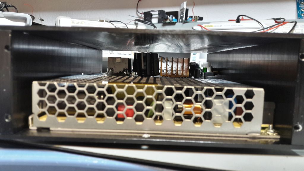

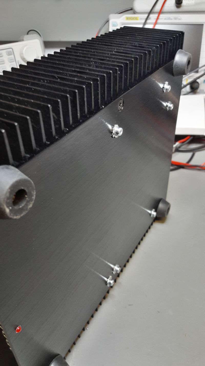

Hi
i smal amp in a very tight housing is born😀 ---Fake Amp !...its because the heatsink on both sides😉
after some installation ad de installation rounds🙄😉 i found a good version for this housing...
opamps AD8599, muse input caps..decoupling caps 6x100µ/50 lowESR by Nichicon. voltage regulator is the original 2575 but with corrected coil and caps.
smps is the small LRS150-24 set to 28,5V ,

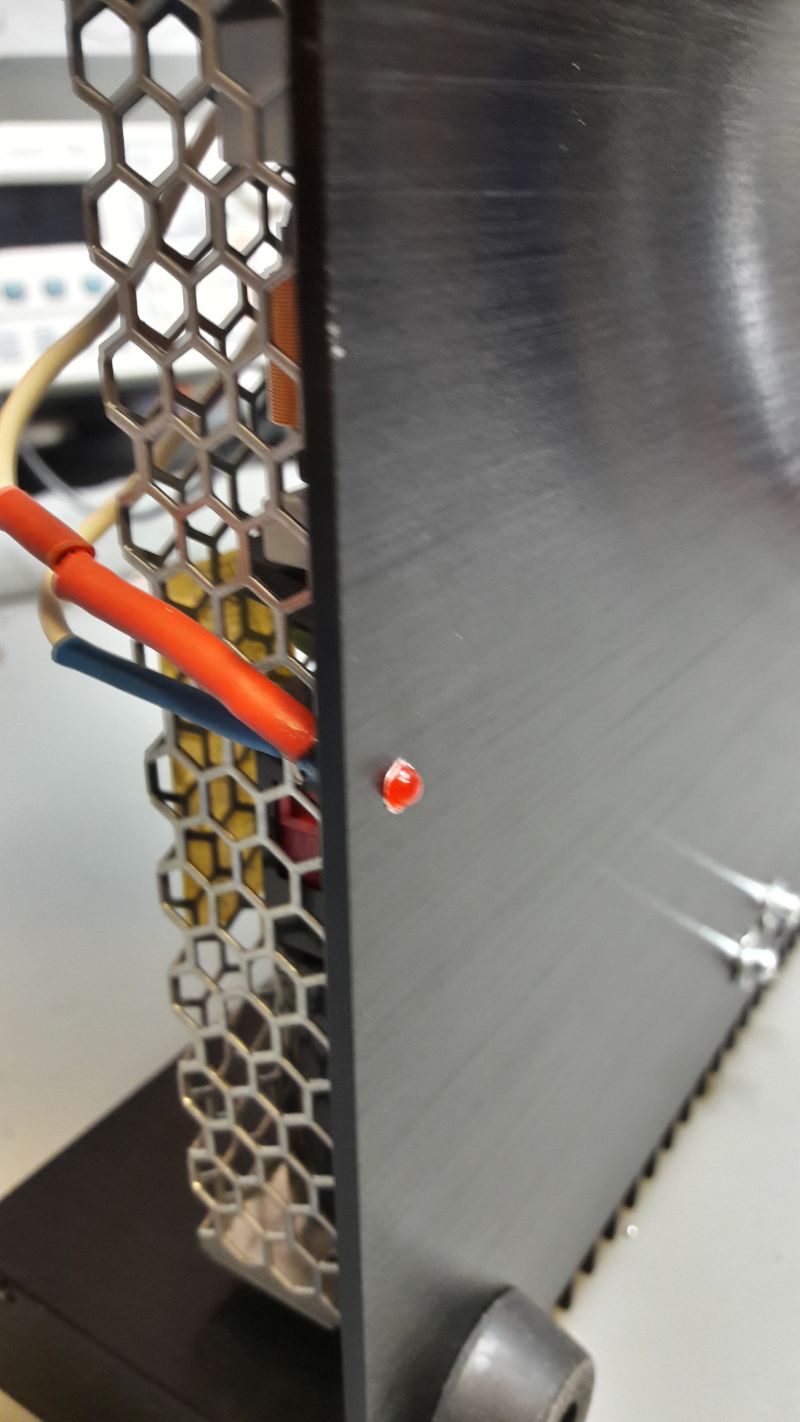

i tried a power indicator -small red LED at the bottom plate...but after the front panel its not really visible😛
chris

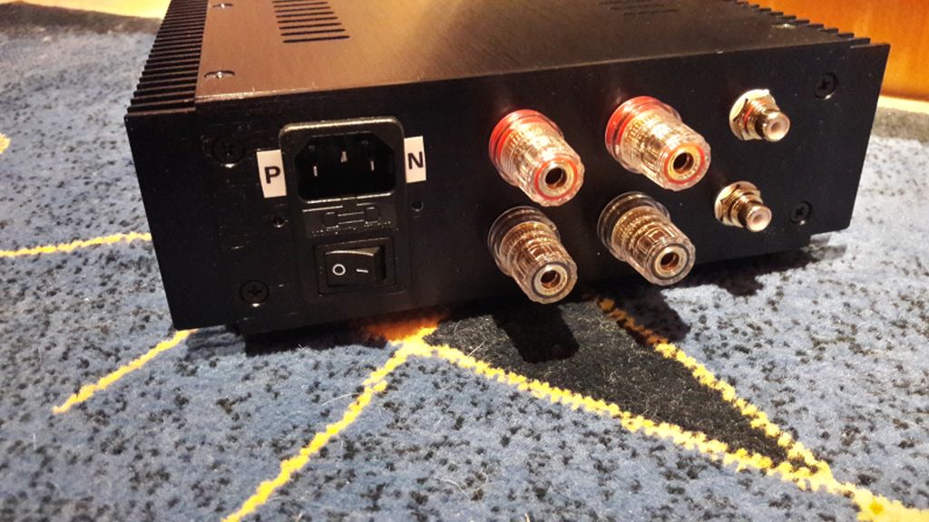

You will not be dissapointed.
the AC connector is not the original because i have to use a AC plug with switch...no really a room for an extra switch😛

Any overheating issues? Do you think it could use a fan? or some sort of heat transfer to the case heatsinks?
Hi audio Mo
if you read the complete posts you will find a constant power/current test with 40W ouput on both channels about 42minutes...then i got 102°C on the heatsink and yes the overheat protection of the TPA chip switched off
my personlly experiance with this board is for living room listening no fan is needed
chris
Hi audio Mo
