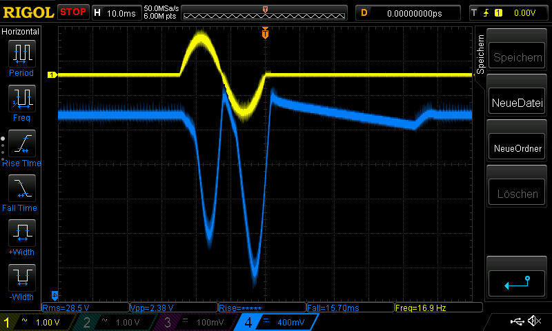

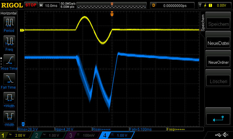

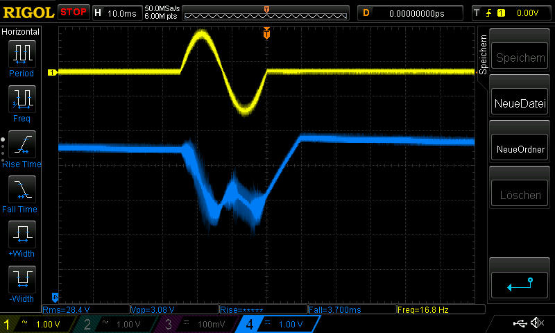

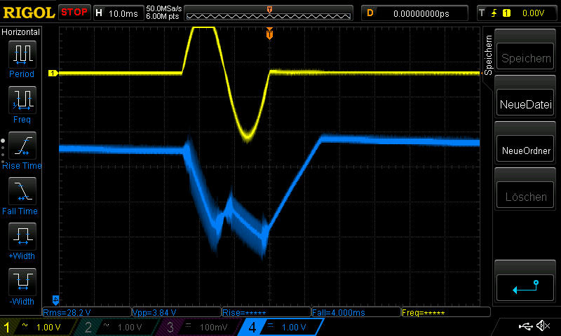

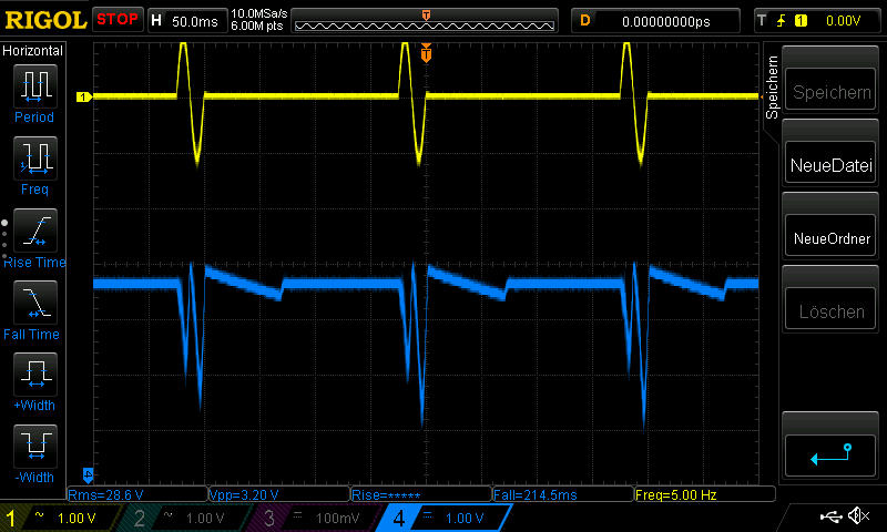

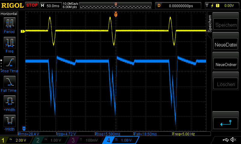

the scope probe is not on the smps . now its on the amps supply terminals

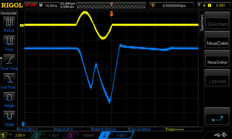

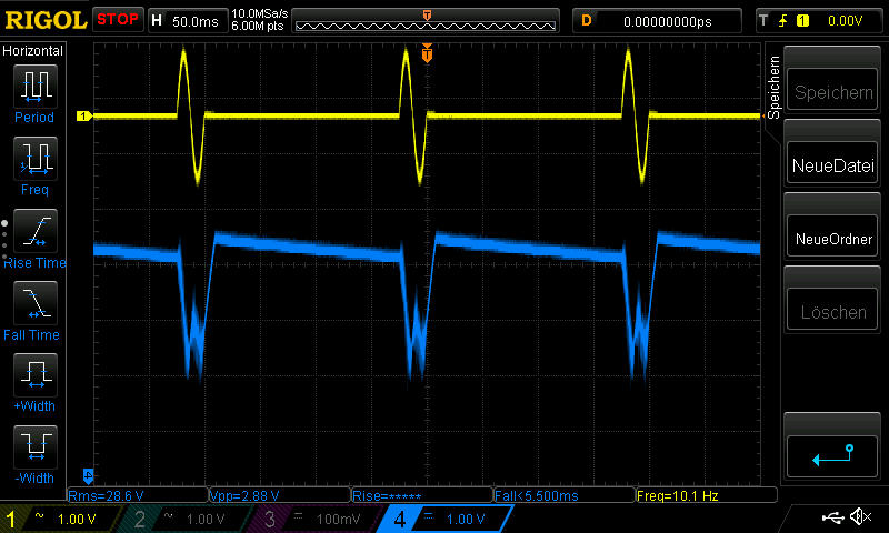

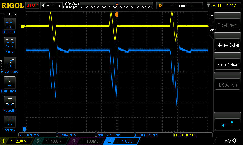

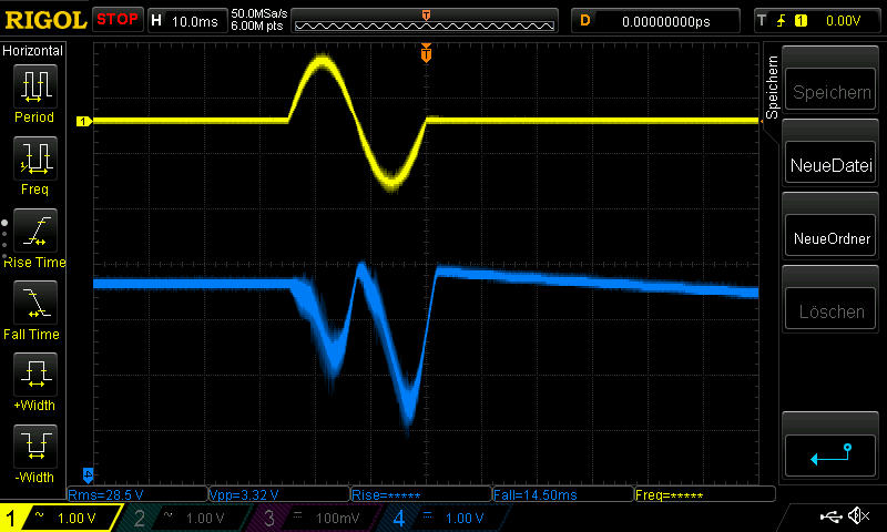

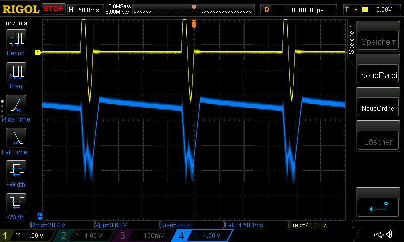

pictures with a CRC supply after the SMPS= 4x4700/35V -0,05R- 3x4700µF = about 33000µF
pic1+2 are with 40hz, 200ms 800mVrms burst
pic3+4 are with 40hz, 200ms 1300mVrms burst
pic 5+6 are with 2x1000µF/50v low esr uhe nichicon 40hz, 200ms 800mVrms burst
pic 7+8 are with 2x1000µF/50v low esr uhe nichicon 40hz, 200ms 1300mVrms burst

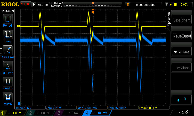

now the scope probes on the smps terminals with 2x1000µF caps
for comparison
for comparison

The visible audioband ripple mostly is a matter of caps impedance (ESR). Assuming 2A load audio ripple creates 40mV ripple across 20mOhm ESR for instance (assuming sufficient capacitance or high frequent audio signal).
Assuming traditional supply with 10.000uF may give you slightly lower audio ripple. But, being without regulation, you will notice the "smearing" of the way bigger 100Hz sawtooth rectifier ripple (1Vpp @ 1A load)

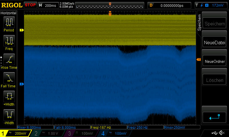

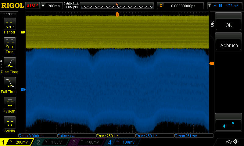

i checked the noise yesterday directly on the terminals of the cap. SMPS on amp on / amp on with signal 100mvrms. the different is nearly nothing...why? i
what is that singal?
during my testing i use a sweep 10Hz-35khz 150mVrms input at both inputs.
if i look with the scope diff. probe on the amp supply terminal AC coupled - i can see the frequency swwep in the noise singnal. what is that.....waht is that called?.... is that because the voltage regulation has a bad PSSR? (LM2575)
time to do the math:
What is output voltage and load impedance? -> calculate output current.
What is Power supply decoupling cap on amp PCB and its ESR? -> calculate voltage ripple to be expected
Besides - how can PSSR of LM2575 influence voltage ripple on power decoupling caps? I do not get this.
Generally excessive power decoupling caps are more often than not counterproductive when fed by smps.
A good amp design can handle a certain amount of supply ripple, and in reality you will not find any "ripple-free" supply.
So - where is your limit?
I assume that the levels shown by your plots are good enough to be of no significance for resulting sound quality.

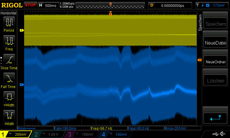

and same strange bumping as described before post 541!!.. i see the 1khz tone directly after the input cap is here but its bumping. that mean that you can see the signal..but in not regular periods i see the signal going up and down. so i set the time on my scope very long to see the bumping.
during changing the caps the pcb pads or off the pcb so this quality of traces are bad. i directly connect between the rca and solder pads with a smal cable...doesnt help......changing other caps are not solving this problem
yellow scope is input directly at rca
blue is the measurement after the first caps...
strange...?

re checked after this strange things with an original board to see if my equipment has some error......no the measurments are ok.
could that be that the pcb traces are bad? because during i mod this board (withut cheking in original state) doing something strange..

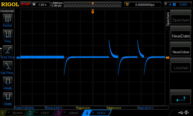

...2nd board....pop on off noise...with mute switch
...second board makes troubles.....as i wrote...🙄😡
during testing my boards at the weekend between different power supply i use my nice board which i used for along time for 4R config, new opamp, new caps everything was fine.
the last time i want to use it i get surprisingly aloud pop noise....i use the switch and i never had this before....
any ideas? now i have the switch and during on/off i hear a loud pop! during mute the amp is still yueit so its working...but the pop is new😡
see pic 1+2 for left /right channel output.
