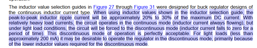

i checked the pics of post 540. i read the datasheet and there is written something about discontinuous mode and the graphs shows exactly the same.
so i understand that the smaller inductance is because of the peak current and you have to calculate more power I * 1,3 and therefore a value with less inductance.
pic 1
correct?

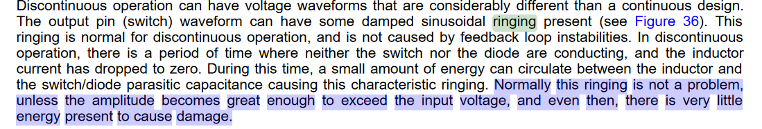

i found a chapter in LM2596 (its the same chip but quicker 150khz)
that ringing is a problem if the voltage exceed the input voltage
pic 2

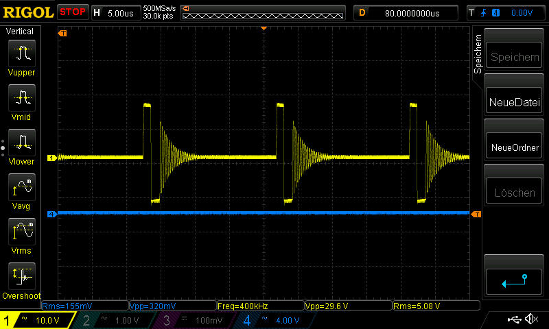

i use 28V psu = input of the regulator LM2575T-12 and the ringing at pic 3 (#post 540) is 29,6V. ...correct?....

You observe this kind of ringing in dscontinuous mode of a buck regulator with clamp diode. This occures at light load, when ripple current is bigger than load current. This is not harmful per se, in most cases this will not produce audible interference.
To avoid discontinuous mode at low load you can do
-increase inductance
-increase pwm frequency
-reduce input voltage
This mode does not occur when using a synchronous rectification buck regulator (syncbuck).

so this grapsh shows that the regulator is indisc. mode = that menas that according to the datasheet the current is less then 200mA?
Correct?
it was audible...its was the clipping led which makes me nervous...😉
