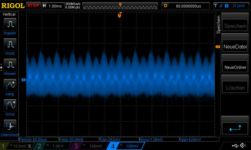

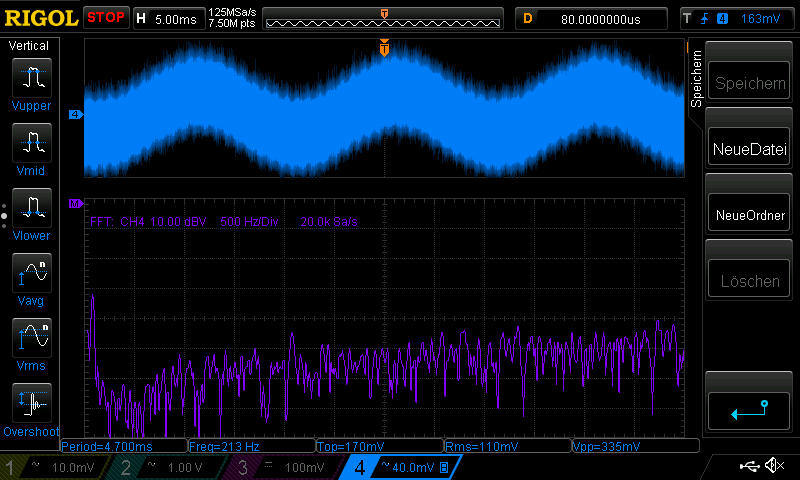

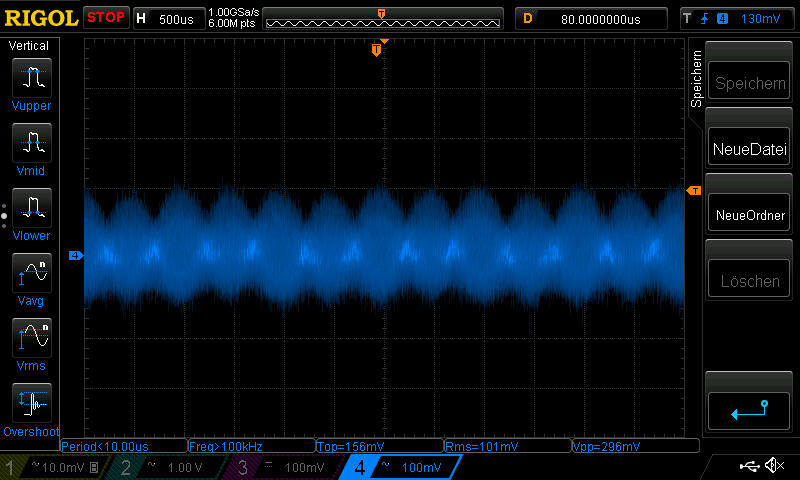

noise compare 3251EVM vs YJ3255
Hi

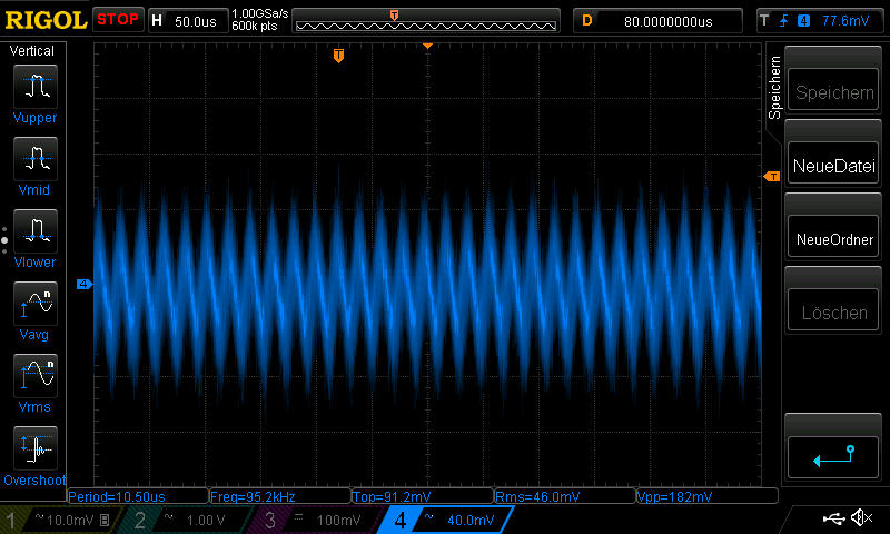

I did some scope probes..
I use my psu - LRS 150-24 (28V) which i use for listening and try some measurement directly on the terminals of both boards. the psu is noisy.🙄 iput shorted amp on - 4R load
pic 1 +2 YJTPA3255 on / off
pic 3+4 3251EVM , YJ3255
opamp pin 5 = V+
here seems the YJ3255 better..

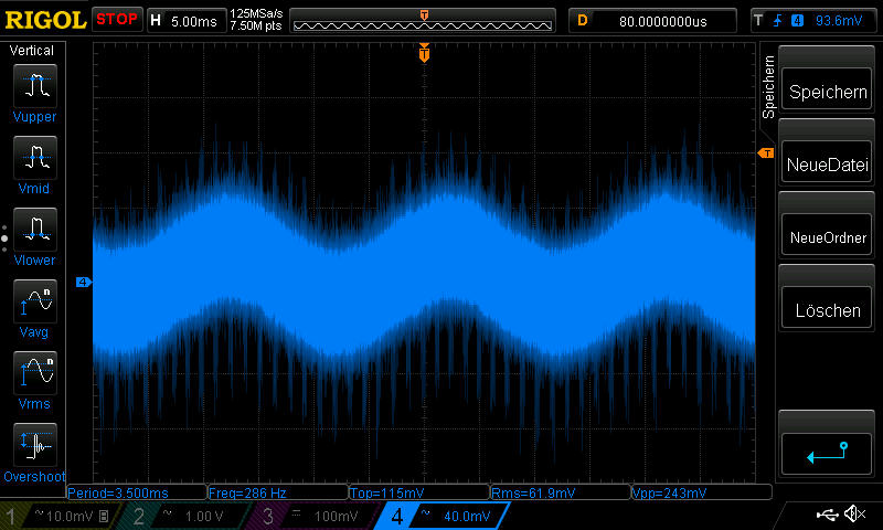

and directly at the + of the decoupling caps with a input signal of 100mVrms into 4R.
pic 5+6
YJTPA3255 are the original caps ... - 3251EVM
is the 30% more "ripple" the reason of slightly more noise of the YJ board??
128mV rms vs 101mV rms

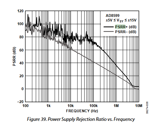

AD8599 - opa1602 compare
Hi

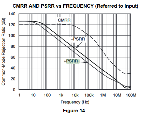

after a burn in phase of my opa1602 board i find this opamp is not just cheaper its sounds nearly the same-slightly better.
what is technical the big difference of this opamps?
the boards are identically setup - 4R speakers "Disco M"
both YJ board give some noise if you switch on at the speakers and you go with your ears to the membranes.
please give me some information about CMRR,, PSRR. if i compare this datas in both Datasheet the opa1602 is better. Is that a value that could be effect the SQ??
pic 1 AD8599
pic2 opa1602
thanks

There is no evidence that burn-in of OPAs is of any significance for audible sound quality.
Same applies to some technical data - which might differ - but at levels far below audibility.
Certainly this does not apply to the golden ears who hear differences far beyond any measurements due to their extraordinaire unrivalled capabilities superior to the average deaf humans.

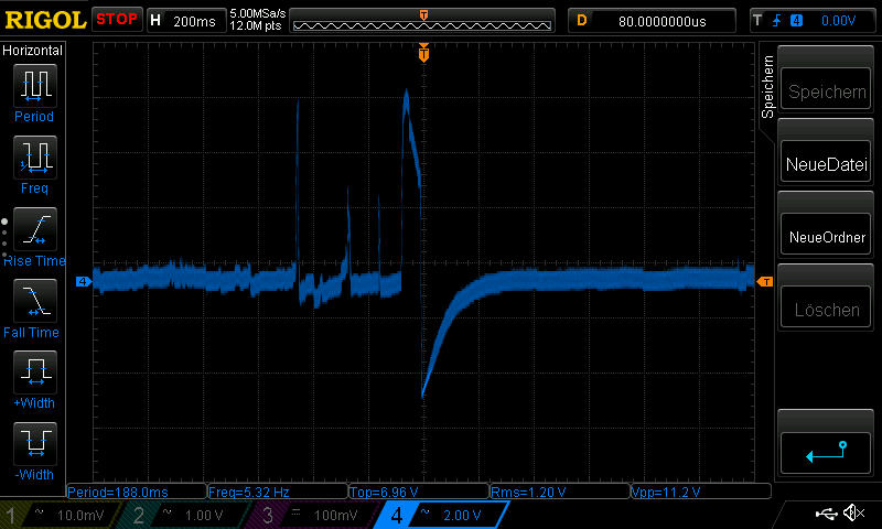

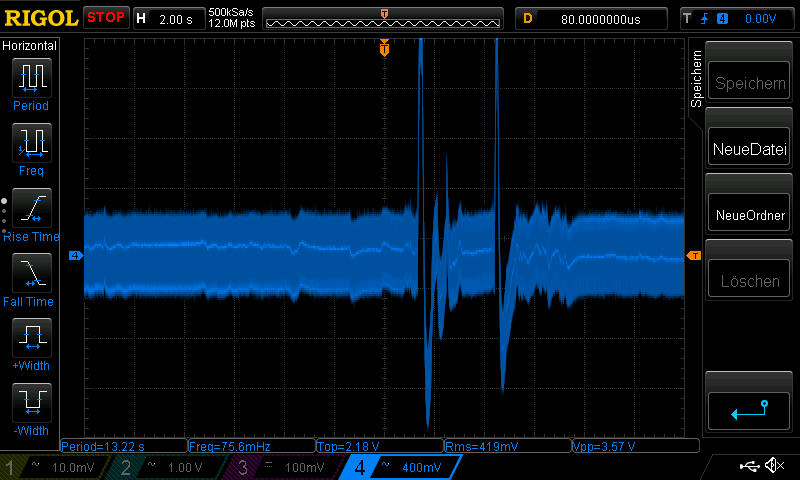

amp7 8R config...input spikes ???
Hi

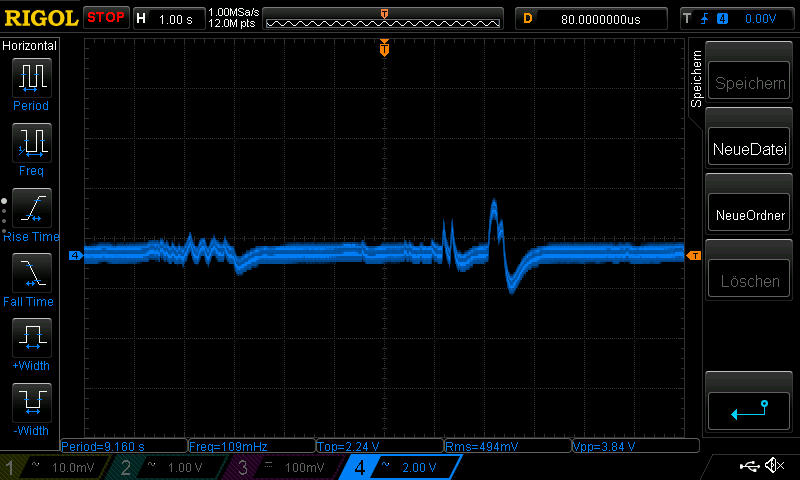

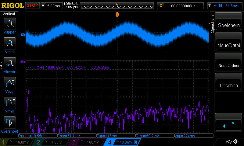

for my 8R board i am finished but i got in my lab some clipping led flashing. so i do not use a speaker in the lab. with no input signal but amp powerd on i got at 28V in 8R some oscillation from 8 Watt to 11watt power consumption-so i checked the inputs- pin 1 or directly after the 10µF input cap on the right channel i got following pics.
pic 1,2,3 are pics directly on the R channel input cap - no input signal
pic 4-5 showing if i set 200mVrms input on both channel - some spikes are more than 2V !!!😱 so the clipping goes flashing and the consumption of the amps jumps into 55-70Watt shortly ...as i see on my rigol DP832 psu😱
i re solder all input caps again and the smd 10k resistor...is this a typical oscillation because of this 22pf at the opamps??? if yes i have to change these bastards...

The traces are smeared. Maybe some oscillation. You might vary the time base of your scope until this smearing is synchronized and some kind of periodic oscillation becomes visible.
yes i will try.
the period of the 1khz signal is too short to show this. i saw the 1khz jumping up and down......

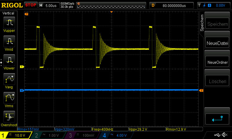

i try to check what happend with the board.

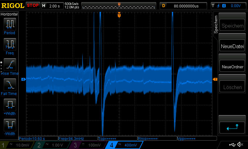

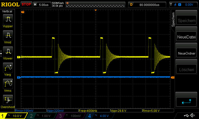

here are some voltages directly on the output pin of the LM2575T..😱
yellow trace
pic 1 is DC measurement
pic 2 is AC
pin 4 shows nothing??
....now the board is dead...no power...i think the regulator died......🙄🙁
because i haven´t got a LM2575T-12 at home is it possible to mount for pin 1,2,3 a 7812???
thanks
chris
