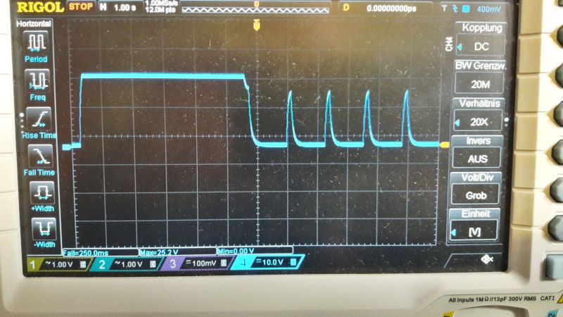

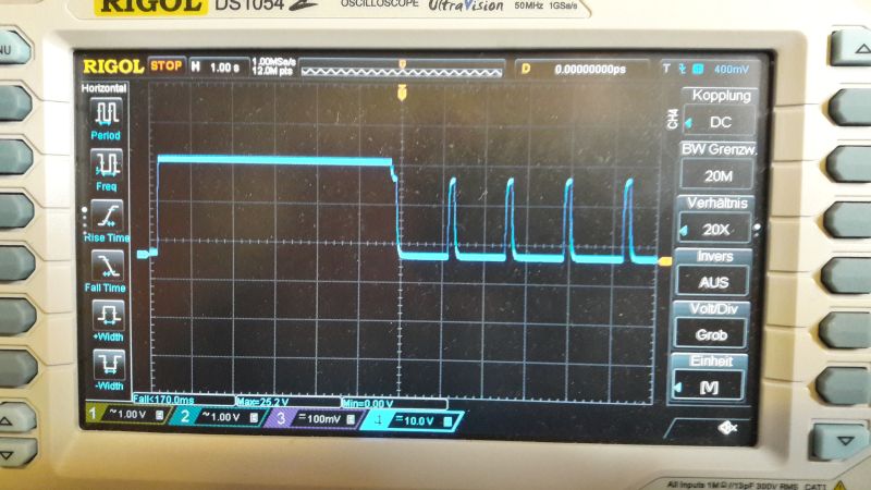

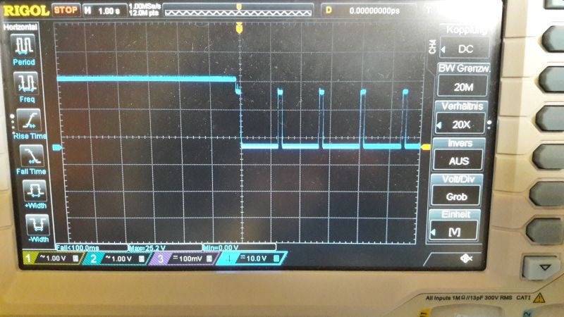

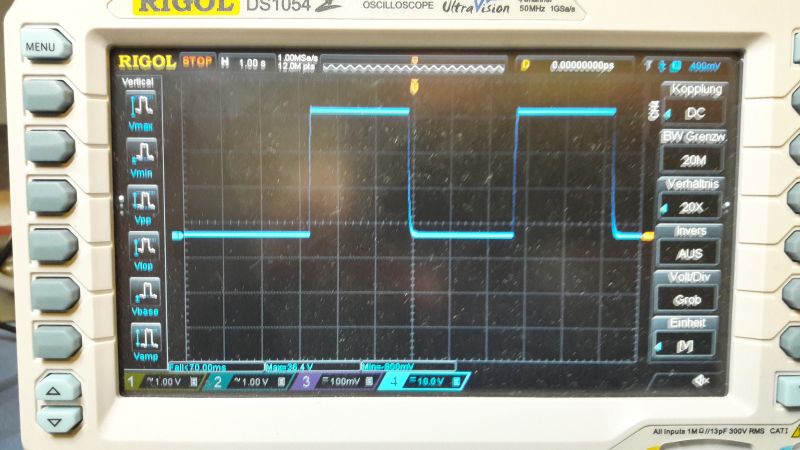

smps test meanwell ..
Hi
after a hard office working week i am back with some measurments. i read in other thread about the smps and so i start a short test for the Meanwell LRS 350-36 and LRS150-24 which i plan to use for my prototype amps.
i want to see the hickup mode and which load is pushing or not.🙂
as i learned from doctor and other here in the forum..with about 12mF or more the hickup mode will not been solved.😀😉
first i my pdf with my measurements
pic 1 LRS350-36 with 2,6ohms load - hickup without caps
pic 2 LRS350-36 with 2,6 ohms load- hickup12mF caps
pic 3 LRS150-24 with 2,6ohms load - hickup without caps
pic 4 LRS150-24 with 2,6ohms load - hickup 12mF caps
pic 5 LRS150-24 with 2,6ohms load - hickup 33mF caps
chris

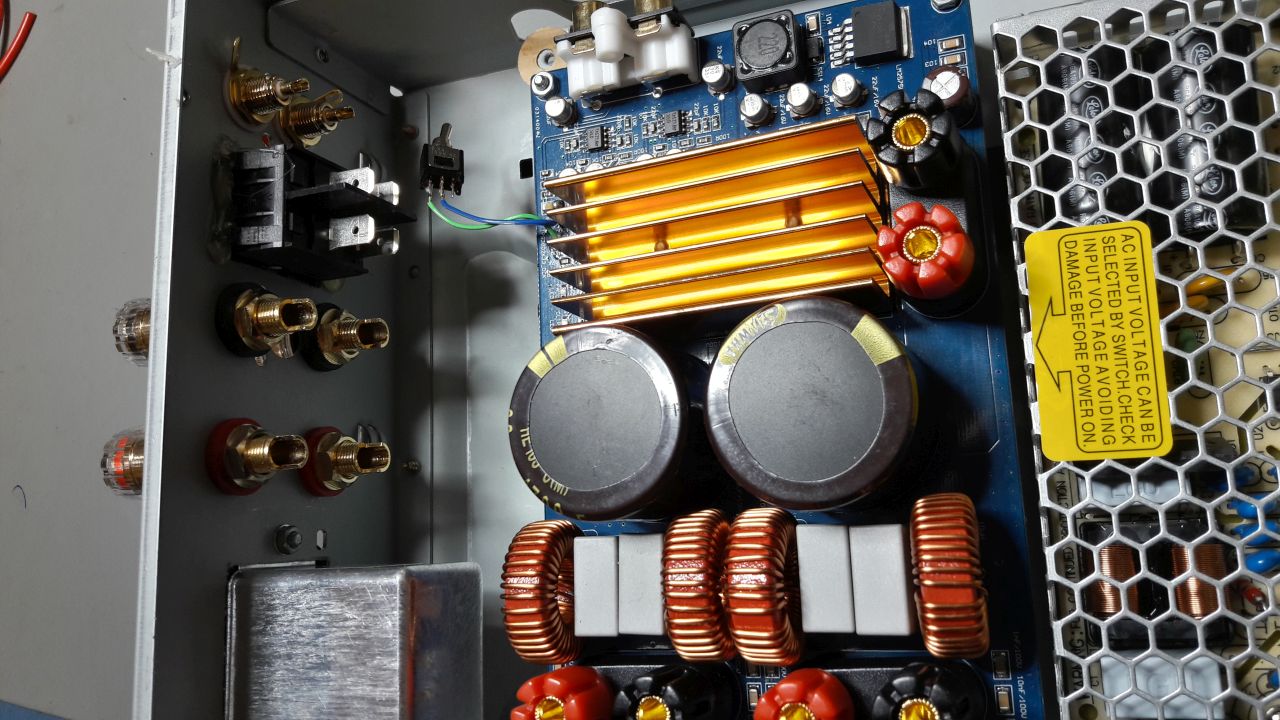

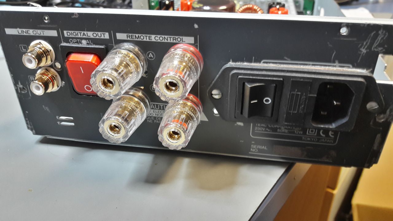

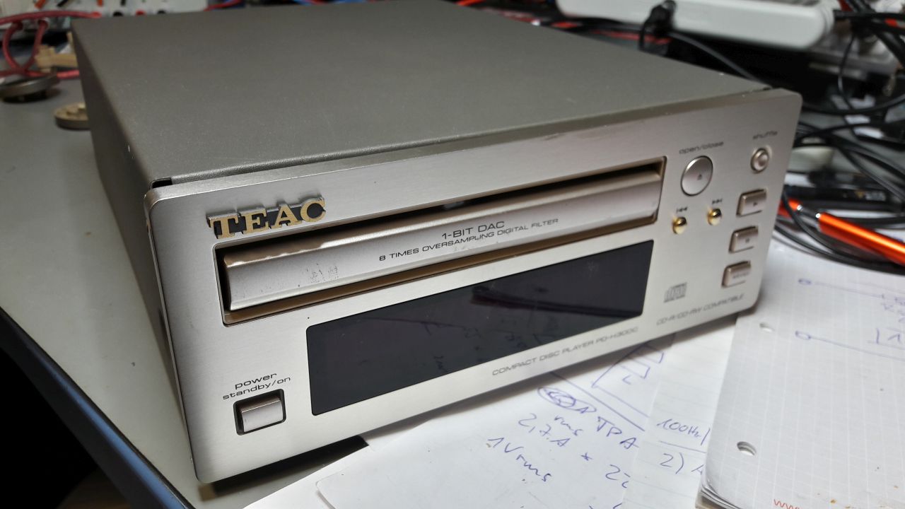

Amp light
my first protoype will be a small amp in a litte nice housing.
the "AMP light" 🙂
i will use:
YJ TPA board (after SQ test i will decide which one...here its the original) configuration is for 4 ohm speakers
LRS150-24V because of the limited room in the housing
1 pair RCA connectors
1 power switch with fuse and filter (its the version for a bigger amp but...)
2 pairs of output connectors
1 mute switch for power on/off..actually i haven´t realised doctores mute circuit
cu
chris

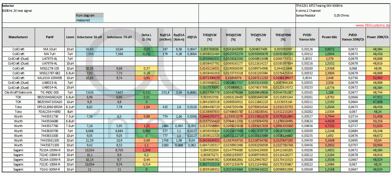

Dear Doctormord,
I saw on your website that you were using Codaca inductor, with a similar shape to the Wurth inductors highlighted in TI LC filter design paper.
Maybe difficult to answer, but do you expect those Codaca inductors to result in similar performances to the Wurth ones (not too far away) ?
If not secret, what are the exact ref that you used (they have a quite packed catalog for high current inductors I those values) ?

Oups, I found my answers in the "correct thread:
TPA3255 - all about DIY, Discussion, Design etc.
Ref seems to be CSCF2014-6R8M

as it expected, the best inductor has more turns and the bigger gap that makes saturation current about 22A. The drawback is higher Rdc but that not a big problem at all. Material #2 inductors have a good linearity as well, however, their magnetic field is almost not shielded and will affect S/N and THD again.
They're basicly the same as the more expensive Wurth inductors. An alternative are FerroCore HCI2114-7R0.
