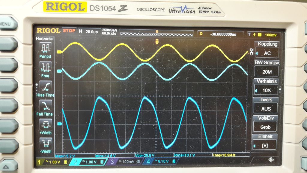

Have you measured the opamp outputs?
(Before/after the interstage coupling caps, so you can see if it comes from the opamps or the amplifier itself)
hi doc

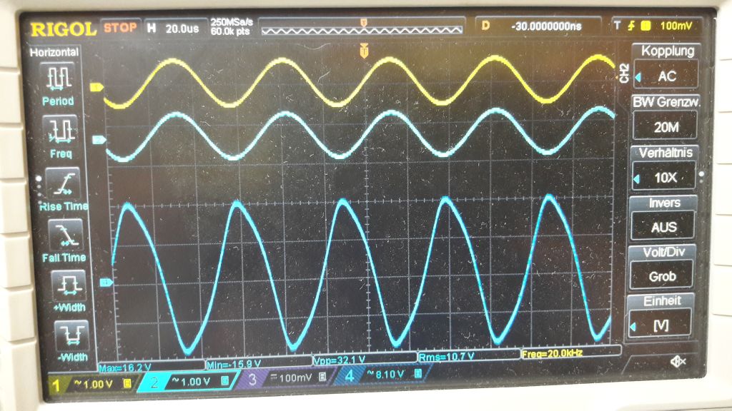

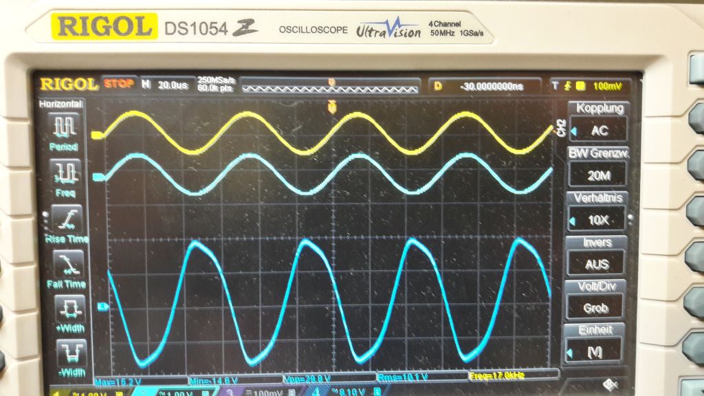

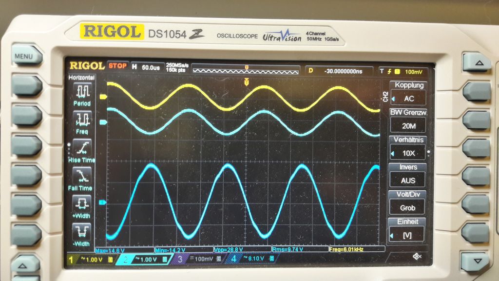

i made the measurements:
8 ohms load, 400mVrms input
yellow - top curve is input at RCA R channel
blue - opamp pin 7 at TL072 or pin4 inverted
dark blue differential probe at output of the amp
pic1 6khz - here is the deformation starting
pic2 17khz- pin 7 at the opamp
pic3 17khz pin 4 inverted output
pic4 20khz clear deformation
so it comes from amp/output filter..i try to search for a point after the amp before the output filter...not easy...my suggestion is without heatsing on the output pins of the TPA...right??
looking at the scopeplots I see output levels of approx +-15V, i.e. you are pushing TL072 hard into the limits. The deformation might be overload recovery time. In that case deformation increases visible with frequency.
Normally I would not consider such levels being necessary to drive the input of any class-d-amp.
btw, pin4 of TL072 is Vee.
I don’t understand.
Hi doc
hi Voltwide
i try again..i see the deformation = no nice sinus wave at the speakers output--->
sinus wave on the scope display: from top to buttom
1
yellow is the rca input with the frequency generator 400mVrms measured at the RCA input socket
2
the line below is on the opamp pin 7 or pin 1 (not 4) output of the opamp to check if its here the problem with the "strange wave form" ...no its not
i try pin 7 and pin 1 to look if there is mybe a problem with the other output
@ voltwide its not + - 15V on the output of the opamp🙂...this is the last curve on the display its the output socket-->3
3
output on the speaker socket measured with differential probe
is it now clearer?...sorry if i was not clear.
i really appriciate for your time to help me.....😉

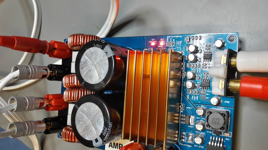

Hi

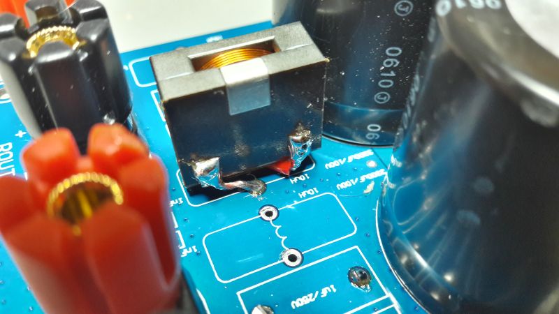

Anybody tried different coils on the YJ board? execpt Sybic 😉
i am thinking about to use better coils = shielded but the room for the LC filter is limited on this board.
my idea is to mount the output caps under the pcb to get more space for the 4 coils in BTL mode....eg.
VER2923-103KL Colicraft
7443631000 Würth
any suggestions?

Still waiting for PCB pics. 😉
Regarding your measurements.. have you scoped PVDD at the caps as well?
Actually i don't know whats going on there. I would desolder the filter inductors and try some flatwire ones which can handle the current to see if it affects the waveform. Do the filter foilcaps get warm/hot?
pics are in the fx502spro thread...but not able to view the layer.please reda there..
no measurement at PVDD🙄...do you mean the big one or the smal grey at the output?
new coils are ordered 😀

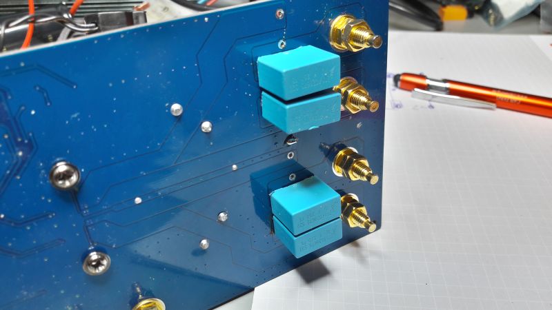

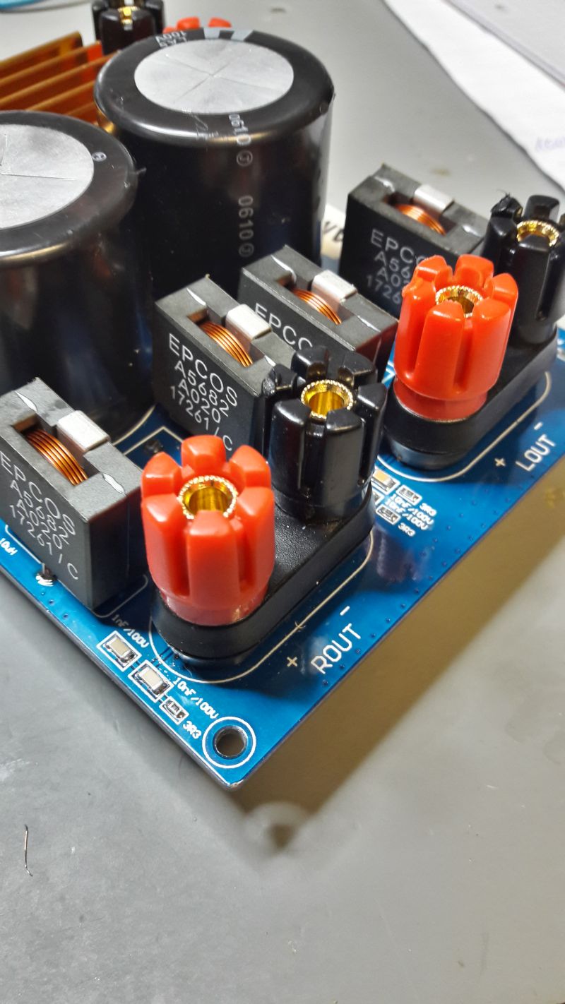

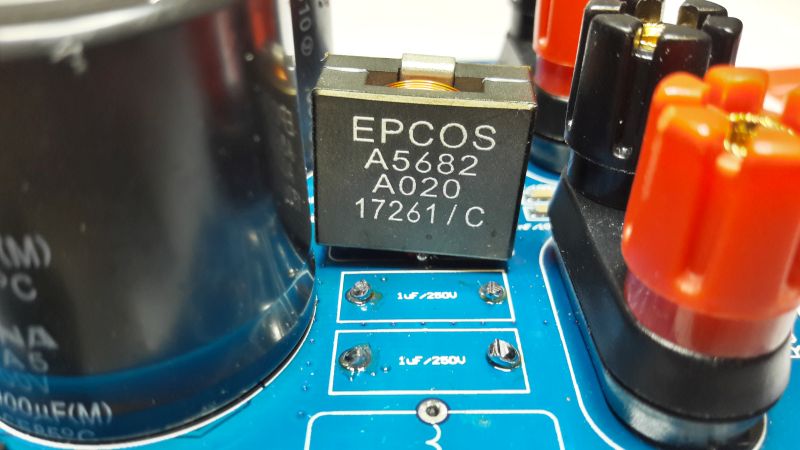

neverthless i plan some new coils in respect of the dimension of the board and the precondition output foil caps mounted under the pcb.
...9 other LC output filter...done..
its nice to get a package from digikey 4 days later...😉
i decided to configure the board as TI mentioned for 4 ohms = 7µH + 1µF
as i planned.......... the coils are strange to mount😀
TDK caps 1µF under the pcb
sound check will follow....🙂
