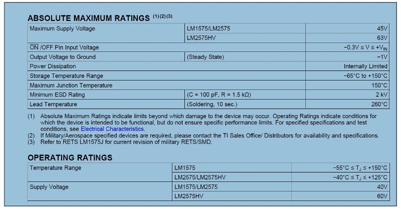

The supply is capable of providing more current for short demands, OC trip is at 140% if remeber correctly. (Depending on duration)
as usual...you are right...i checked the datasheet...overload 100%- 140%

please take into account the same topic which is mentoined by Doctor. The overshoot of the psu. the LM2575HV its max is 60V. so if you have a psu with 53V (you wrote me...) and an expected and guarenteed overload of 110%-140% with an + - 1% over voltage you get:
53V +5,3V = 58,3V ...so its neraly to the boarder of the LM2575HV.
chris
edit: i add the graph...attached

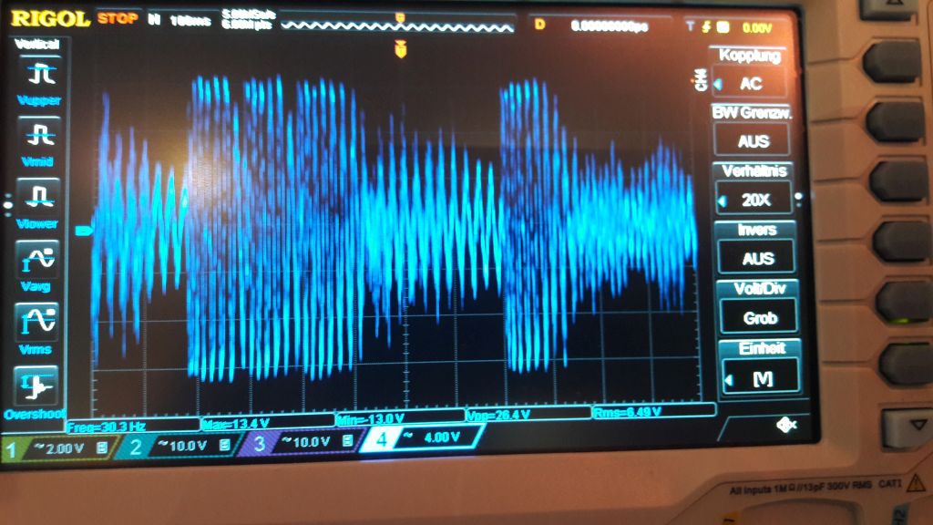

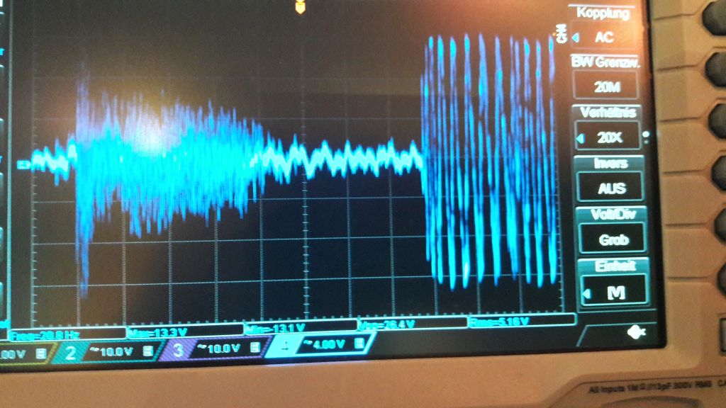

..power measurement...switch off....
Hi again
i checked with DMM the OCP configuration and it is 21,75 k ohm so it is near the recommended 22kR = 17A OCP
i cheked the KEF Q100 its rated official as 8 ohm speaker but i found some impedance cureve about 4 ohms...so some results say 4 ohm speaker. i xchecked mine. its sticker is 8 ohm but i measured with my DCR 3,60 ohm.. so i say 4 ohm speaker
scope measurments with differential probe (testec TT-SI 9002...@20X):
music title 41 sec at Desiigner - PANDA =switch off
pic 1 the shot of switch off...29,4Vpp
pic 2 +3 are shot about 26,4Vpp
so the amp is switching off...so if i take 4R speakers how to calculate the power?
Ppeak= Vpeak^2 / 2*R
Ppeak=29,4^2 / 2 *4
Ppeak= 55,5 WATT per channel
correct?
for loud volume without switch off:
Ppeak=26,4^2 / 16
Ppeak= 43,5 Watt peak per channel
why switch off.....strange for me?

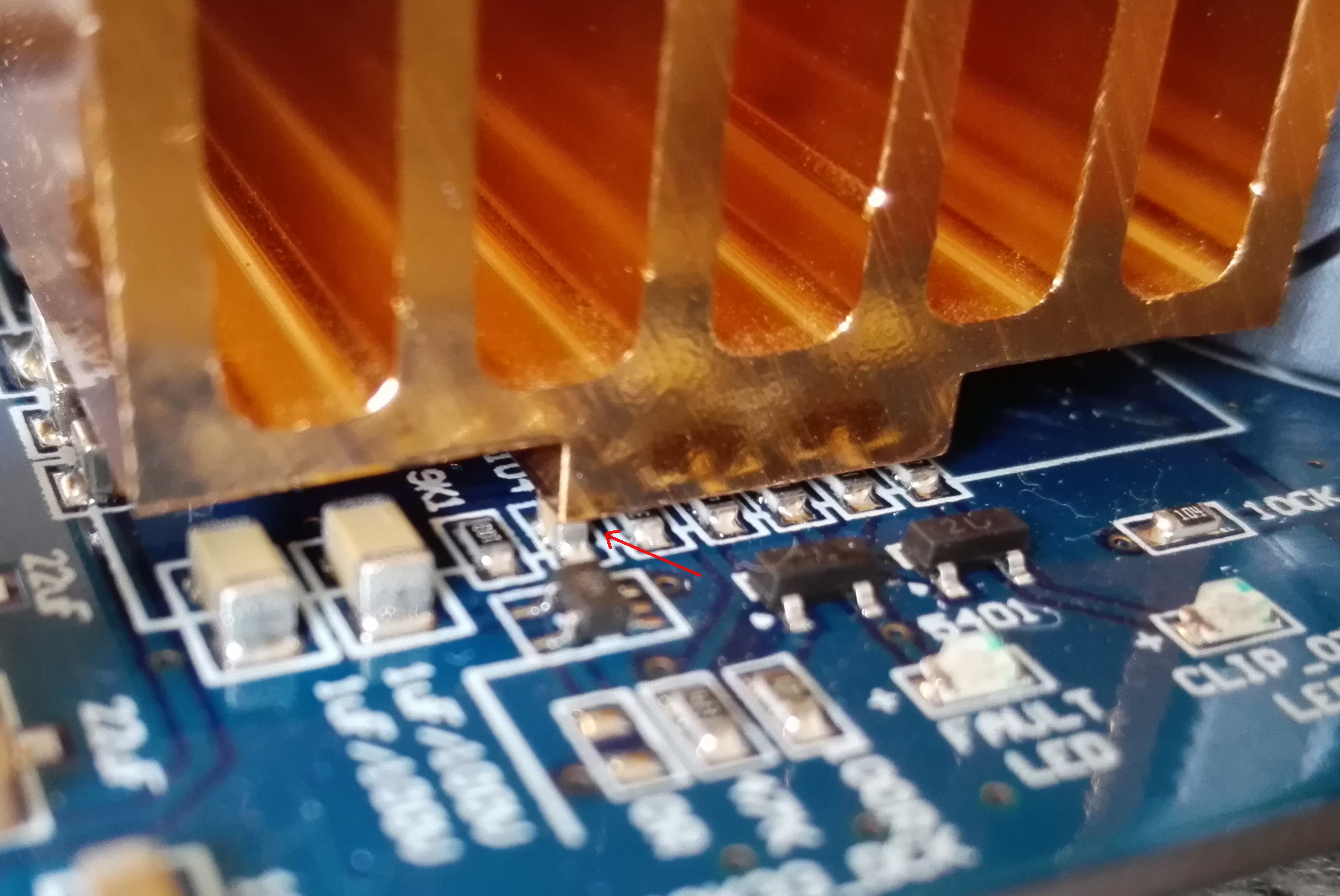

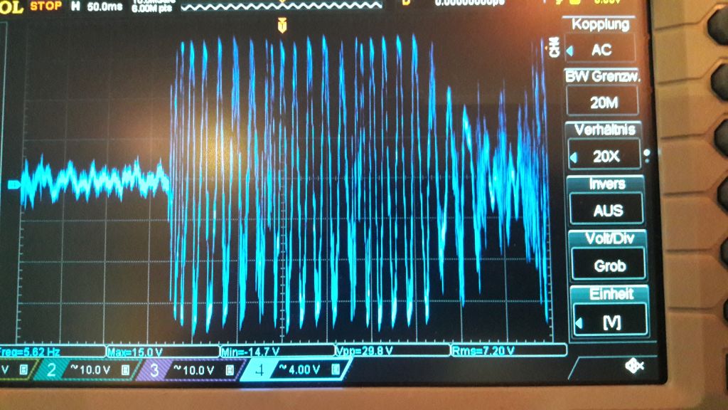

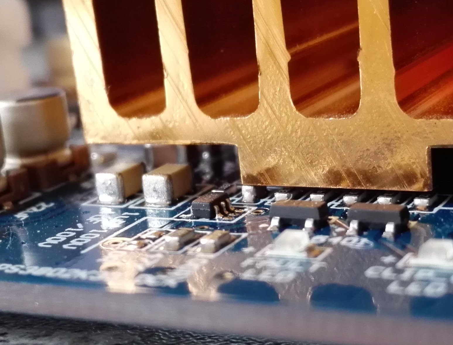

..switch off solved

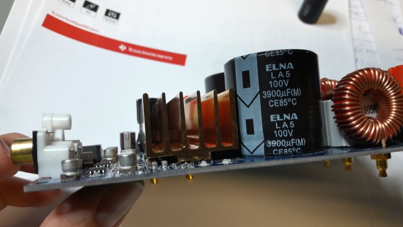

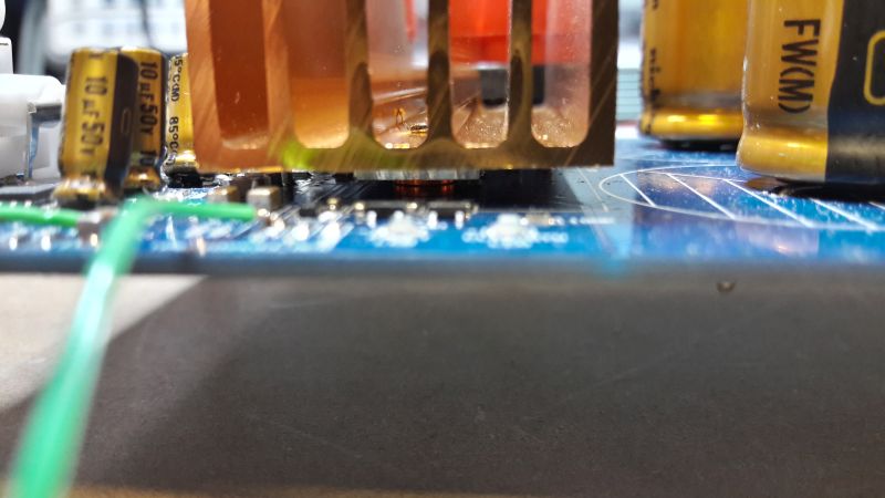

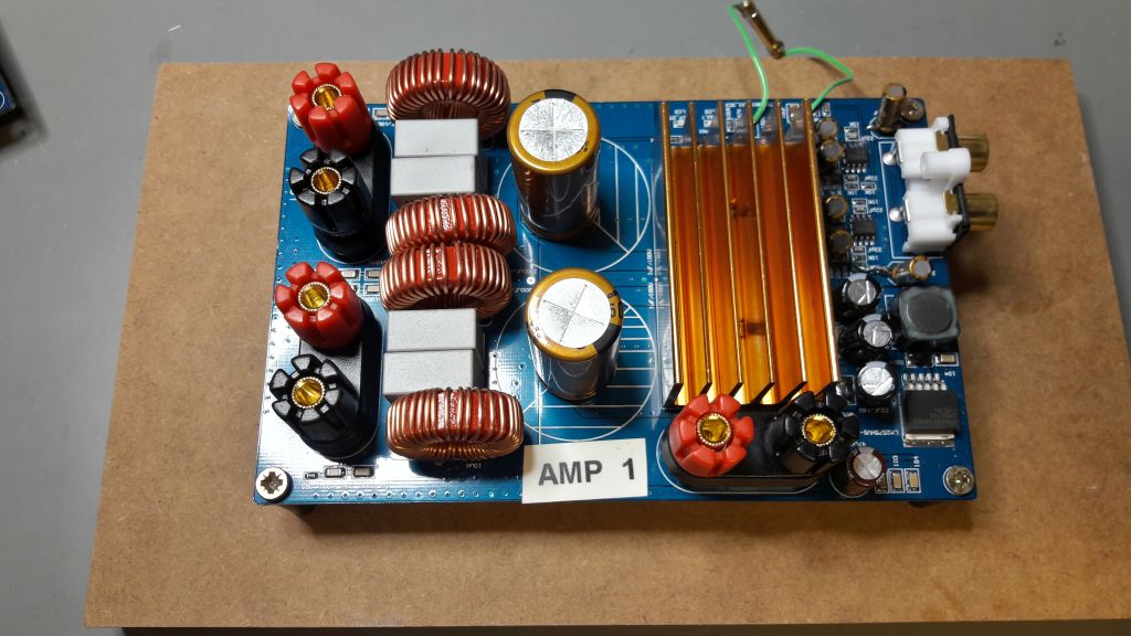

Hi
i look at the 3rd board and i want to look at the chip and therefore i see the different of the heat sink. i pick the heat sink and put it on amp one and i made the loud volume test again. so.... it was really loud and no switch off.
so in my suggestion the original old version of the board shorted something with the heat sink!!!!
pic 1 different heat sink old and new(cutted area)
pic 2 old heat sink -shortcut of smd components
pic 3 new heat sink final mounted
pic 4 measurement with scope differential
pic 5 amp mounted- so do I to listened to music

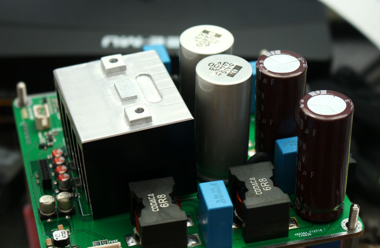

Proper heatsinking is like so:
Polished or milled down with small amount of thermal grease and some "downforce".
fantastic board. heat sink handmade? or better hand made with your cnc machine??
the caps (GPD) i noted last week - i really like it
