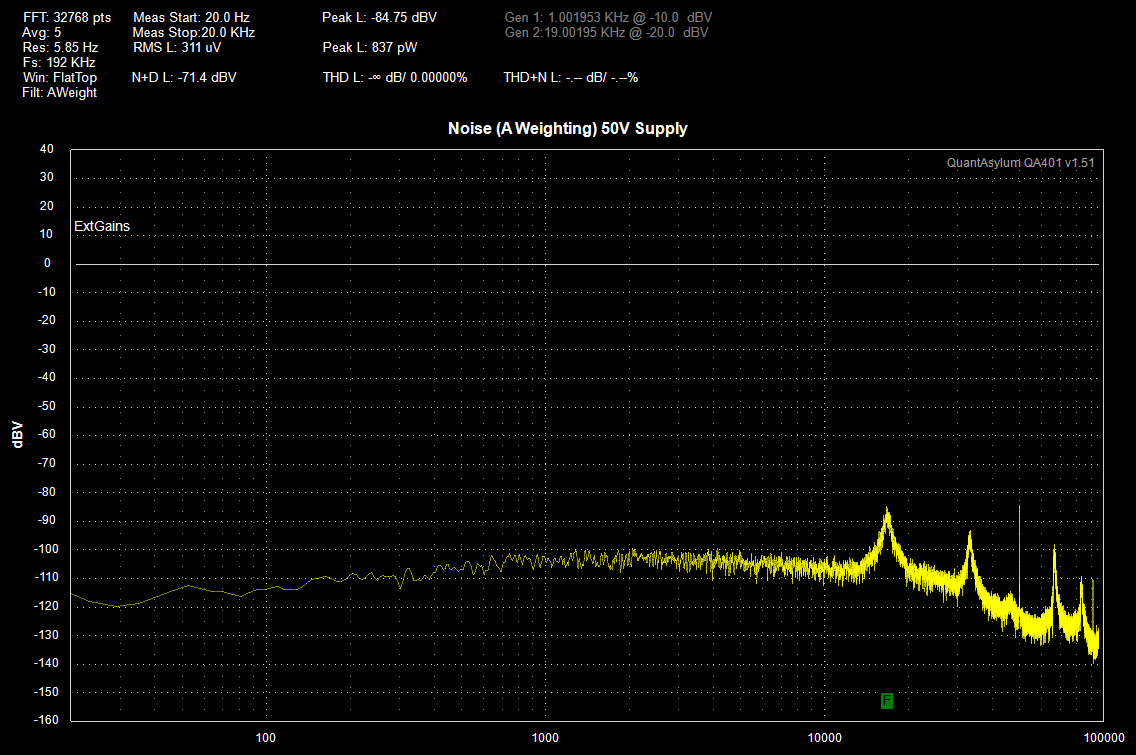

I've measured a black TPA3255 a few weeks back and it has some stability issues at higher voltages. Not sure if blue has the issue too. It appears to be a 15V DCDC converter (LM2575) in the upper left of the board. Hit it with cold spray and you'll see the spectrum shift and clean up.

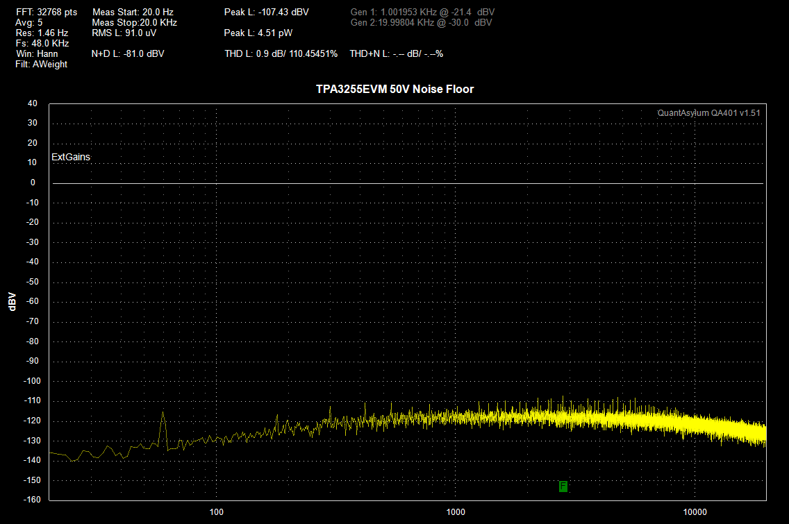

The first plot below is TI reference design. Noise floor is measured at 91uV, TI spec is 80uV. The second is black PCB design from Amazon. Noise is almost 4X higher. Note the noise at 1K is 10 dB higher than TI reference design.
So, yes, the supply of the no-name TPA3255 is plentiful and cheap, but the performance isn't anywhere near the TI reference design. Still, it's a lot of bang for the buck.

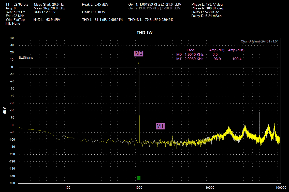

Did you measure that gain of the blue/black clone vs the TI EVM? If their gains differ, the noise floor figures cannot be compared directly.

Yes, good point, you are correct I should have noted.
I've attached the 1W measurements on each. On the clone you see -21.5 dBV in gives 6.45 dB out (28 dB gain).
On the TI you see -21.4 dBV in gives 5.96 dBV out (27.36 dB gain).
So, that's about 7% linear gain difference, which doesn't come close to explaining the noise discrepancy. The clone has left a lot on the table compared to what TI was able to achieve.

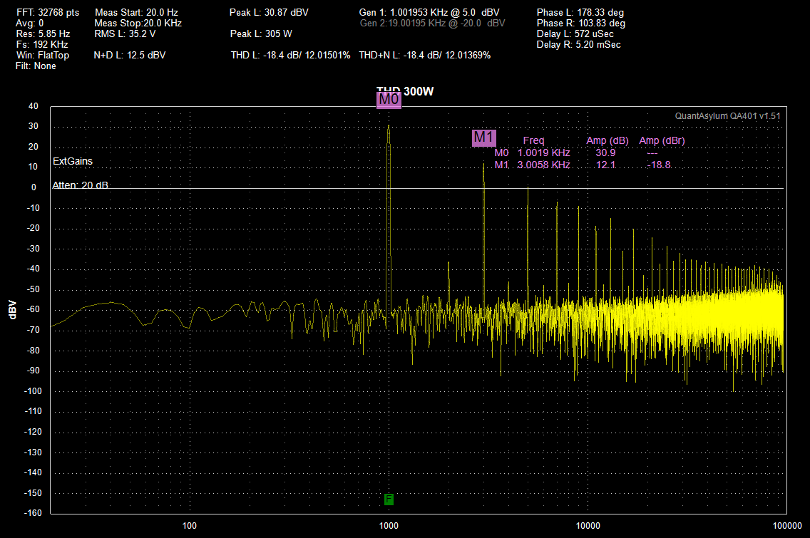

PS. I also attached the clone at 300W @ 50V. A little more rail here would have helped a lot. TI specs 315W and 51V and 10%. So, the clone is doing just fine on max power. This is a killer part TI has produced.

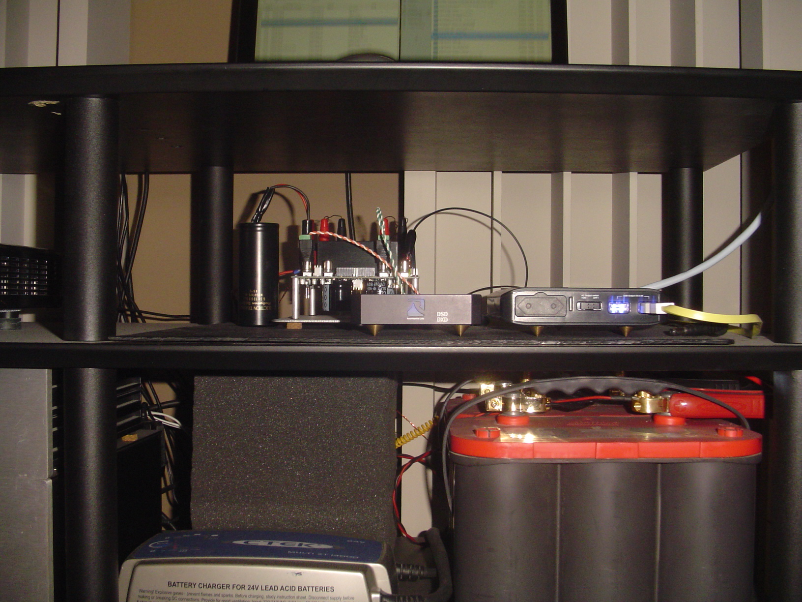

Gentlemen,
I received a mail from Texas about the 50% rebate for their EVM. Since I read the first communication about this TPA3255 years ago, with this price I decided to go for it.
Because on other projects I use batteries, I am thinking to use 50.4V 20A battery to power the unit.
With a huge capacity on the battery (able to 10C in continuous = 200A and 20C for few seconds) I imagine it will be ok for the EVM.
In this thread I've read you use mainly power unit from plug to power it. Do you think battery is a good way to power the EVM?

Well well, batteries have voltage dropping down under discharge. With big capacity I hope under home listening conditions voltage will stay the same.

I like the idea of batteries myself, and I a converted 18V Makita drill battery(+-14.8V) for my phono preamp.(I hope to only charge it once a year). But I think you need a very low resistance battery for the tpa3255 to avoid massive voltage drop! I hope your battery is a lipo with a really good C rating, or else a mediocre psu will be better at high loads. I have often been surprised by the voltage drops from a 100Ah car lead battery delivering 5-600W. Would be interesting if you could do a comparison with battery vs pwm power supply!
I will mesure the battery drop. I use LiPo 20000mAh with 10C continuous. I use 2 battery in 6S in serial to get a pack in 12S configuration.
