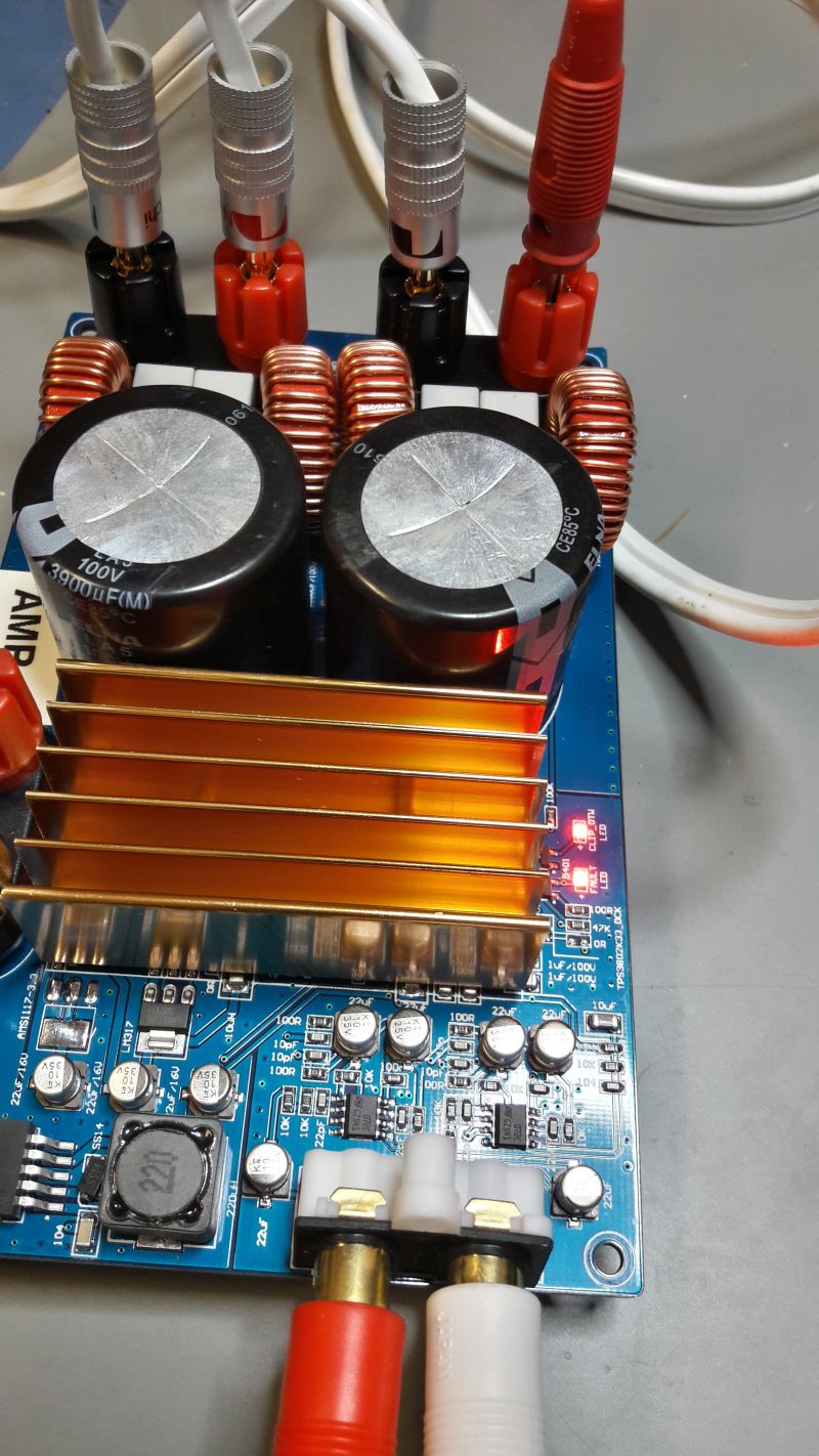

i will check the TPA 3255 china bought at amazon /nobsound (51euro) blue pcb.....different to black????

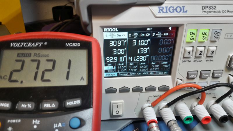

here some pics .....my first impression. load test at 8 0hms with a power supply of 31V/6A. 1khz test on both channels
1 Vrms in ...out is 22,7V.......so.....Gain is about 27dB....strong ...:D it is pushing about 2,72Ampere .....61 watts into 8 ohms easy...
power consumption is 133Watt
idle 31V...4,3WATT
the default :
ocp led and the clipping led is still lightning? that s seams ok...i got a signal . but what happens if i get a fault?--LED off or blinking.????

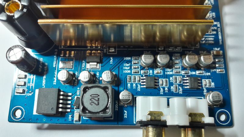

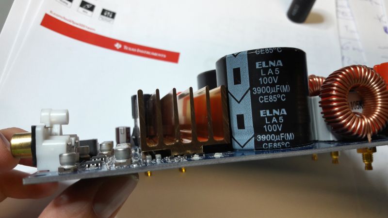

input caps...
According to sybic modifications i start with the input caps:
i have 2 board so i changed one board.
the caps around the input (6x ) are 10µ but @ 10kHz test i got 6,5µ and ESR 7,5 ohms, @ 100khZ test i got 2,2µF and ESR 6,78 ohms:mad:...i trough this out and put 6x UFG1H100MDM = 10µF/50V in.
near the regulator i put 3 x 220µF/16V in...16YXM220MEFC8X11.5
the big caps i measured @ 100HZ 3680µF but ESR 0 ohms...i change it to what i had in my box = 3300µf /50V ....UFW1H332MHD
sound check compared to the original will be next step...
chris

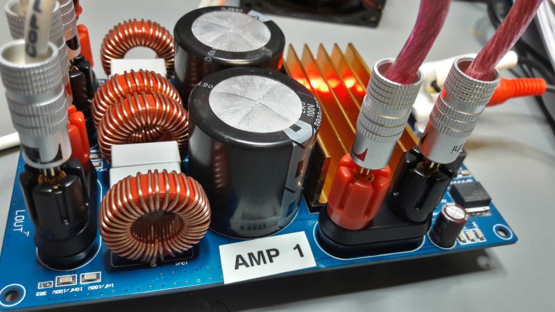

since 03:00 PM (actually its 08:36) the boards are running.
the big "elnas" could be fake...but i want to keep this for the amp 2. for better compare to the AMP 1.
amp 1 is actually playing very good.
First Whatch out the gain is really big...so do not forget to level down the volume at your source!! over tidal its at the lower level about 30-45
power on pop noise is not loud but its there.
power off pop is loud but not speaker killing...mybe with 36V PSU harder?? both LED are lightning but the amp is playing.:rolleyes:;)
connectors for PSU and Speakers are fine. heatsink is not big but thicker alu...with this i guess 2x "300W" are not realistic:rolleyes::D ...2x 300W---90% efficiency===> 2x 30 Watt:D
The mod AMP 1 is playing with my 24V PSu from the TPA3250 thread because i have nothing else to power up. TPA3250 somebody is listening?
the LRS 350-36V is ordered :D...delivery end of the month....
this amp 1 is GREAT ! its playing :
big stage, arrangement is very dark and the subsonic information is very nice. i got extra information which i never listen to some parts of my playlists.
very nice..:D...forget the original AMP board....this cap changes is a minimum modification

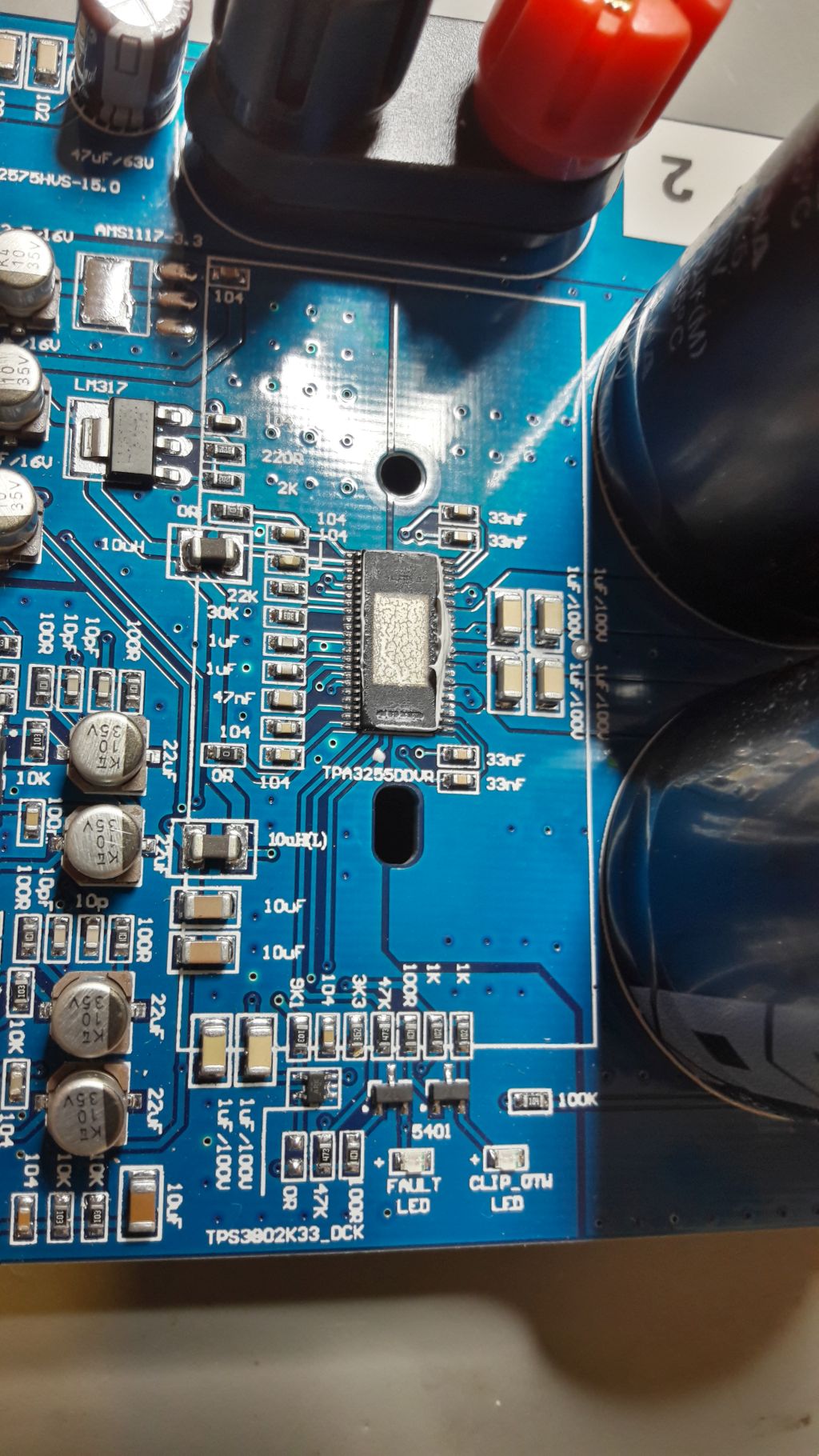

Hi i checked my LM317 at the both boards.
--> its not ok for the TPA3255 chip.
input voltage=15,24V , Output= 12,75 V....so the change is needed to 12V.
LM317 Voltage Calculator | REUK.co.uk
if R1 = 240 ohms (not measured yet)..... R2 should be 2064 Ohms.
chris
R1 is not 240ohms.... i measured now R1 and its 217 R...and the changed R2=2047R give me 13.00V :rolleyes:.......so R1 has to be change to 240
l should measure before i bought R2:rolleyes::p

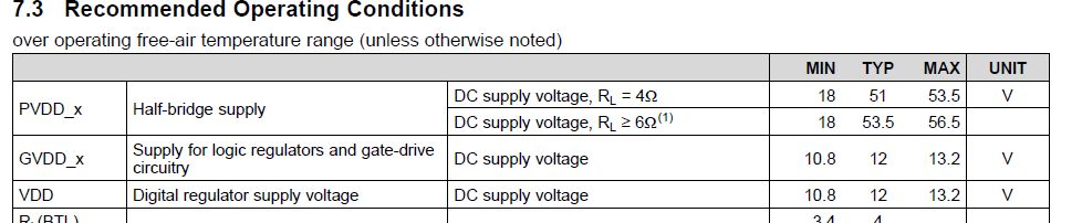

so the original was 12,75V and its near to the chips max DC voltage of 13,2V TI datasheet chapter 7.3

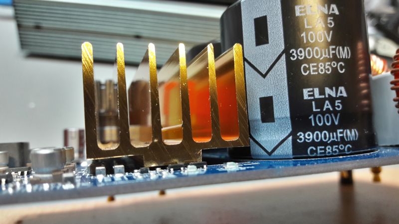

the TPA3255 is a chip with the thermal pad on the top. so for modification on this YJ board you should remove the original psu terminals to give a new bigger one. the dimension of the original heatsink is:
600m length x 31mm with x 21mm high
6 fins with about 1,5 mm thickness and 1,5mm ground plate…
typo its 60mm x 31mmx 21mm
