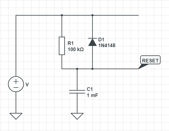

BTW any idea how it works?

It should be slow charge and fast discharge connected to RESET.
That wont help the transformer at all.
Suitable Inrush-Current-Limiter.

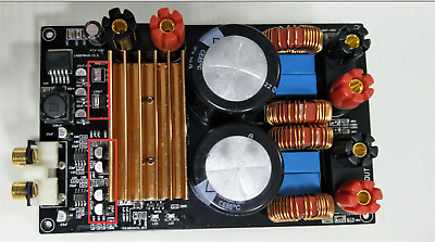

Hi. I've been reading about that new black pcb tpa3255 board on Ali.
What's the difference between the blue and black?
There seems to be some extra capacitors on the black board? I have no idea.
Found it, the black board having few extra component
