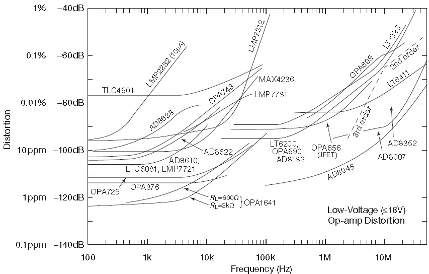

There is of course a place for discrete and I don't decry anyone's efforts in this regard. However, it is simply disingenuous to make sweeping generalizations that discrete is better than Opamps, and specifically IC variants whether you want to talk measured or subjective performance.
There is a reason IC opamps were used in the LIGO instrumentation, why they are used in space probes, medical and industrial instrumentation, and why for professional audio they are the building block of choice: they are just so damn good.
Here are a couple of examples of kinds of information summarized in The Art of Electronics, 3rd Edition. As you can see, engineers may find some pretty interesting info.
