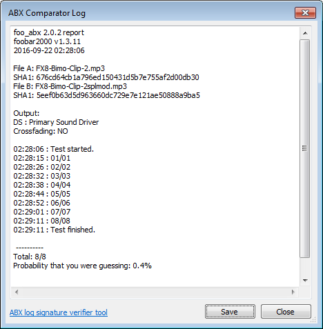

BTW, I just tried to create 2 files with 2dB difference so I could post here for anybody to try. I wanted to make sure that the process works flawlessly. Surprisingly, the file size is different... May be when the difference is too small, the file size doesn't change? (I will try again later with smaller dB difference).
😡 What confuse me was, why the SHA was the same if the file is different???!

The file hash should be different for the file you modified. If not, that suggests a bug in the software calculating the hash.

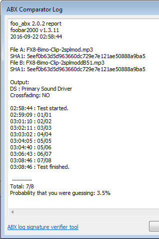

I just made a smaller DB difference to see if the file size and SHA changes or not. I made 0.51dB difference and the file size didn't change! So is the SHA! But they sound different in FoobarABX...
I haven't read your post, I couldn't focus on the ABX (my son was pulling my hand for the walk around routine) so the result was 7/8 but it should show that I heard differences.

I just checked your latest test files in WinMerge. They are identical, so there is no volume change, and SHA is the same. It's possible the mp3 encoder is normalizing the files to be the same, so your volume change is then cancelled out. You might need to leave a tiny part of the file, maybe the first measure at the beginning, the same high volume, then reduce the volume of the rest of the song by some small amount, and then encode to mp3. The encoder can't normalize the whole thing up then.
Of just use wav files, which you have more control over.
But the file-size and SHA changed when I made a file with not-too small differences? I didn't really pay attention to the file size, but during ABX I can perceive a perfect correlation between dB difference and ABX difficulty as well as subjective feeling about their difference...
