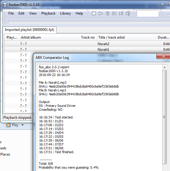

May be I'm wrong, the problem is I don't know where...
The two files (Norah1.asc and Norah2.asc) I renamed into Norah1.mp3 and Norah2.mp3 and put them into FoobarABX and here is the result...
May be I don't understand if the software is tricking me... 😡

Look at the clip in an editor like GoldWave - the aliasing is terrible. You're going to have to have a significant change before there is any real difference. This is the problem with digital, and specifically MP3's. This is another issue for another debate, but I specifically avoid digital control on my amplifiers, not because I can't do it, but because I don't want another digital processor in the chain. I try to keep only my source digital, and everything else analogue from there.
I converted both files to wav format using Reaper. Using WinMerge to compare, the wav files do differ, but only in the creation date time stamps in the header section. The PCM data is the same. Therefore it appears the mp3 decoder is deterministic.
If the two files sound different in Foobar, it must be making them sound different. Wouldn't be the first time software had bugs.

Well, I don't know what's going on there.
How about the third file I posted (Norah.asc). Is that similar too? If so, rename it into Norah.mp3 and play it through any software. You should be able to perceive the difference because it is 7.8dB down.
Yes, but not "different" in a level where anyone can perceive it.
Today I downloaded Audacity so I can create a file with 0.1dB difference. I don't know if Audacity is capable of doing that. Online software can only do 0.3dB difference. I will have to learn how to use the Audacity first... I installed it in office computer (right now I'm at home).
