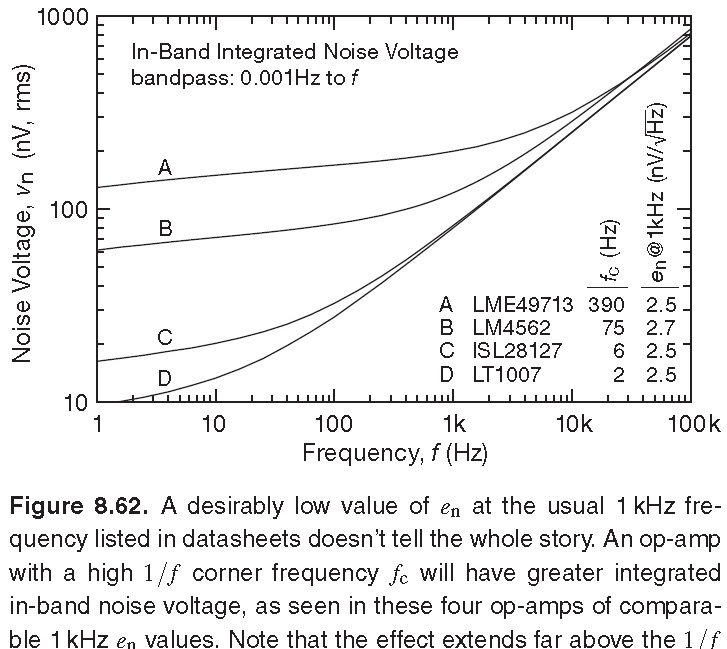

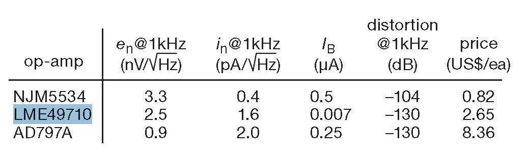

I found something else without looking too hard. See images.

Problem with bipolar IP OPA's is the noise current. I think about the best you can do with the average MM cart is 77-79 dB S/N because of that. A good JFET will get you <1nV/rtHz and negligible noise current. Parallel a few and you are in 85 dB ref 3mV with a real world cart and with the inputs shorted (Stereophile's preferred test method) you are at 88-90 dB.

If your eyes are on performance first and circuit aesthetic last, modern audio opamps are the go-to for so many locations. One moves away from them (and/or adapts their use into a greater whole) when the circuit demands so. Goal directed design. 🙂

Hoping that someone has something substantive to bring to the table on this apparent audible difference between supposedly vanishingly low distortion opamps. As in, why should the AD797 sound any different than the LME49710, isn't the distortion essentially below the noise floor?? Etc.
The kicker here is that the opamp (yet unamed) that sounded by far the best is not the one that has (on the surface) the "best" specs - certainly not lowest noise floor nor lowest distortion spec.
Groner's extensive tests, when I recently looked at them, I was unable to discern WHY or WHAT was different that could be used as a predictor. Frustrating and confounding. (at least two of the opamps I used were present in his tests)

Forget about flawed conjectures and hypotheticals... you're an expert, what in your view would cause a properly used AD797 to sound different (audibly so) than an LME49710 (or any other suitably high performing opamp of your choice)? Assume that they are used "properly".
