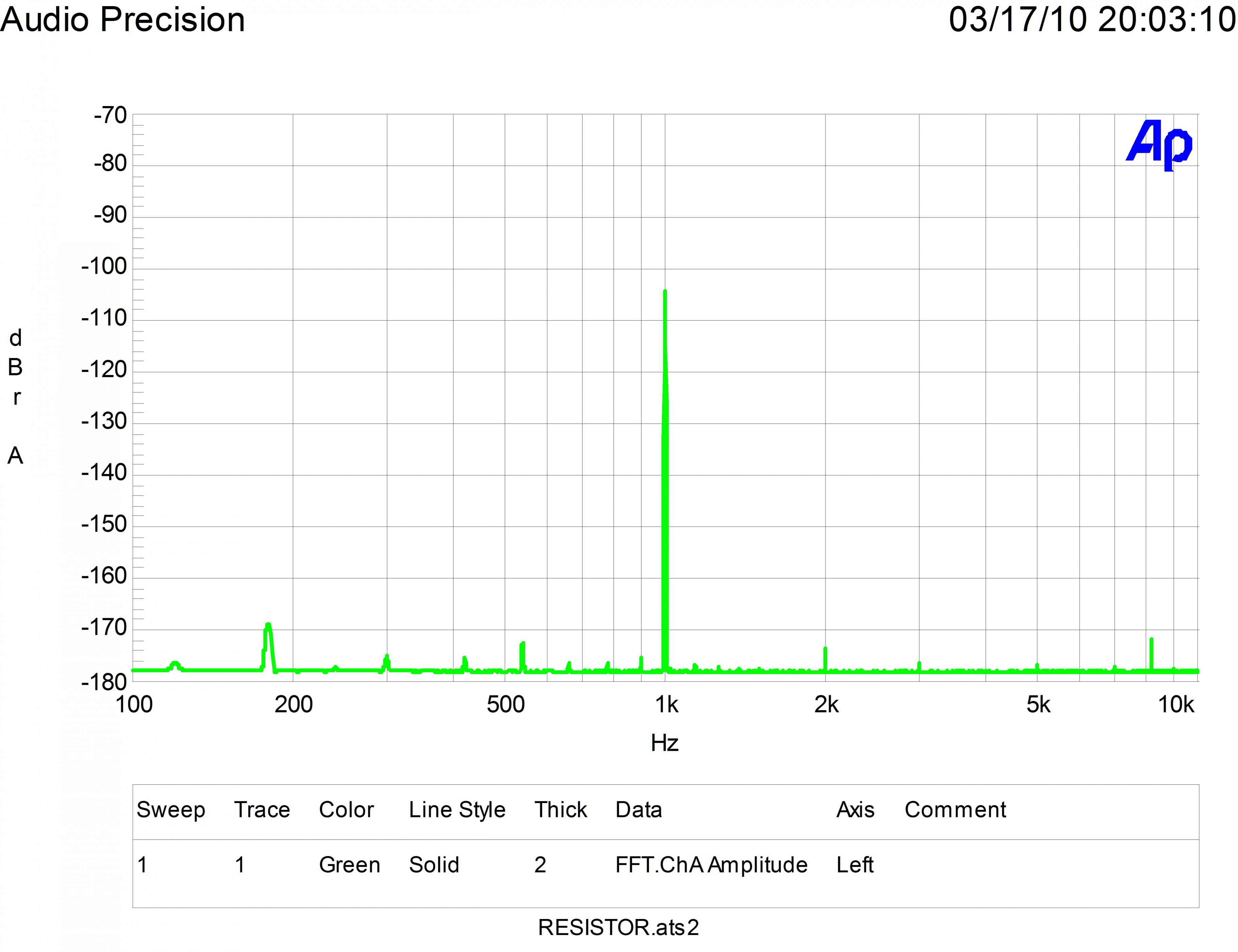

Attached are my distortion plots for a not very good carbon film resistor, a decent carbon composition resistor (but not the best), a decent metal film and a very good metal film resistor. 1,000 hertz is the test signal frequency as per my article in Linear Audio Vol. 1 It is nulled as best it can be for each resistor type. If the ability to null were perfect there would be no level. The leftover amplitude is from a bit of drift during the test interval. Base spreading is due to noise.
Can you share the supplier for this resistor?
I suppose impurities cause the others to behave as non linear resistors.
You mean a CC resistor can determine how it is being used in a circuit, and behave differently? It somehow senses things other than its own terminal voltage difference and current flow? I am impressed: that is Module 1 in the Maxwell Demon Training Manual already covered.morinix said:They also behave differently in series than as terminators.
I'm not sure you understand. He was not making breakfast; he was measuring how pure is the sugar preferred by some people, by a method which does not require perfect sugar as a reference.Just use ONE spoon of sugar on your cereal. It will taste good that way.
yes, especially metal films but carbon can too.
ie MOVs , graphite etc.
small impurities and or oxides change linearity.
no demons. its an interesting subject.
it really gets fun if Tunneling or superconductive.

As to the resistor question, if you hold your mouse over the image it will bring up the label. The good one is a Dale RN65.
But I think the axis of the world has tilted. DF and I agreed on something. 🙂
The other issue is test equipment tests what it is designed to do. It is that hammer line, everything is a nail.
Look at the resistor FFT's. The obvious is the distortion amplitude. Next is the base spreading. Then there is the fundamental null depth.
As with the chimp in the cage tale, what else is being shown?
