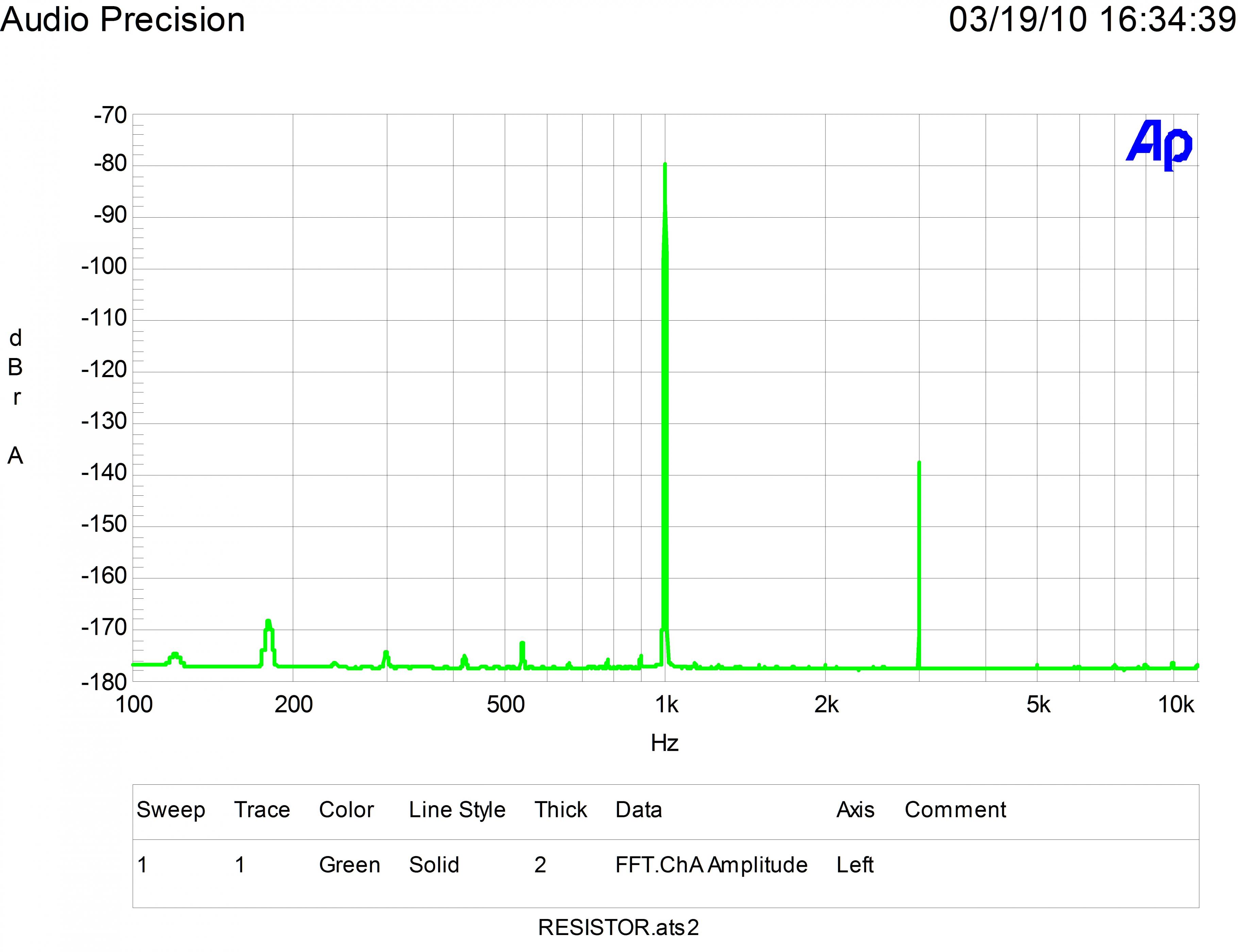

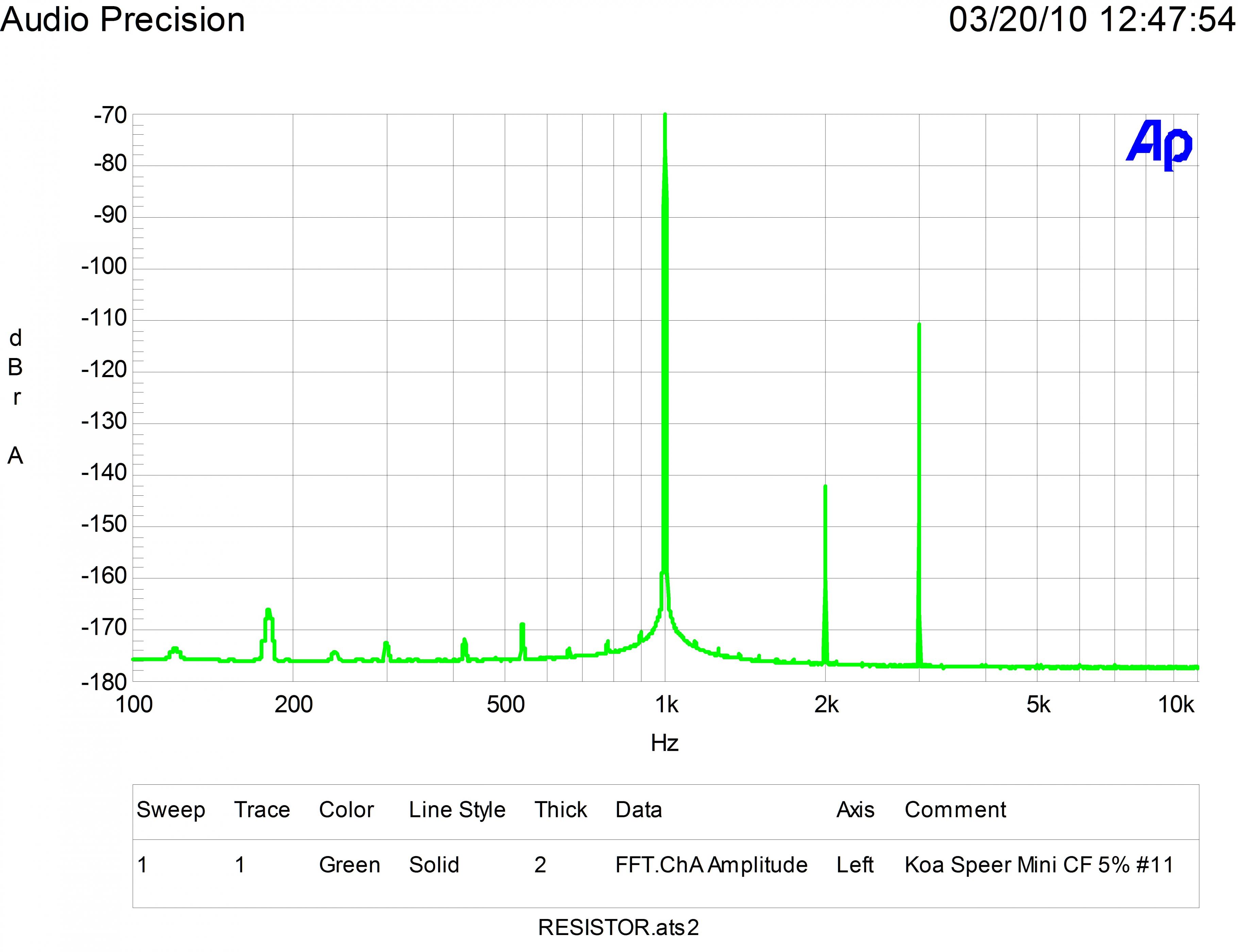

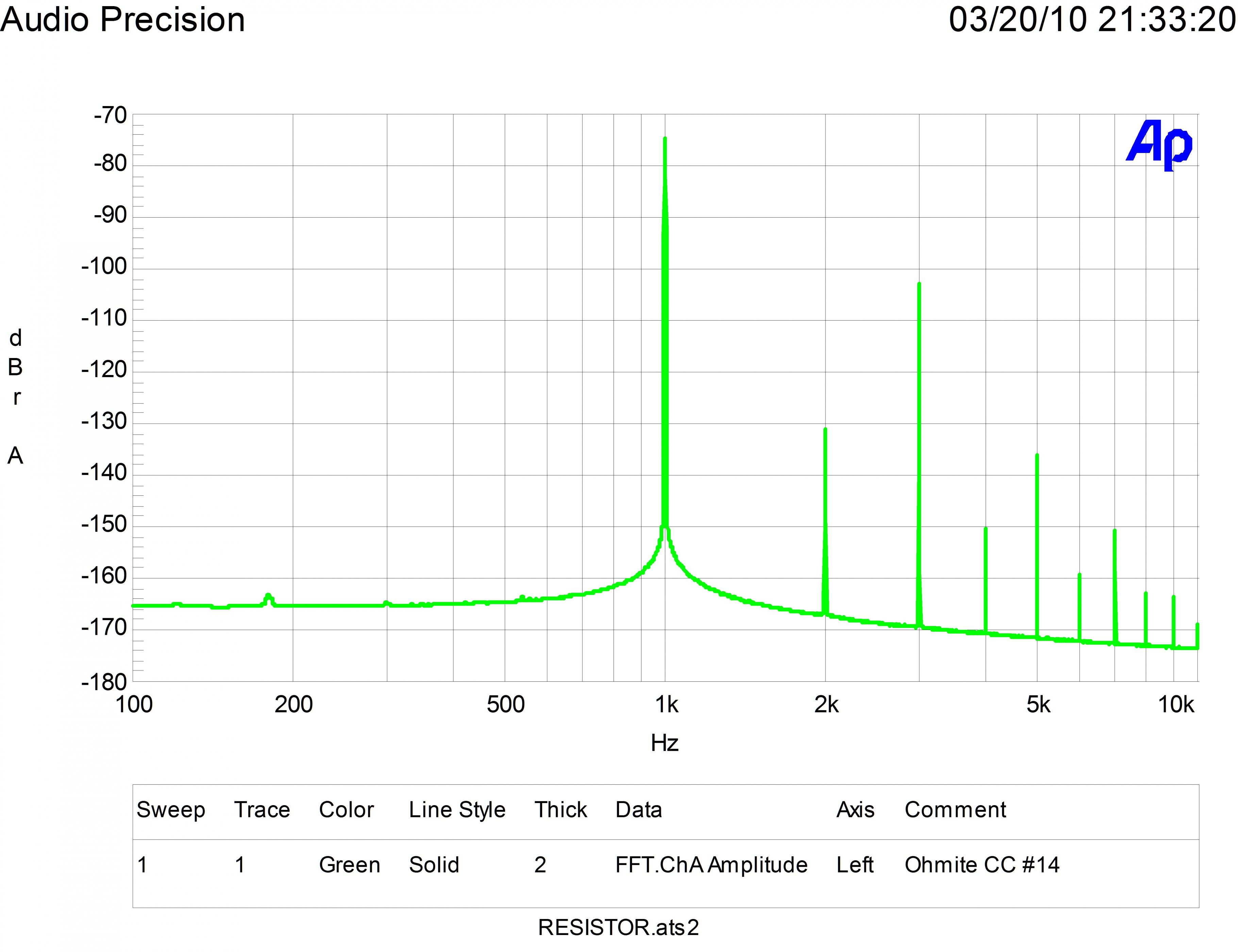

Attached are my distortion plots for a not very good carbon film resistor, a decent carbon composition resistor (but not the best), a decent metal film and a very good metal film resistor. 1,000 hertz is the test signal frequency as per my article in Linear Audio Vol. 1 It is nulled as best it can be for each resistor type. If the ability to null were perfect there would be no level. The leftover amplitude is from a bit of drift during the test interval. Base spreading is due to noise.

The worst looks like -100dB? You said perceptible. Level, remember the same claims are being made when used as a phono termination?

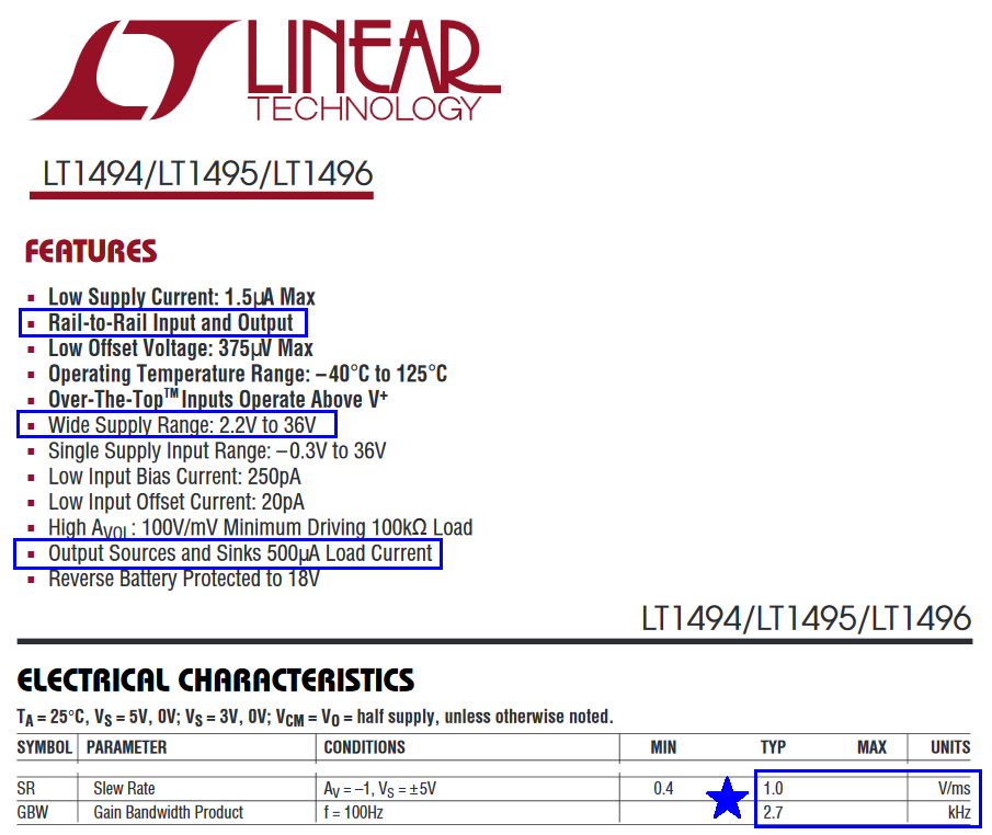

Obviously a very slow but very low supply current sensor buffer/opamp.
But there's something funny on this datasheet; 2.7kHz GBW and 1000V/us slew rate?
Or do they mean 1V/ms = 1V/micro-second? Sloppy.
Jan
1000V/us slew rate?
I think they were misled by ms instead of us.
Yes that must be it; I edited while you posted. Sorry 🙂

Pretty sure it's one volt per millisecond a/k/a 0.001 volts per microsecond. The datasheet's scope photo of large signal step response appears to show the output slewing from 0V to +5V in 5 milliseconds. And the parametric search table on Linear Technology's website says the slew rate is 0.001V/microsecond, image below.
Hard to make a passable phono stage out of the LT1494.

Series? Terminating? Feedback loop? What are we looking at here?Attached are my distortion plots for a not very good carbon film resistor, a decent carbon composition resistor (but not the best), a decent metal film and a very good metal film resistor. 1,000 hertz is the test signal frequency as per my article in Linear Audio Vol. 1 It is nulled as best it can be for each resistor type. If the ability to null were perfect there would be no level. The leftover amplitude is from a bit of drift during the test interval. Base spreading is due to noise.
And define "best" when applied to the CC res. NOS CC's behave differently than currently made ones.
All shown tested the same 1-4/4-1 bridge method at 1/4 power. Raise the power, lower the frequency and the distortion rises. The scale is the same for all shown plots. It represents the relative results of each resistor type. It is not calibrated as to the distortion that would result in use as a voltage divider feedback resistor.

In use the worst resistor measured (Not shown) would give -19 dB third harmonic among the others re 1/4W at 100 hertz on that scale. However unless one were looking for coloration that bad of a resistor would stand out.
As to the claims that the differences are heard when used as a phono termination, the claims did match the measured results! However the mechanism or what is being perceived is a reasonable open question. I do have some ideas and am building test equipment that may provide some insight. Also note the differences in the plots besides just harmonic levels!
Best is lowest distortion. We are looking at the output of a ten resistor bridge in the 4/1 1/4 configuration. Two in series paralleled with a second series set for an equal value resistor but at 1/2 the voltage resulting in lower effects. One quad in the upper left to a single lower and the reverse for the other side of the bridge. Well covered way back in the blowtorch rope. (Too long to be a thread anymore.)
If you hold you mouse over the plot it identifies the resistor. All were current production at the time.

That would seem quantifiable, also there's the problem that the distortion goes down with increasing frequency (or at least you said so above). We could just ask Robert at what percentage of dissipation rating are the resistors in question being used. The last batch of high value NOS CC's I got were 80% high in value probably due to storage, another issue.
