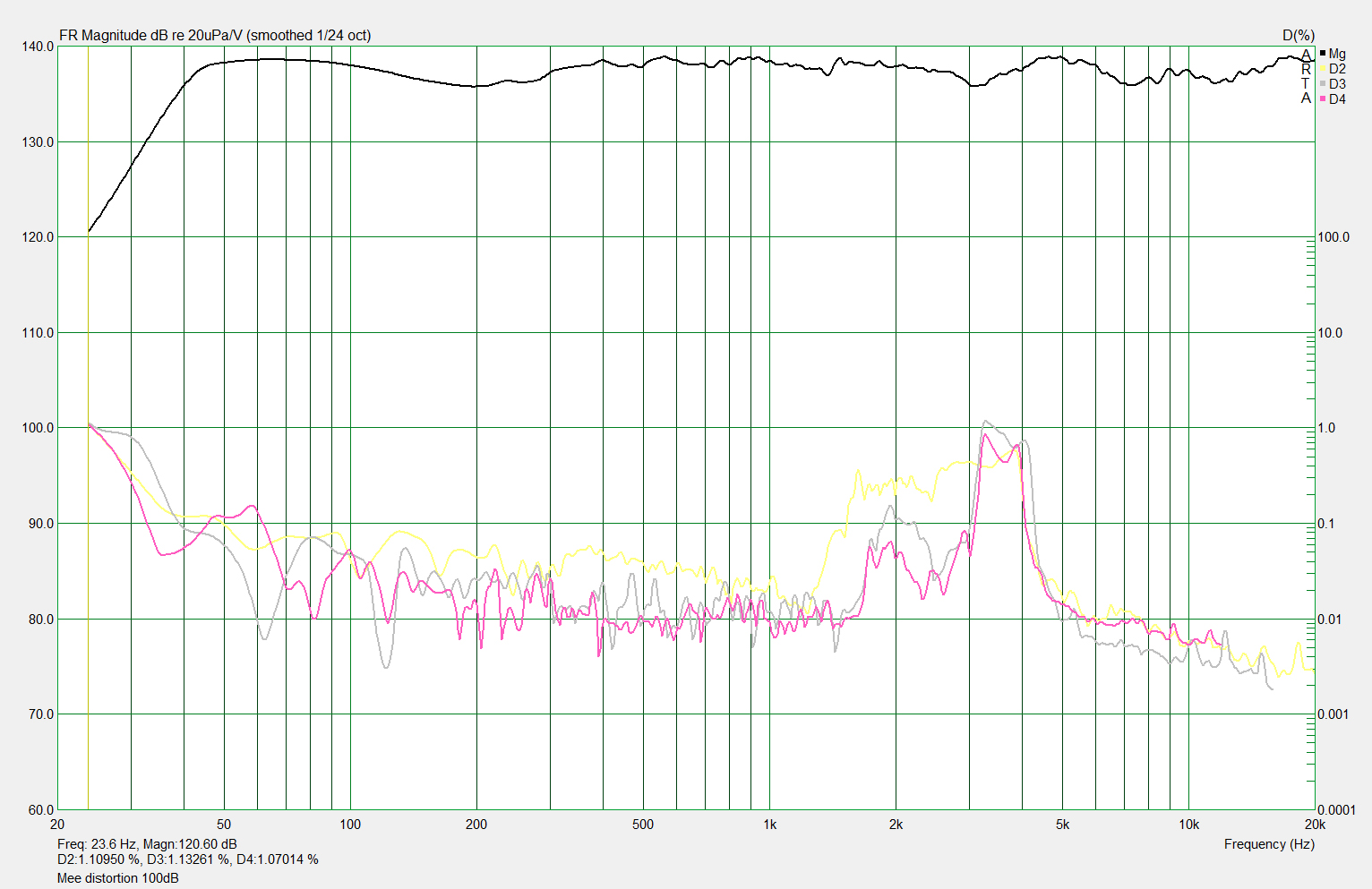

About my speakers: I have some serious concerns about IP protection at the moment which I have to sort out first. Money is solidified human energy, and I want that returned with a modest but appropriate gain factor. Therefore, no picture of the speaker, but rather of a telling measurement: distortion @ 100 dB @ 1 m. That is a LOUD sweep, even in an anechoic chamber. (I have a promising candidate for a better tweeter, because there is something to be gained there, but look at distortion @ 40 Hz! Anybody knows of a medium sized speaker with better metrics?)

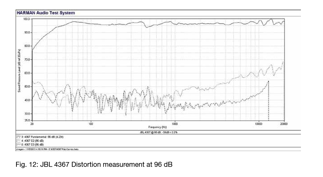

Just for bragging rights here the plot of a lesser speaker, over ten times heavier than mine:
Edit: What Harman has going for it is that they calibrate the scales on their measuring equipment better. SPL in my measurements were set by independent metering.
vacuphile, a discussion of speakers is for another thread.
