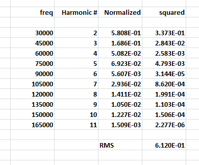

Mark what circuit/device is that, giving 58% THD??
Jan
Jan
It's simply the additional harmonics from driving a 15 kHz sinusoid through a perfect class-B OPS (as referenced to one rail).

Jan, "THD" is merely the label that LTSPICE attaches to a number it computes during Fourier analysis.Mark what circuit/device is that, giving 58% THD??
What the computed number is, in fact, is the RMS average of the harmonics (omitting the fundamental).
The printed value "61.206% THD" in post #2279, is just the RMS average. I copied harmonics 2 thru 11 into Excel to show the calculation, see below.
