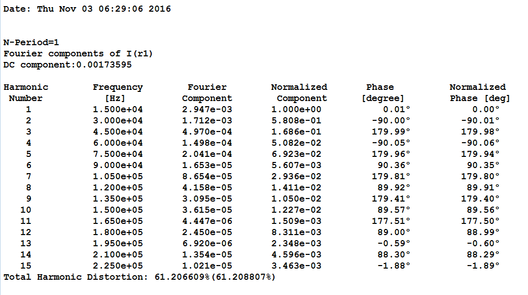

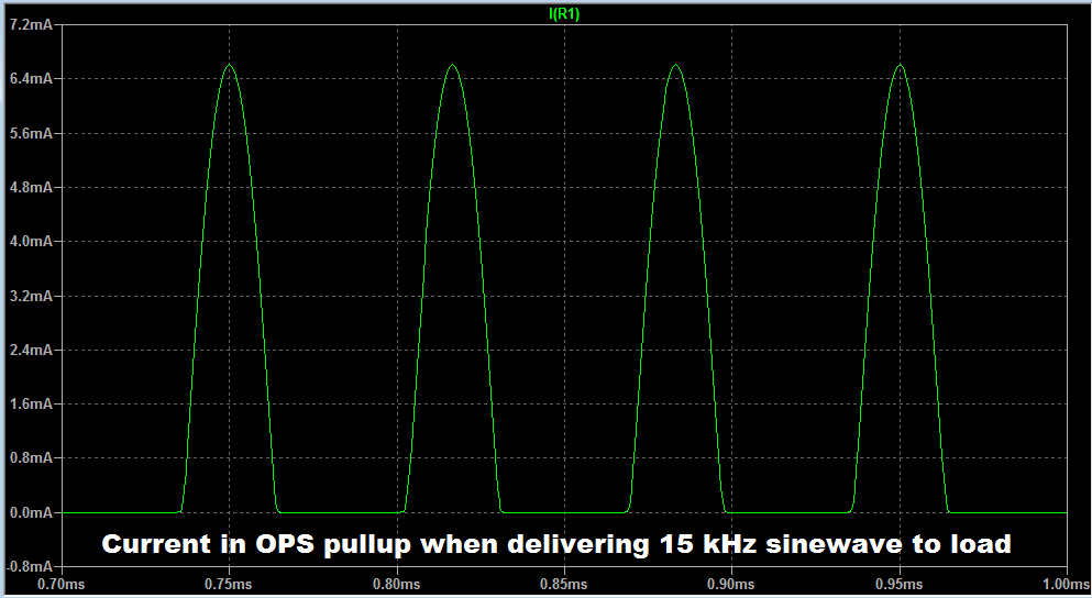

Want to bias your opamp further into class A? The LM334 is the easiest ticket. Tie V+ the op amp output. Tie V- to the negative rail. Tie the setting resistor from R to V-. Start with 1 or 2 milliamps.
Just wondering, why do people think this kind of setup is "bias into class A"? By any Class A definition, this is not true. The extra current has a completely different role than biasing the output stage in class A, it simply displaces half of the output stage transconductance so that the gm doubling distortions are reduced.
You are right. What it does is simply turn off one output device making it into a single-ended output stage, making the thing that provides the external current into the se load impedance. Assuming the extra curent is sized to the max required output curent. If it is less, it just displaces the xover away from zero output. Something like a small-signal version of Douglas Self''s Cross-over displacement patent.
In Morinix example above, the LM334 is the se output stage load. That is an improvement?

What [an external current source that pulls up the output pin] does is simply turn off one output device making it into a single-ended output stage, making the thing that provides the external current into the se load impedance. Assuming the extra curent is sized to the max required output curent. ... That is an improvement?
It eliminates crossover and thereby eliminates crossover distortion. It eliminates gm doubling in the output stage. It changes the supply current waveform from a half wave rectified sinusoid (with attendant high harmonics), into a full sinusoid riding atop a DC bias (with no extra harmonics).
Spectrum of "before" (without external current source) shown below, notice 58% 2nd harmonic at 30 kHz and 3% 7th harmonic at 105 kHz. How good is your power supply at 105 kHz? How good is your active circuitry's PSRR at 105 kHz?
