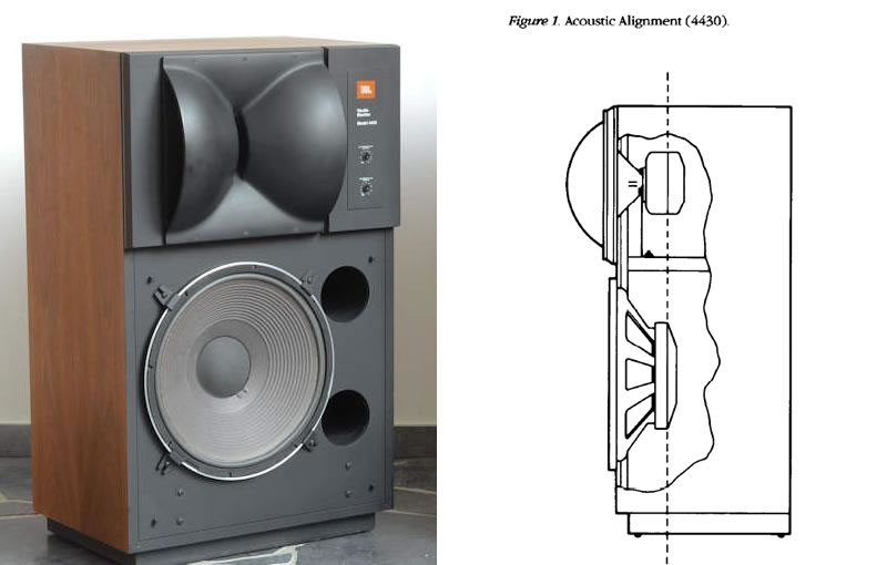

JBL 4430
The JBL4430 was very successful during it's time. When I was exploring the concept of time alignment, I chanced upon their brochure. What I saw left me confused. Even though they did not they claim the speaker was Time-Alignment, they showed a diagram that suggest Time-Alignment. The implication is since the acoustic centers of the two drivers are aligned vertically, therefore this is a time-aligned speaker. They even have a line at the end of the magnets to signify acoustic alignment.
I have a problem accepting this. Supposing the acoustic centers are actually aligned vertically, does that mean the sound from the woofer and the sound from the tweeter will reach the mic at the same time. I don't think so. Because the low pass filter at the woofer will introduce a delay. Same for the high pass filter at the tweeter. Worse still, the delays are in opposite directions. One lag, the other lead.
Am I right or wrong.

mark
I've given it some thought and I think you're right.
The inverted peak of the tweeter is about -50us. This is 0.05ms.
According to the Delay measurements, there is a tolerance of +-0.02ms. End to end would be 0.04ms. So, it is very possible that the impulse is showing what the delay measurements are not.
0.05ms works out to 17mm. One way is to use a 18mm mdf step for the woofer. This would be a bit difficult because I can't align the woofer center which means everything will change.
Another way is to use a passive delay network for the tweeter. This way, I won't have to move the woofer and tweeter.
The easiest route is of course to use a digital delay. Find one that can adjust at 0.01ms. Better still, at 0.001ms.
What say you.
