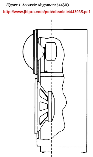

True. But JBL is one of the BIG BOYS. What are they trying to say by having that diagram.

There is no point talking about a diagram that basically says nothing.
But if you want to...
What do you think JBL wants to tell us?
These are the Impulse Responses of the woofer with the LP filter (yellow) and the tweeter with the HP filter (green). Both peaks coincide at the same point, does that mean the sound from the tweeter and the woofer reach the mic at the same time?

JBL 4430 Figure 1 Acoustic alignment: http://www.jblpro.com/pub/obsolete/443035.pdf

I am always puzzled, when I see a diagram, where driver magnets (motors) are aligned, like in the old JBL brochure. I have the belief that sound propagates from the driver diaphragm instead...

That picture seems pretty clear to me. The axis we see originating between horn and woofer is their "design axis". The half sphere shapes is the sound originating from the respective drivers. They also indicate the angles at which the horn and woofer go out of phase, both above and below the design axis.
This is what I've mentioned a couple of times, with a quick sketch. Where do you want your drivers to be "in phase". Usual answer: at the crossover frequency. My answer would be: at the crossover frequency as observed from the listening spot.
That's what JBL shows here, where that listening spot should be, at least along which axis to expect it. Their text speaks about a symmetrical 12 dB/oct crossover.
Choosing the design axis to be between horn and woofer ensures the direction of that design axis. If they would have picked "tweeter level" as the design axis things would look different in this picture. See the note why the design axis rises slightly.

that is exactly what I complained. In the original JBL paper the line goes through magnets/coils, not membranes that make sound.
This kind of pictures we see a lot and they are wrong, considering physical/acoustical time alignment! In most cases yes they will set acoustic centres well too, but the line is in wrong place anywy!
