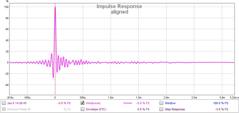

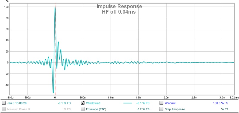

I really have to believe it's timing. Below are a couple of impulses from the same speaker setup. First is pretty well time aligned. Second has a deliberate mis-alignment of only 0.04ms.
Notice the undershoot before the main peak, and the second smaller peak past the main.
Michael, if you read this, it has me rethinking advising you so swap polarity along with a 1/2 cycle time alignment adjustment. You may just be out a wee bit.... as in this example....only measuring will tell :)
Oh, worth mentioning...the misalignment is on a HF unit crossing at 6300Hz...so not apples to apple by any means...but does show how sensitive impulse can be. Sorry I don't have any speakers that cross over more around 2800Hz.

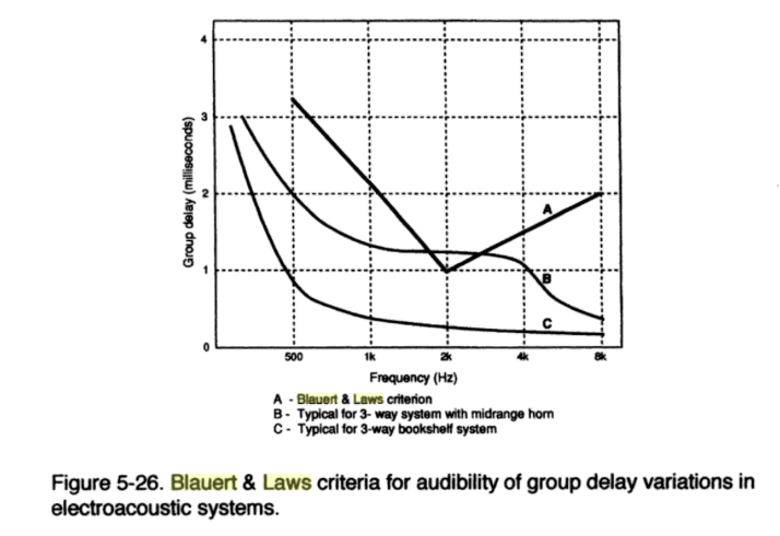

But the standard reference for the audibility threshold of time-screw-up is Blauert and Laws who report approximately the following thresholds for audibility:
Frequency Threshold of Audibility
8 kHz 2 msec
4 kHz 1.5 msec
2 kHz 1 msec
1 kHz 2 msec
500 Hz 3.2 sec
(quoted from John L. Murphy)
Looks like we are talking two full cycles of error at mid-range (720-degrees or 1000 milliseconds) before it can be detected in a lab setting. But hard to know how that works at low freq because hearing sometimes reckons in time and sometimes in cycles.
Isn't that relevant, factual, and objective information?

But the relevance does not escape John Eargle. Below are cuts from his foundational textbook (sorry, Google doesn't support text quotes only jpgs of the book).
I gather that Blauert and Laws worked carefully, rather like Toole. A panel was trained to be able hear time misalignments and then tested to see their threshold. See my previous post for the data. And even if they are off by, say, 50%, that's way grosser than crossover errors or all but the most stretched speaker box architecture.
(BTW, somewhere not long ago I posted my experience time aligning a many-feet-long Klipshorn followed by comments from others who had about the same experience with their corner horns.)
In plain terms, the type of synchrony and fine-tuning which seems to be the goal of this thread is monumentally finer than humans can hear. Lots of fun to discuss and I've learned a lot, but anybody in the cone-driver loudspeaker world has much bigger issues to fix first. Indeed, in the struggle to get synchrony right, other core response issues might be getting screwed up.

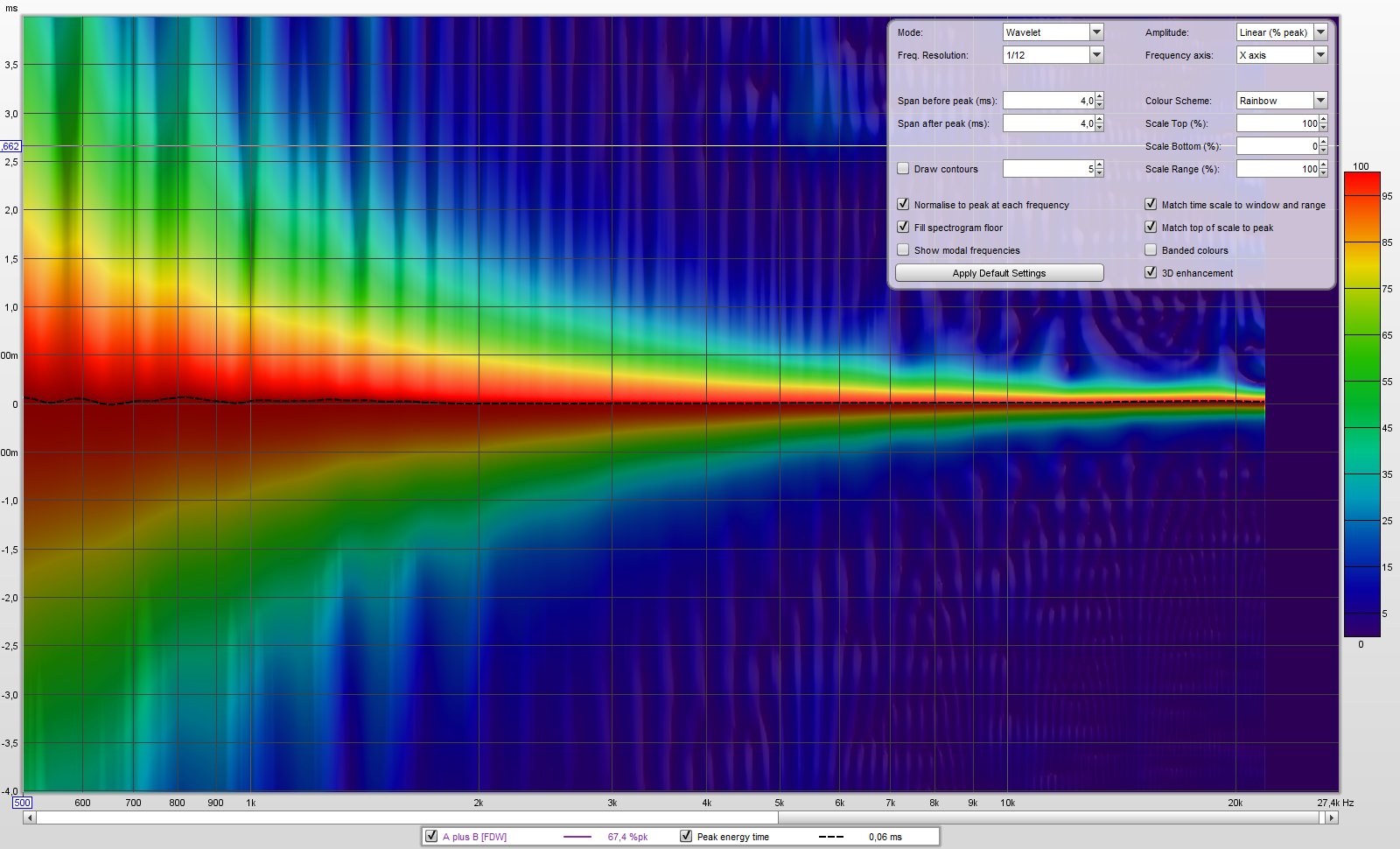

The Spectogram you show has too big of a window to get a clear look at our crossover. Personally, I like the new wavelet options in REW for that. John has added some options to make it come very close to what APL_TDA does.
APL_TDA is a very nice program to look at timing. REW now has a very similar feature, you could try that. It would be available in REW V5,19 Beta 7.
(I did not try or look to see if a newer version exists)
On the Spectogram tab, click Controls,
Choose Wavelet Mode, set Amplitude to Linear (% peak)
Resolution to 1/12 for now.
Span before peak: 4ms, Span after peak: 4 ms
Colour scheme: whatever you like (I use Rainbow)
Scale top 100%
Scale bottom 0%
You could check Normalise to peak at each frequency, as we use this for timing.
Also select Match time scale and Match top of scale and 3D enhancement.
Here's an example:
attachment.php
That's cheating, I don't have crossovers :D
That should allow us a closer look at the hand-over between tweeter and woofer.
