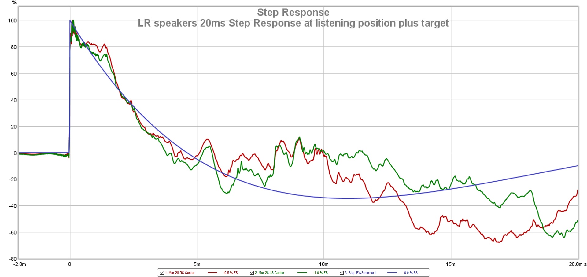

Let's have another look at that step response showing the first 20 ms, like in this example of my old 3-way's using digital XO and time aligned:
attachment.php
I have included the step response of an idealized or modelled speaker to show how closely the time alignment tracks at the listening position.
As a side note, these speakers also measure flat phase and group delay, not only at the LP, but also around a 6' x 2' grid area at the LP... Details in my sig.
PS. I am a huge fan of REW, but there are specialized software DSP tools that perform digital XO, time alignment, excess phase correction, reduce group delay, etc, that are very difficult or impossible to do in REW...

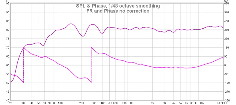

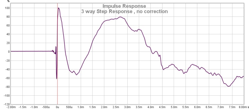

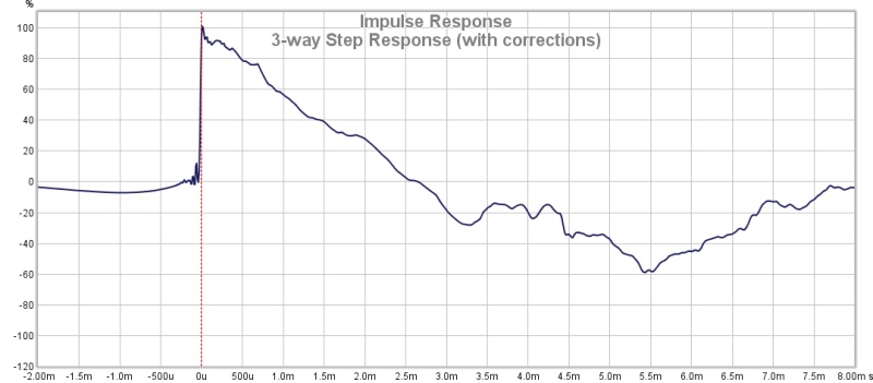

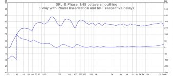

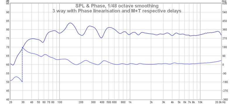

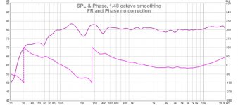

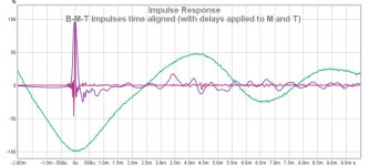

I happened to have a measurement on a 3-way passive, both raw and then with help of OpenDRC (for FIR phase correction) and DCX (purely for time delay only, otherwise run full open on all ways). Of course the corrected system is by design passive tri-amped. Shown one same channel, measured at the same LP at about 2,5 m.
Measured in-room, plenty of reflections visible on graphs.
Hi Draki
Thank you for your graphs. They look very impressive. The wonders of technology today.
May I ask what software you used for the measurements. I hope it's free. Poor man here. :eek:
Hi Draki
Not exactly one of the 1% either ......
Used HolmImpulse to establish the arrival time difference.
RePhase for the phase linearisation.
And as you see, REW for the attached measurements. All free.
