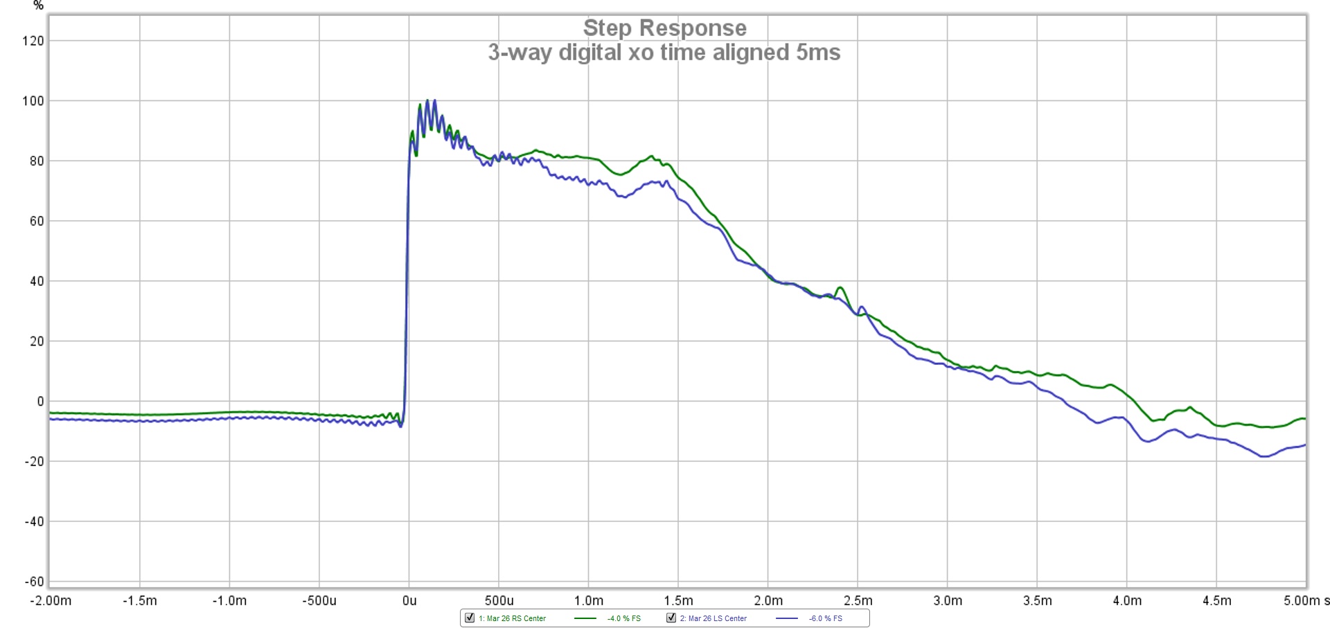

Since you have already made the measurement, why not show us the step response using the same horizontal scale as in post 82 - i.e. over 20 ms and post a larger image. This will definitively show time alignment or not...
Nope, the negative spike is indicating that the drivers are not time aligned as mentioned in post 82. I also use REW and in the same post there is no "pre-spike" on the time aligned step response I provided. The spike is from your measurement, not an artefact from REW...
Hope these help.

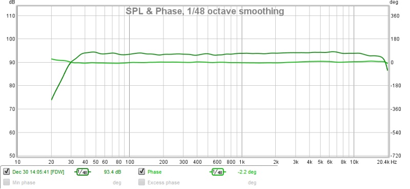

Anyway, I've been working on a new 12" mid range box, and made first measurements yesterday.
For the heck of it, and to demonstrate the power and efficacy of DSP, I set a sub and a HF/VHF box on the floor next to the new mid box in a small arc, pointing at a mic laying on the floor.
So it's a "don't kick anything or you'll lose alignment" 4-way 😀
consisting of an 18" sub, the 12" mid, and a coaxial compression driver.
Here's a quick and nasty DSP/FIR tuning with linear phase x-overs at 120Hz, 650Hz, and 6300Hz. FDW 6 windowing.
DSP/FIR makes things so easy IMO !

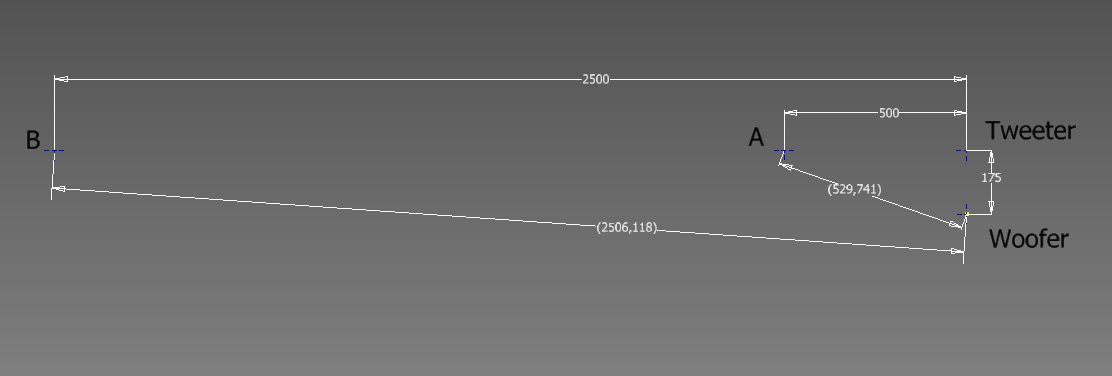

It is quite clean, how far from the actual speaker was this measurement taken? The reason to ask this question is simple, things change when we move further out. For example, if that measurement was taken at ~0.5 m, timing between tweeter and woofer would look way different at ~2.5 m.
See this simple sketch here:
Quite the difference between our ear and each driver at 0.5 m and the one at 2.5 m. Just a hypothetical example meant to think about. A sample, nothing more.
The relation between tweeter and woofer will change when moving further away. What we see in this hypothetical example is that if we time-align a speaker at close range, it might not hold up at distances further away.
The difference between our ear to woofer and our ear to tweeter is significant between these two positions. I'm not saying this is the case for you, just a general example showing why I deem it important to look what happens at actual listening distances. Not just at close range to get clear reflection free measurements. A difference of 23 mm in my above example is quite something for higher frequencies. Just another thing to be aware about.

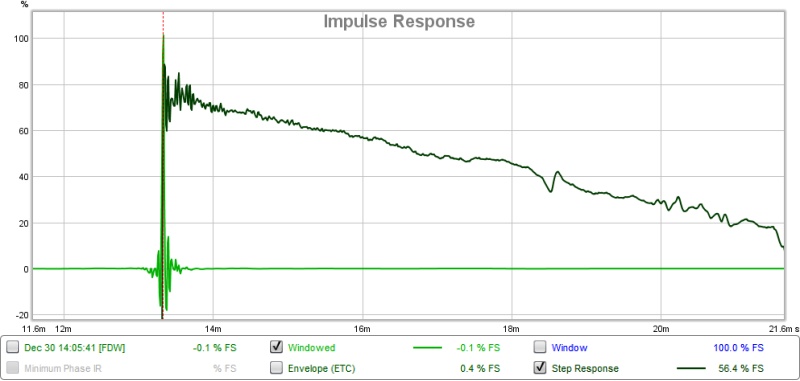

Every reflection and room disturbance will show up in the IR as well as the STEP response.
The IR plot, zoomed out to 20 ms you showed is a good example of this.
That plot shows a new upwards trend just after 3 ms. A tell tale sign of a reflection. These reflections will also change phase behaviour of our frequency curve.
(A reason for me to often use frequency dependent windows)
Moving trough the other tabs in REW we could find a lot more info about those reflections. That's where I found out where to place damping panels and even how thick I needed to make them to be of use.

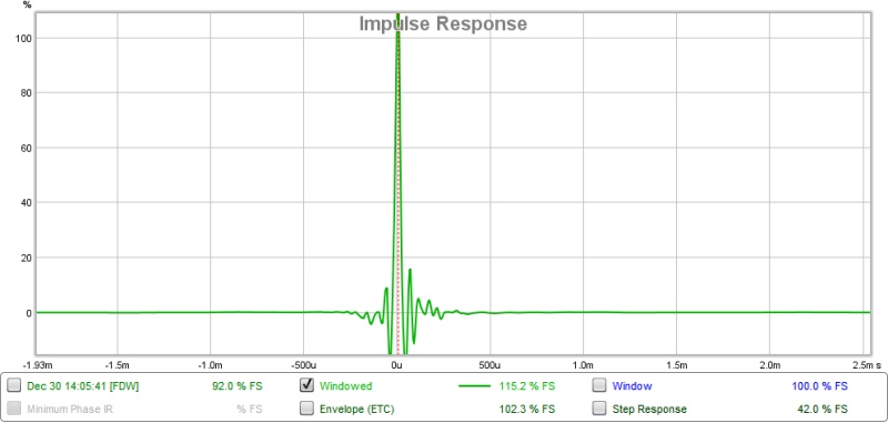

Just for reference I will post my IR/STEP, as taken at the listening spot:
This is the IR of both channels firing together at once, a Stereo result in the sweet spot.
While this clearly shows some restlessness in the IR at that spot (the low "grass" showing up at the bottom is indeed caused by reflections etc), you see no sudden or big changes in the flow and shape of the STEP. The overall shape of that STEP is determined by it's frequency response (declining from low frequency to high and band passed). The two cannot be separated. It's just another way of showing the same data. All of these graphs do tell us something. What I've been trying to do is relate them to my listening experience as best as I can.
This is with a frequency dependent window of ~6 cycles.
While I do use FIR filtering and EQ, this IR I show could not have been as clean or realized without good old fashioned damping panels at first reflection points. This brought down the reflections just far enough, not to influence the general shape of the STEP.

How about one more zoom of the step, e.g. like the first 5ms in the example below. This is at the listening position 10ft away:
