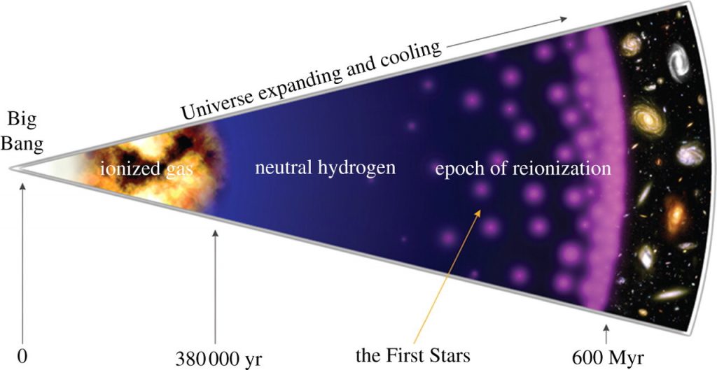

The reality lies in the fact that Webb will study the light from these earliest galaxies by spectrographic analysis, a method which is transparently obvious to the scientists, but opaque to the lay person.
After making ultra-deep near-infrared surveys of the Universe, Webb will follow up with low-resolution spectroscopy and mid-infrared photometry. To study the epoch of reionisation*, high resolution near-infrared spectroscopy will be undertaken.
(*The epoch of reionisation refers to the stage in the universe's development when most of the neutral hydrogen was reionised by the increasing radiation from the first massive stars.)

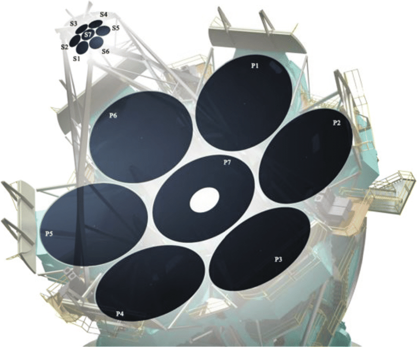

Anywhoo, here's my Engineering and Mathematical thoughts on the Giant Magellan Telescope. It's excellent. I did scratch my head on seven circular mirrors with seven concave (Gregorian) elements in the secondary.
But how it works is there are no diffraction spikes whatsoever. All that happens with 7 circular mirrors ground to within 1/20 th. of a wavelength is you increase light-gathering power over a single 8m mirror.

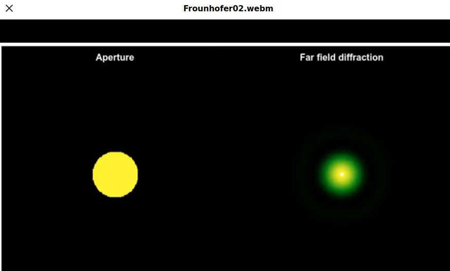

As long as you keep phase coherence, it all works nicely:

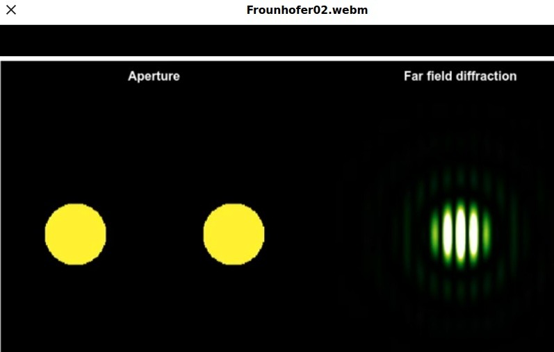

Now double the circular mirrors:

It's just Fraunhofer Diffraction:
https://en.wikipedia.org/wiki/Fraunhofer_diffraction

I read that the Giant Magellan Telescope is a Gregorian optical-infrared telescope, consisting of a parabolic main light-collecting mirror and a secondary mirror that reflects the image into the lens system. Like the primary mirror, the secondary mirror consists of seven segments, each of which receives the light from the corresponding primary mirror segment.
"Magic Mirrors" is what they're calling them! The glass of each secondary mirror segment is a mere 2 mm thick. Each of the 675 magnets bonded to the rear of each segment is actuated by a computer-driven electromagnetic. This arrangement allows the mirror’s surface to be deformed 2,000 times per second to clean up atmospheric distortions.
