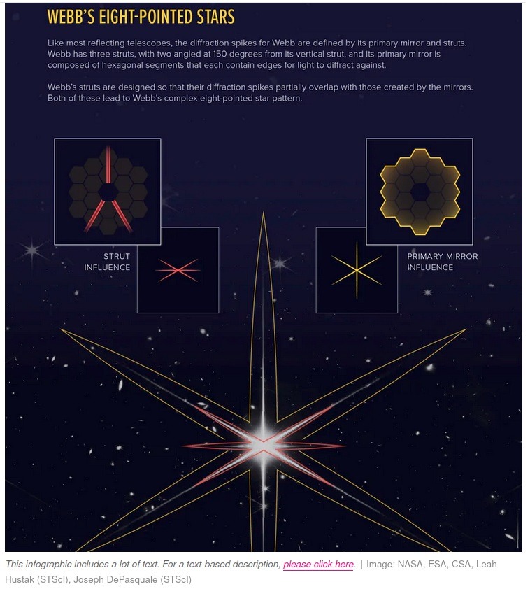

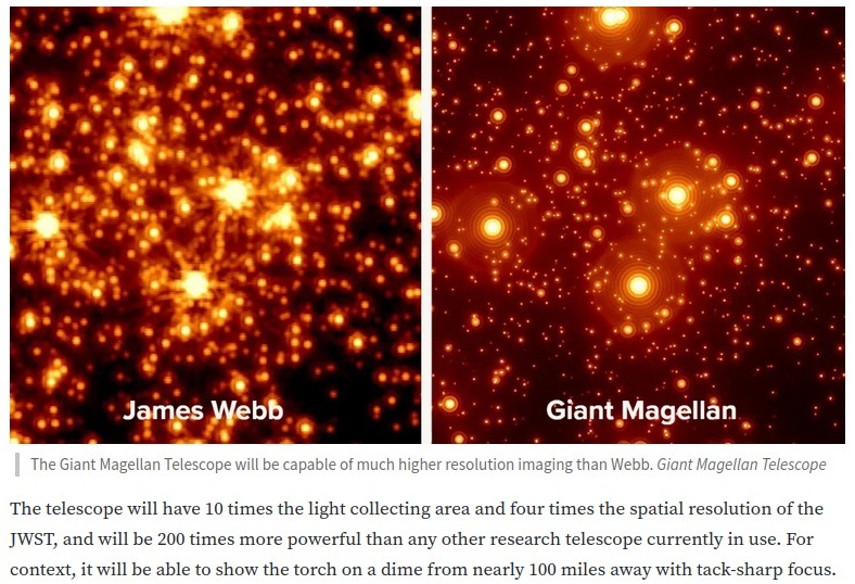

But I checked on JWST. The 8 pointed pattern is a combination of the 3 asymmetric support struts and AFAIK, the hexagonal outside shape of the mirror. They could have got hexagonal spikes with a different equilateral strut design.
https://www.theverge.com/23220109/james-webb-space-telescope-stars-diffraction-spike

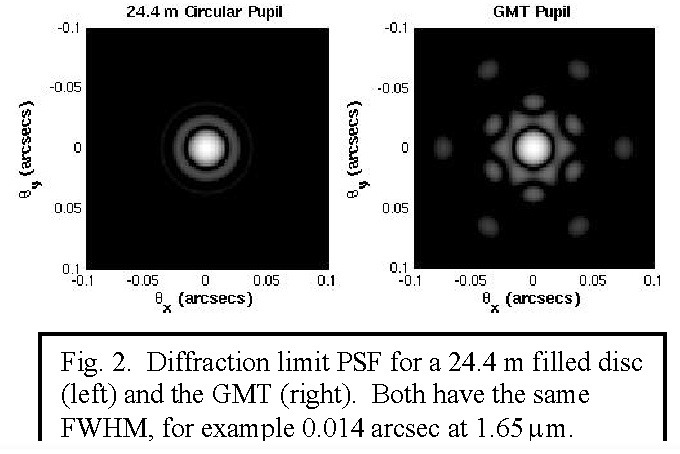

It appears the Giant Magellan will have circular fraunhofer diffraction rings familiar to users of refractors:
I find the "200 times more powerful" statement questionable. This image surprises me too, because I would have expected a hexagonal diffraction spike pattern. Must be missing something.
Interesting mathematical diffraction problem! I always found aperture diffraction interesting. Something is cancelling out here! Will sleep on it! 🙂
The Verge:
"Both the primary and secondary mirrors contribute to the diffraction spikes but in slightly different ways. Light diffracts, or bends, around objects like mirror edges. So the shape of the mirror itself can result in these spikes of light as light interacts with the edges of the mirror. In Hubble’s case, the mirror was round, so it didn’t add to the spikiness. But JWST has hexagonal mirrors that result in an image with six diffraction spikes."

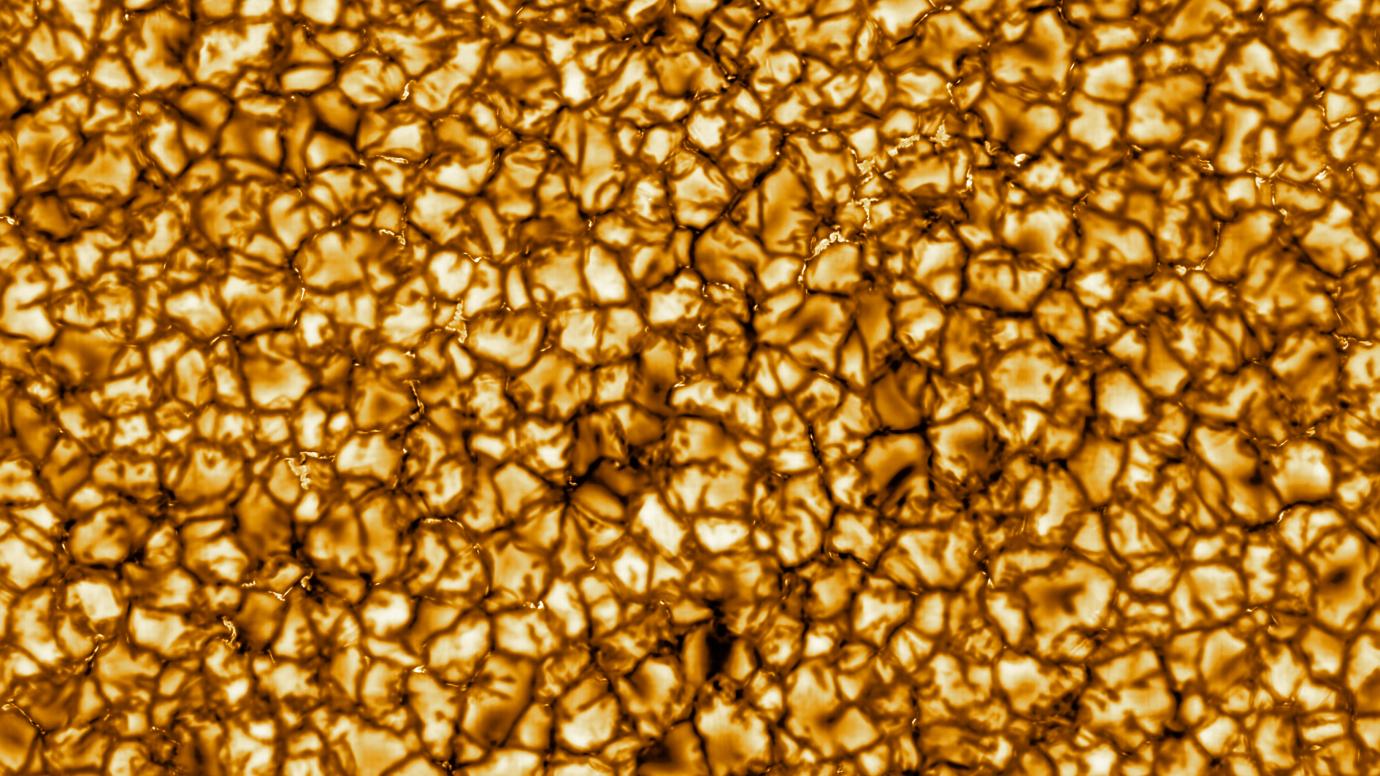

The thermal cells on the Sun's surface are hexagonal (bit like the one on the poles of Saturn - or is that Pentagonal in shape?). I saw a paper from someone a few years back that described why this was the case - cant find it now.
So, it does seem there is something with these hexagonal/pentagonal shapes. Must be 'aliens'.

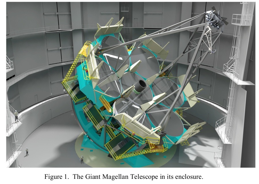

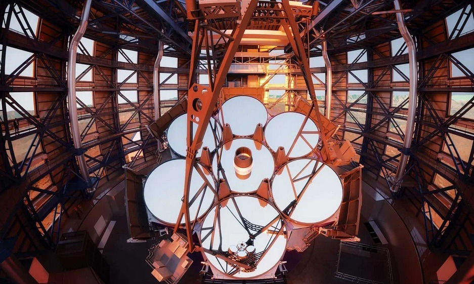

Anywhoo, back on-topic. This 24m Giant Magellan Telescope is superb. Height of 22 stories in enclosure, adaptive optics (correcting every thousandth of a second for atmospheric turbulence on the secondary mirror) to deal with a blurry atmosphere, and very few spikes due to clever design.
Have gathered a few images together to explain most of the subtleties. It is essentially a three element Gregorian reflector. Which corrects most of the aberrations. 🙂

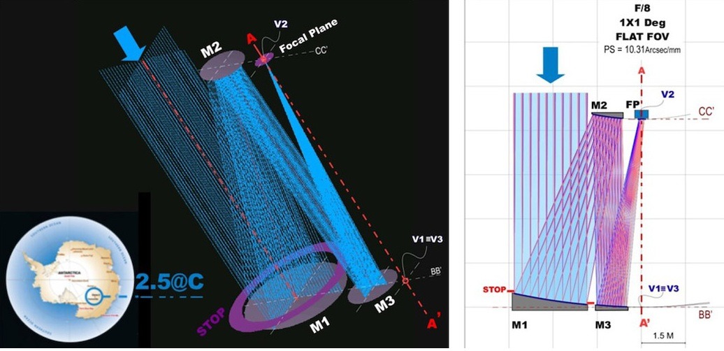

Herte's an assymetric solution which has been proposed.

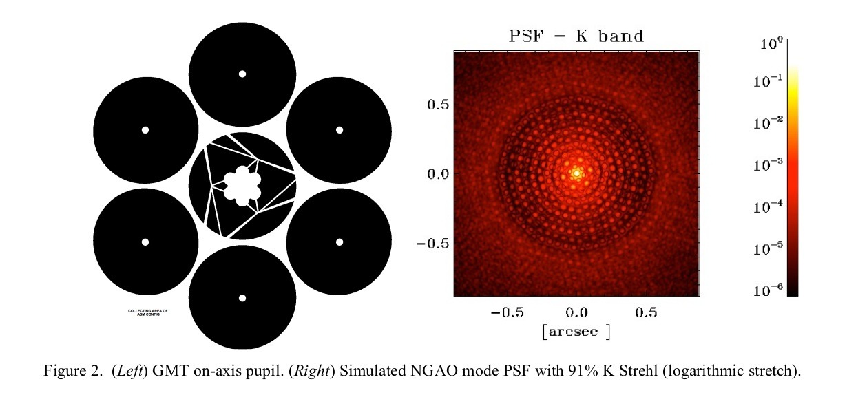

Back to GMT:
Another proposal:

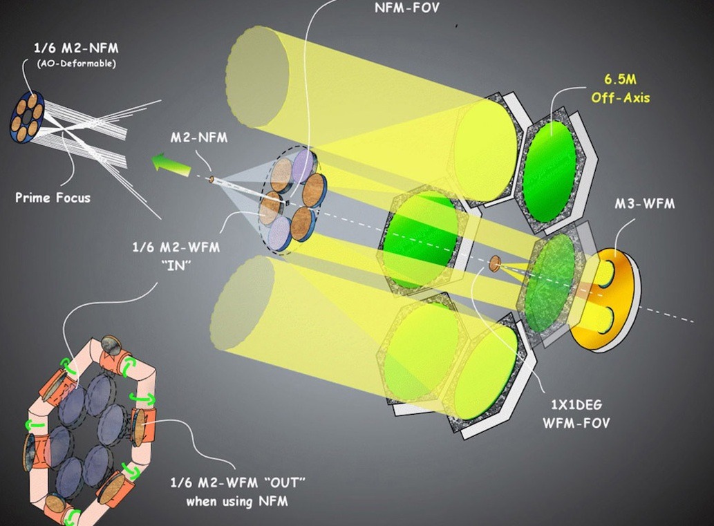

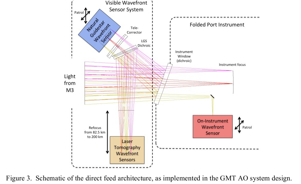

Back to the GMT sensors:
The struts lie between the mirrors, hence don't interfere with spikes except on the central mirror. I am unsure how the circular mirrors help here, but it is interesting that the secondary mirror matches the primary in 7 elements. Hope that clears it up.

There will be seven mirror segments, and the size of the central segment alone can be appreciated by looking at the attachment.

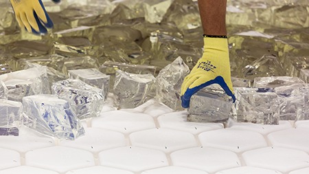

EDIT: We see in the picture I posted the shapes of the honeycomb mold for the mirror glass, which is used to achieve a lightweight structure.
https://spie.org/news/photonics-focus/mayjun-2020/casting-giant-telescope-mirrors?SSO=1
Reactions: myleftear

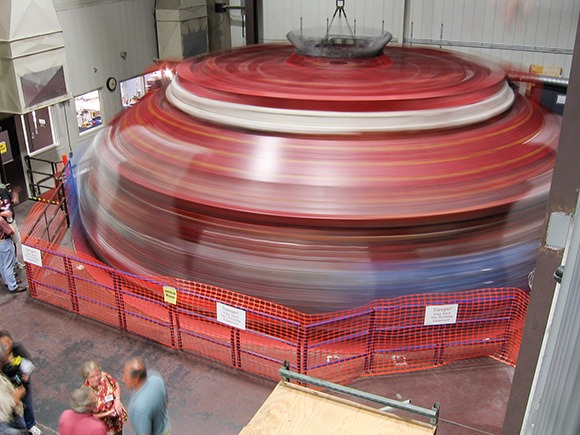

Attached is the low expansion glass being placed in the honeycomb mold.
"They decided that it would be easier to build a mold with the inverse honeycomb structure inside, add the glass in broken chunks, and then melt it all in a furnace. The ceramic fiber used to make the honeycomb could be power washed out of the mirror once everything cooled, leaving the mirror 80 percent hollow."
The mirror is spun into a parabolic shape as the glass cools, which takes three months!
