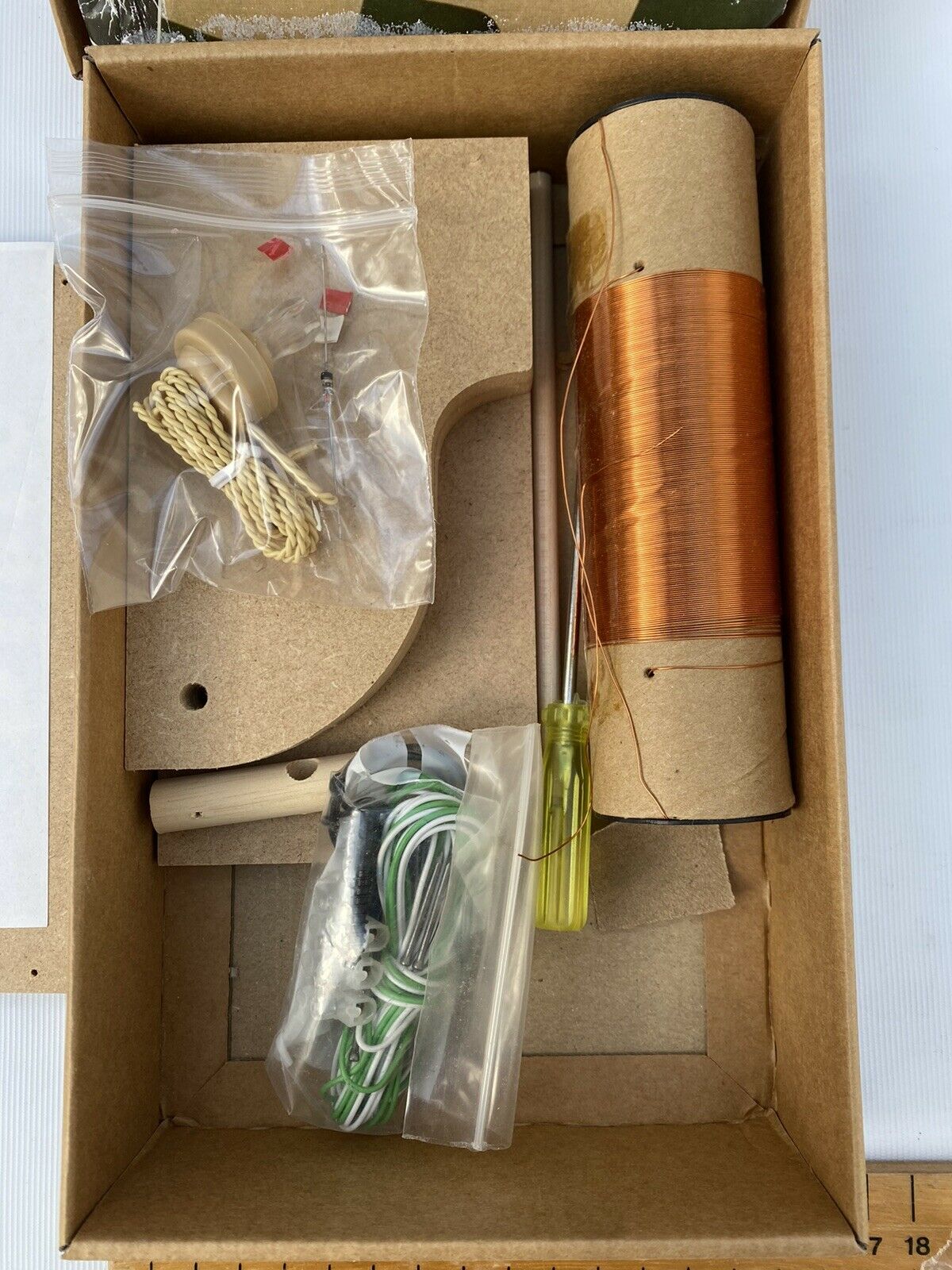

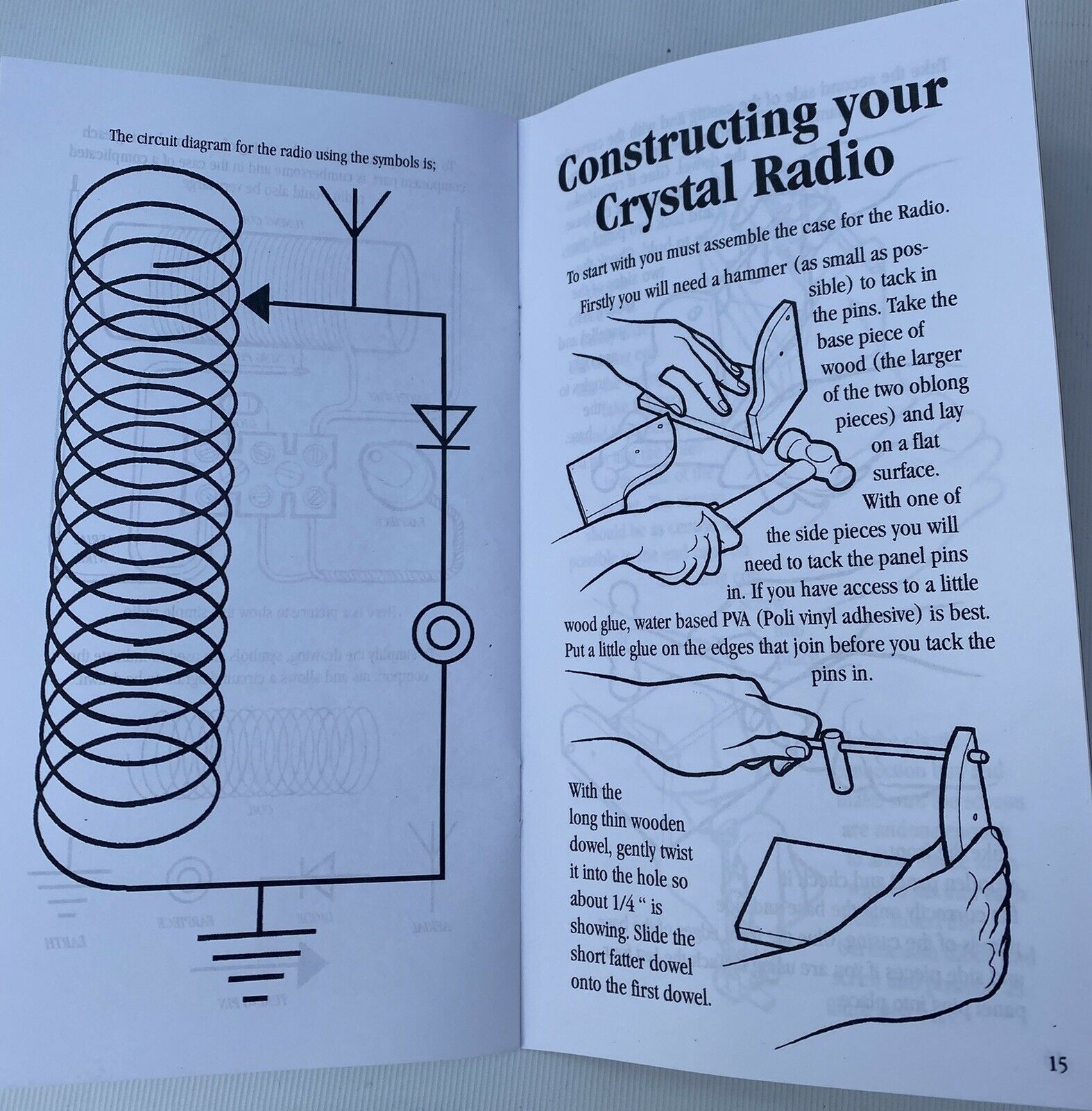

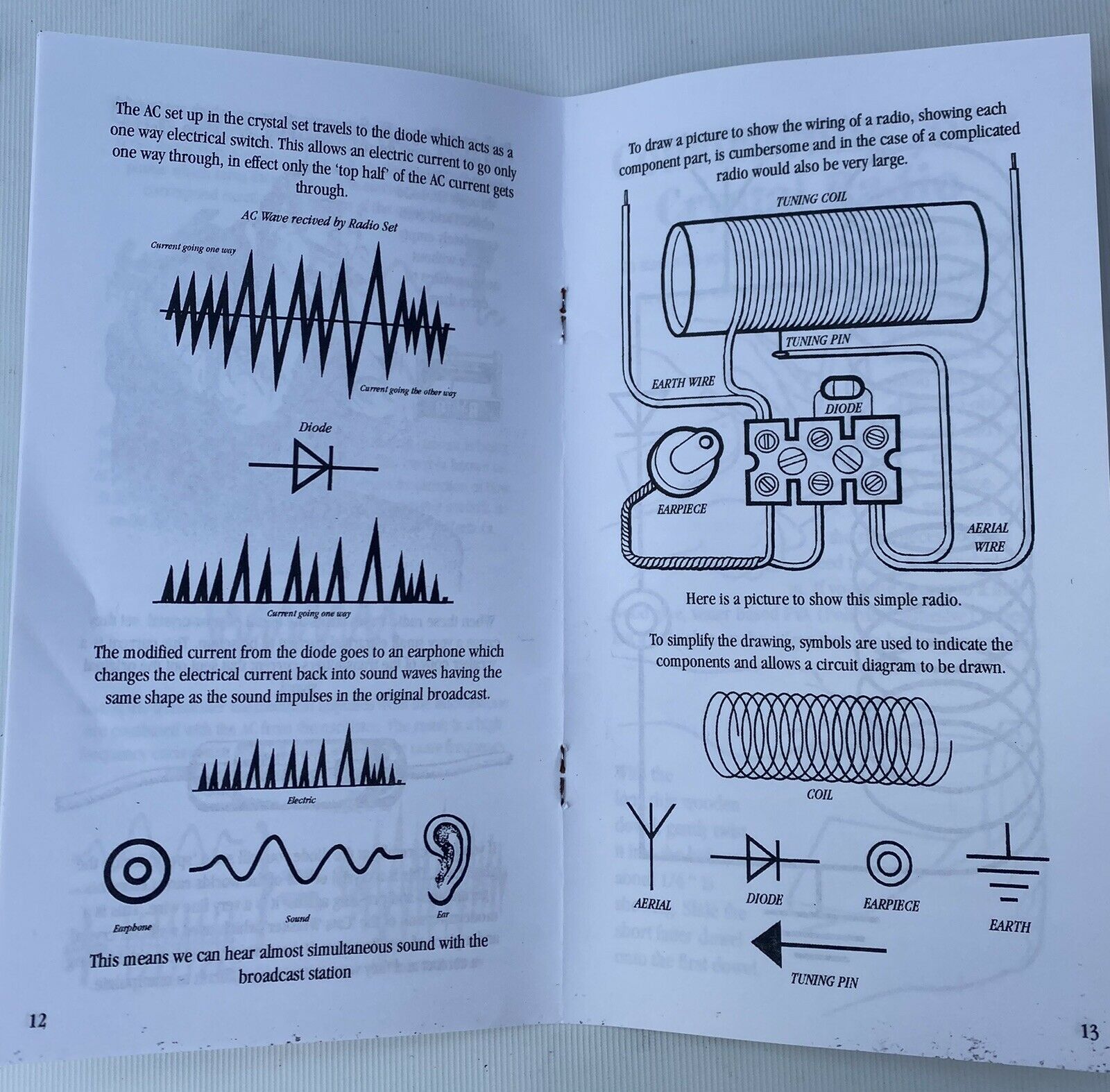

P.S. Knowing of my interests, a well meaning friend bought me a Radio Receiver Kit - "Make a Crystal Radio Just Like Grandad Made".
It cost him £25.99 and I hadn't the heart to tell him he'd purchased what was basically a few bits of MDF, a coil of wire, a diode and a crystal earpiece - worth about 50p in total! It didn't even have a tuning capacitor, being the most basic circuit imaginable.
I wouldn't consider wasting my time building it as I know it would be rubbish, and it's now lined up for going to the charity shop!
