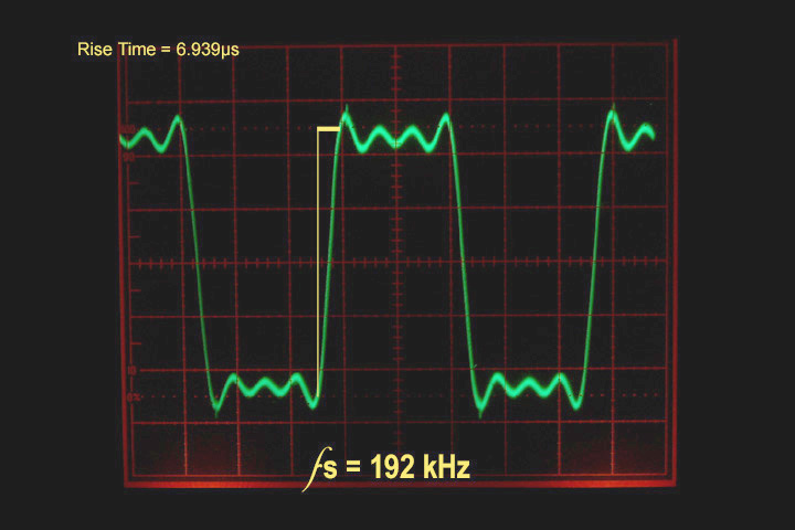

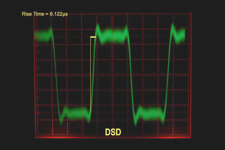

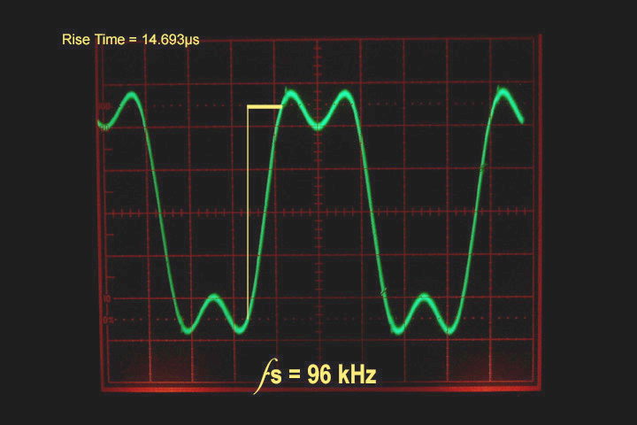

Once again, as a professional audio designer, I have to design for REASONABLE WORST CASE, not typical, or for some audio listener using only CD or worse, for playback. My clients may use 30 ips analog, or 192/24, DSD, or even faster audio sources. I have found by measurement that it both MC phono and 30ips analog master recorders can give 10us rise times. Also, our work on TIM has shown that the TIM(30) test signal is necessary for highest quality reproduction at minimum, and even faster might be even better. We established this 35-40 years ago, so many new to this subject may not be aware of this. The TIM(30) test signal has approximately a 10us rise time. This is where I establish that a 10us rise time is a minimum goal for insuring low TIM under all normal conditions. Now for some digital measurements: Please note that 10us is actually too slow for today's worst case (hi end) digital reproduction.
