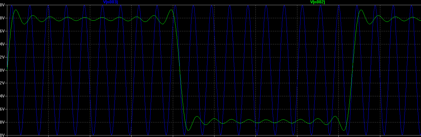

The concept of superposition of sine waves is pretty old and most people see it in high school math, so why is it so "alien" here?
A prime example is a square wave. A square wave is a specific series of sine waves with specific amplitudes. The fundamental is just the same frequncy as the final square wave. The harmonics of this frequency are all odd-order and have an amplitude that is the reciprocal of their order. For example, the third harmonic is at one-third the amplitude of the fundamental; the fifth harmonic is one-fifth the amplitude,and so on.
As you superimpose each harmonic over the fundamental, the slope of the leading edge of the composite wave becomes steeper. In a properly scaled drawing of a sine wave the zero-cross slope is actually 45-degrees, but as you superimpose further frequencies the slope approaches 90-degrees. This is just high-school math, as I said. Not complicated enough for some around here, I guess.
Music superimposes many frequencies at a time. If it did not, the envelope of the sound would not be as it is - uncompressed sounds have transient attack that is up to four times the amplitude of the sustain part of the envelope, but more typically just twice as high. Because the superposition dramatically steepens the slope of the leading edge, it is pretty much a necessity that an audio circuit have fast response and that this response be much faster than simply passing the highest sine frequency demands.

Sigh. This is not true is the system is bandwidth limited like audio. In that band, the higher harmonics that contribute to the ever increasing steepness, are simply not there. So the steepness is ultimately limited by the bandwidth, as explained here over and over again.

How about NO?!
I'm attaching a picture, there is a 20 Hz square wave up to its 19-th harmonic and a 19*20 Hz sine wave at full amplitude.
Please compare slew rates, it's not that hard.

You started so well, with undeniable facts. Sadly you gradually moved from facts into myths.Struth said:A prime example is a square wave. A square wave is a specific series of sine waves with specific amplitudes. The fundamental is just the same frequncy as the final square wave. The harmonics of this frequency are all odd-order and have an amplitude that is the reciprocal of their order. For example, the third harmonic is at one-third the amplitude of the fundamental; the fifth harmonic is one-fifth the amplitude,and so on.
Having for a brief while believed (on the basis of a flawed mathematical analysis) that a band-limited low frequency square wave needs more slew rate than a maximum frequency sine wave, I now believe (on the basis of a correct mathematical analysis) that the maximum slew rate is the sine wave. I say this because I can't conceive of a faster slew rate (before bandlimiting) than a square wave - music waveforms don't even come close.
People need to stop hand-waving; only physicists are licensed to do that and they know about mathematics and orders-of-magnitude. If someone believes that they can invent a bandlimited signal with faster slew rate than a max freq sine wave then let them offer proof by construction. If they are right then I will believe them.
Have fun
Nice!
