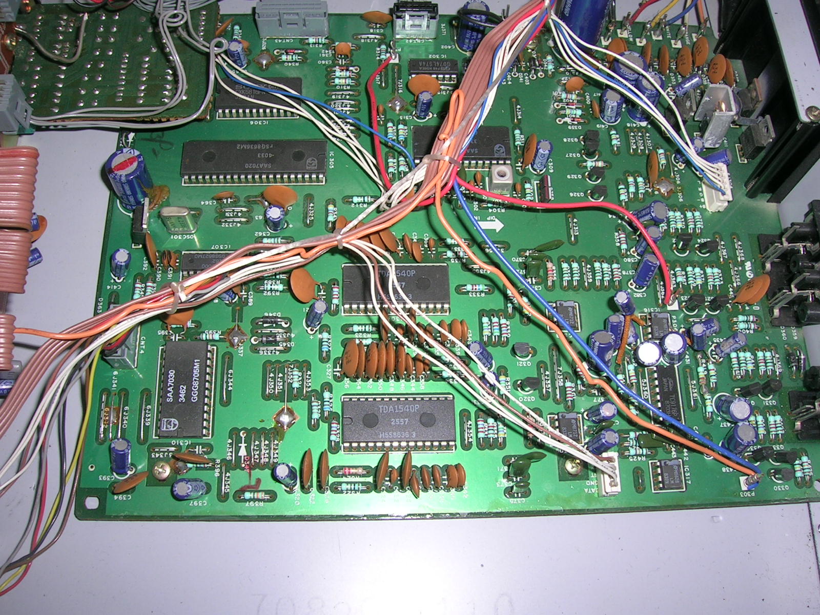

Besides, after listening for a long through a SAE D102 (2xTDA1540P 14bit DACs) and enjoying the music much, I am left with no worries over the adequacy of 16bit depth (and 44.1kHz sampling) in conveying satisfactory and emotionally engaging sound to my ears.

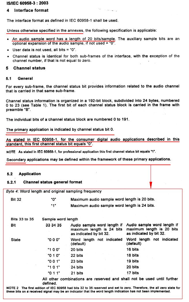

To sum up my understanding with the S/PDIF 20bit limit issue:
It should not be taken for granted that an S/PDIF port is transparent to the source’s bit depth. It all depends on the digital audio transmitter chip used and it’s configuration.
Please correct me if you think I’ve got it wrong.

That seems right. I just wanted to get clarity on the notion that a stream tagged consumer can not do 24 bits which appears to not be true. I did find heated discussions, some more than 15 years old, on the subject of PC based DAW's where some manufacturers were scrambling to update their cards and firmware to support true 24 bits.
Oops!
You made me reread standard IEC 60958 –3 and now I will agree with you (thus what I wrote in post #226 is only partially correct)
As I understand, by the “a stream tagged consumer” you mean a stream which has “0” at the bit 0 of Byte 0 of the Channel status.
Well, although this means consumer as a ‘primary’ application (which would render it to 20bit max), there is the ‘secondary’ applications option, which for the case of audio word length is materialized by bit 32 of the Channel status
If bit 32 on Byte 4 is
“0”, then maximum audio sample word length is 20 bits
“1”, then maximum audio sample word length is 24 bits
Restrictions: There is Byte 1 (bits 8 to 15 included) which sets the category code. Each category has a fixed audio word length (all are less than 20bits, see para 5 and annexes).
Conclusion: A digital audio stream tagged consumer can do 24 bits.
