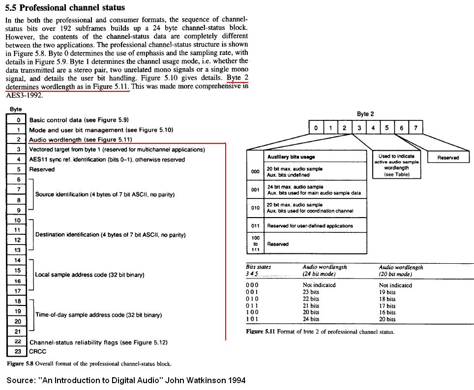

There is nothing at the SPDIF signal path from the source to the destination in a home environment that deterministically restricts transmition to 20 bits (PCB tracks, resistors, pulse isolation transformers, 1m coaxial interconnect, RCA plugs).
AES3 and S/PDIF differ in signal amplitude and impedances but audio data format is the same between AES3 and S/PDIF, they have different subcode formats.
Does the subcode governs the bit depth of the audio data?
George
Yes all bit depths from 16-24 are set by a subcode. Considering the awkwardness of not doing things on 8bit byte boundaries I can only imagine that the 20bits is simply due to a particular DAC or A/D chip. My Philips CD recorder was 20bit.

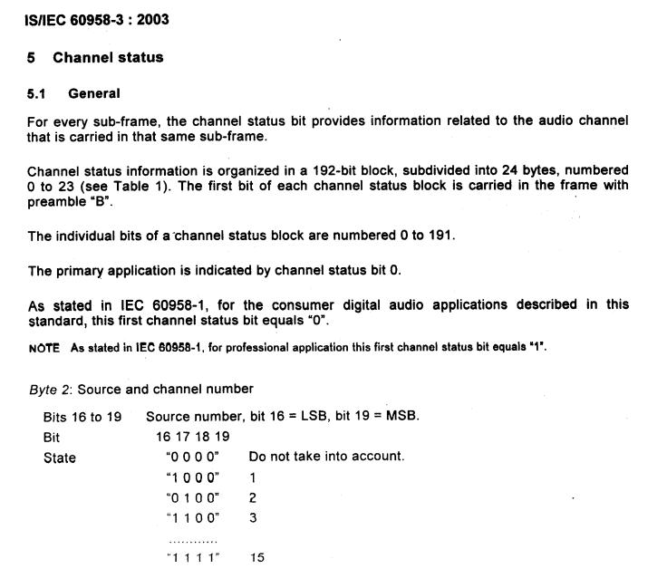

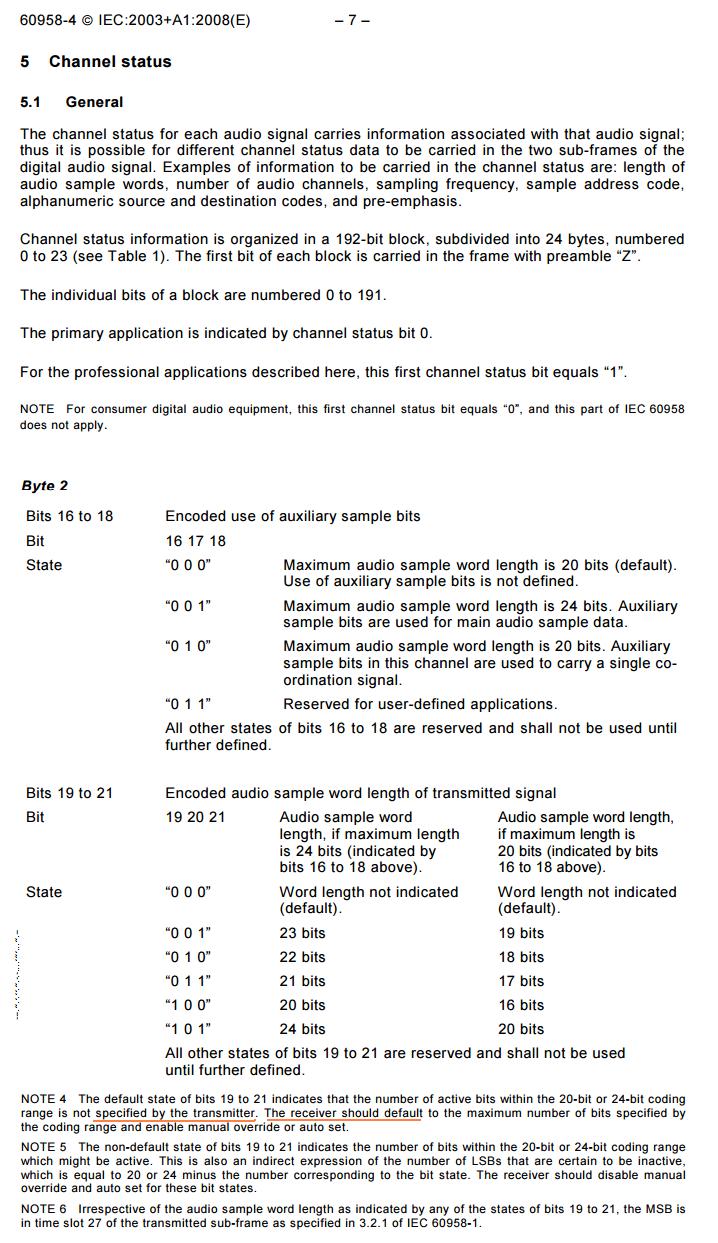

Thank you Scott. I searched for some details, see attachment 1.
No, unfortunately it’s not on the DAC.
On attachment 2 (extract from IEC 60958-4 Edition 2.1 2008-07) down at Note 4, you will read that the formation of the subcode is done by the transmitter chip. The receiver chip is left to adjust the bit depth accordingly.
Reading hierarchy:
Byte 0, bit 0. If it contains “1” (which identifies professional AES/EBU) then according to contents of bits 16, 17, 18 of Byte 2, receiver sets the bit depth accordingly (subsequently reading bits 19 to 21) .
If Byte 0, bit 0 contains “0” (which identifies consumer S/PDIF), receiver defaults to maximum bit depth of 20bits. It further reads bits 16, 17, 18, 19 for to set number of channels (mono, stereo, multi-channel up to 15). See attachment 3 (extract from IEC 60958-3 Issue 2003)
Thanks to Chris Daly for pointing to this technical restriction.
George
Wait a second George, why would it matter if a player for consumer CD's had 24 bits in the first place? I sort of missed the point of the first comment then, I assumed it was on the capabilities of SPDIF.
That would be cool actually if all optical outs on most USB and firewire sound devices were 20bit.
George here's another reference (It was hard to find one that actually went through all the differences between consumer and pro bit by bit). He starts at byte 1 so maybe he hasn't programmed since Fortran. 🙂
http://www.av-iq.com/avcat/images/documents/pdfs/digaudiochannelstatusbits.pdf
There is no provision for any sampling rate above 48K in consumer so I would assume any 96K+ stream could do 24bits. Also this contradicts the other reference clearly showing 16-24 bit capability embedded in the consumer format.

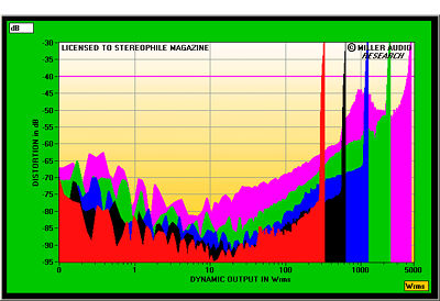

Real peak power performance:
John,
I take it that
• RED = 16 Ω: breakup at 320 W
• BLK = 8 Ω: breakup at 640 W
• BLU = 4 Ω: breakup at 1,250 W
• GRN = 2 Ω: breakup at 2,500 W
• VIO = 1 Ω: breakup at 4,800 W
Loads? Seems about right. Each of the colors goes into clipping distortion at almost exactly 2× its lower neighbor. Must be those. Those are some wicked amplifier specifications. If solid state (of course), then you're looking at ± 100 volt rails. I'd bet that you'd also need forced-air cooling anywhere near the limit power output levels.
Which ironically isn't very different from my Vintage 1980s Crown '4000' amp. 100 volt rails. Forced air cooling. Can drive basically ANY load. The VIOLET = 1 Ω seems to be a little shy (4,800 W instead of 5,000 W), but I bet that's because of the self-protection current limiter circuitry kicking in. Right around 50 max amps, right?

Chris Daly’s comment has taken me too by surprise. I said, it can’t be so.
But when I started reading the IEC standard, it became clear to me that bit depth depends on the S/PDIF transmitter formation of the Channel Status Byte 0, bit 0.
An S/PDIF port of a device may output 24bit audio stream, if the digital audio transmitter it contains is suitable for both professional and consumer audio applications and is properly programmed/configured.
