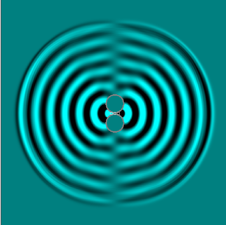

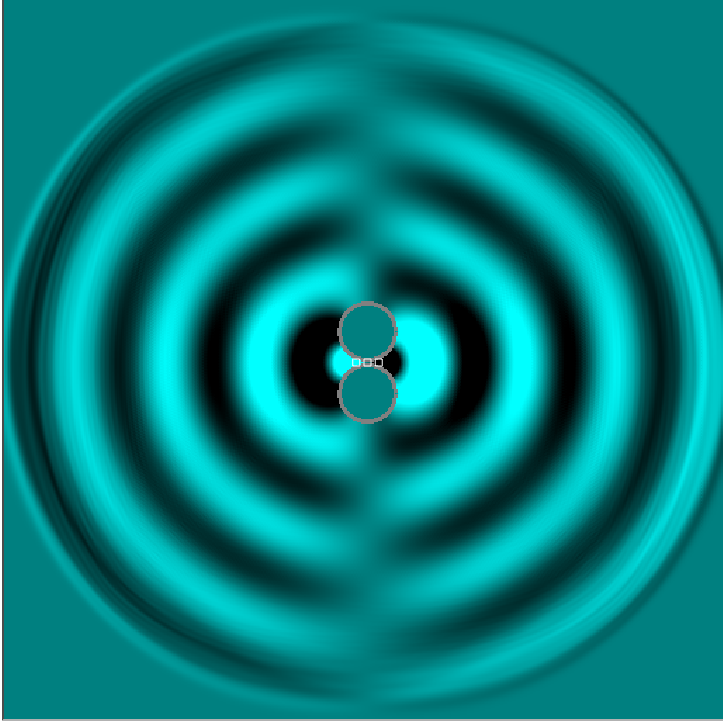

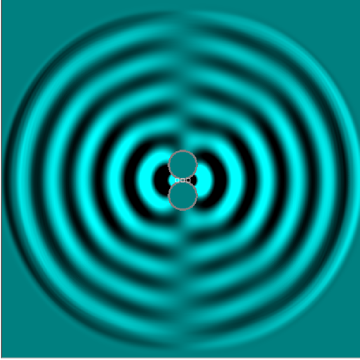

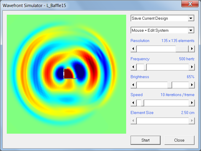

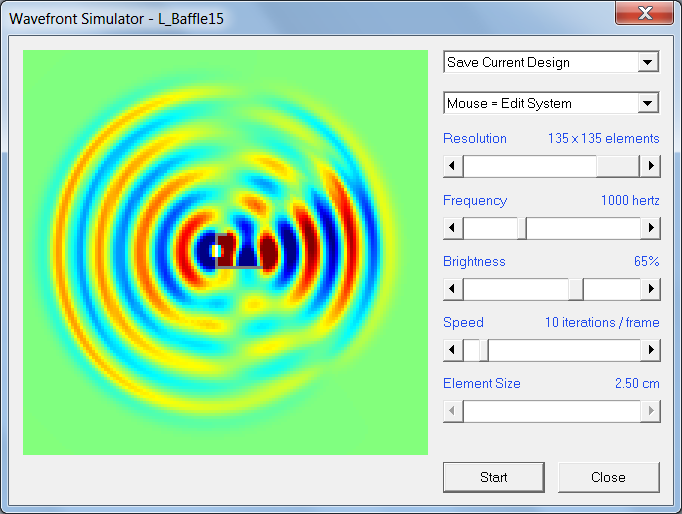

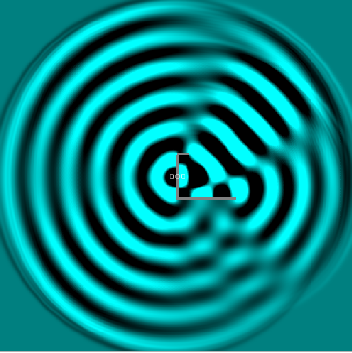

This is the straight baffle. Performance remains to a higher frequency, presumably due to the lack of baffle clutter. The nulls are consistent.
The higher order modes are also relativly simple, which has it's own story to tell.

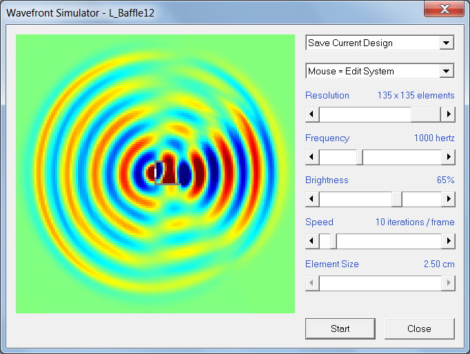

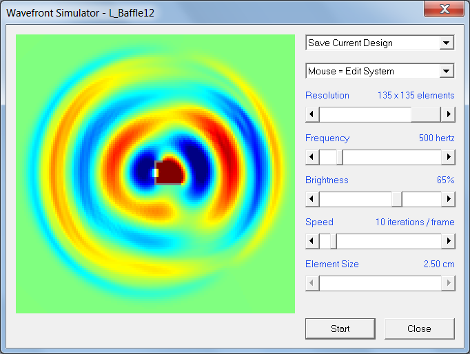

Hi, how to interpret the simulation pictures, where are the sound pressure maxima, and what does "null" mean in this context, same as sound pressure minima, ie. cancelation?
In the Hornresp wavefront simulator, maximum positive pressure (compression) is red, maximum negative pressure (rarefaction) is blue, and zero pressure (null) is light green (the background colour).
Yes, I was thinking of nulling when color "dilutes" ie. amplitude gets very low.

Thanks both David and Juha, yes I understood that too where the blue and red "waves" are less prominent is the region with lower pressure variation.

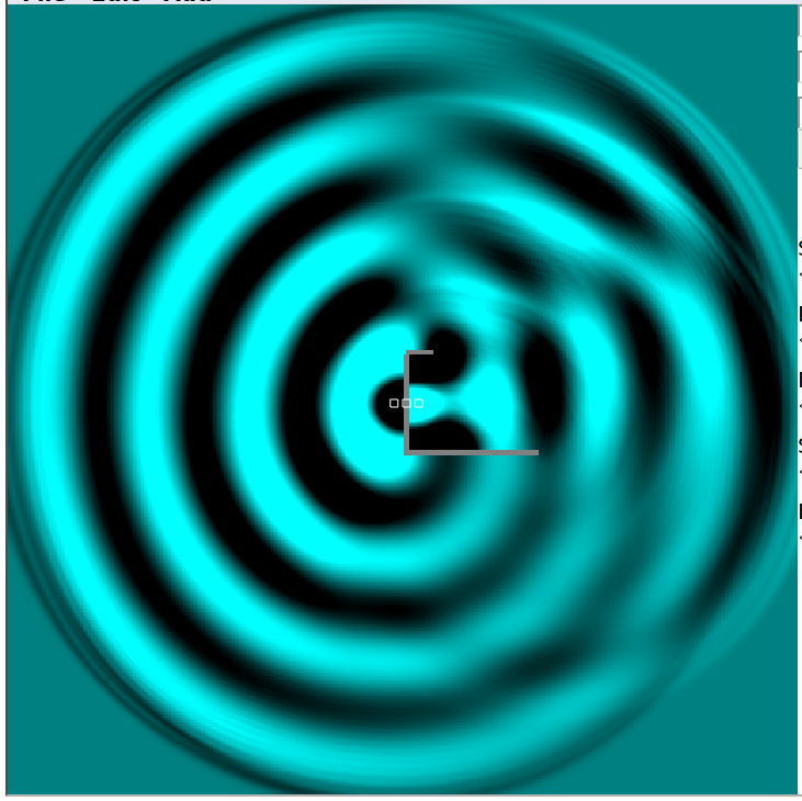

It seems to me when one goes relatively high up in frequency for instance with the L shape it starts to behave like a horn in one direction, and the edges where the walls ends produces diffraction artifacts which adds up to more complex polar pattern in some parts although it seems to be more a problem with the backward going waves...?

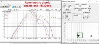

Curved or sidewing baffle backside is a horn and has different directivty and even horn modes - above dipole peak. Period. For full-range dipole one must use multiway system with varying baffle width!
Here Edge sim with a flat baffle, driver asymmetrically and of-axis to left and right. I would not even try to optimize it to play above dipole peak!

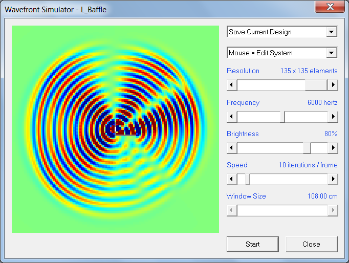

It's interesting, this quick view may not be comprehensive, but the on axis nulls aren't appearing.
