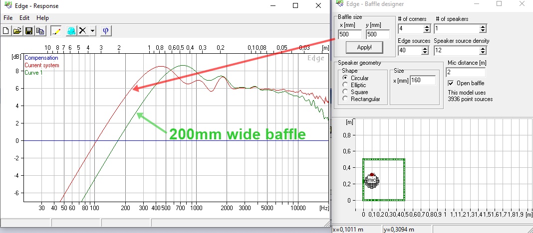

I haven't learnt VituixCAD, but The Edge has helped me enormously to get grasp of these things. Unfortunately sidewings can't be simulated by either.
p.s. i don't give Audiocircle gurus Ritchie or matevana any respect regarding OB design, and I have practically stopped following. When I visit I get nausea very fast...

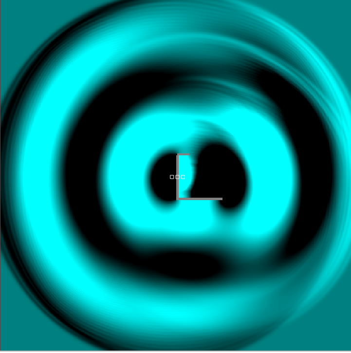

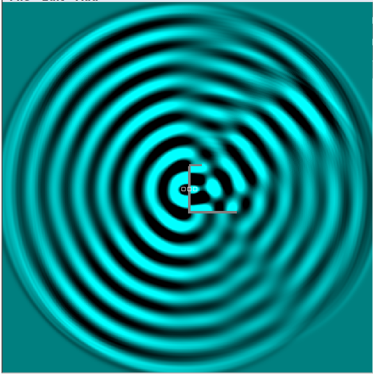

This is Edge sim that emulates a sidewing added on a 200mm wide open baffle. If the sidewing is 90deg to front baffle, the ripples above dipole peak will be different. As well off-axis to left/right will be different from simulation.

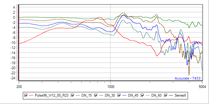

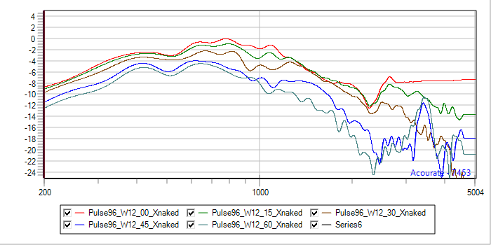

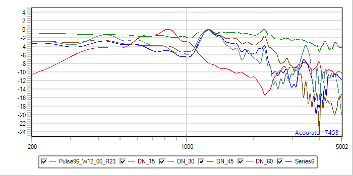

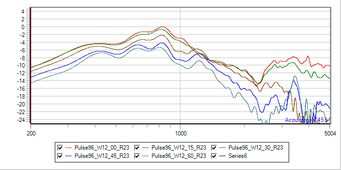

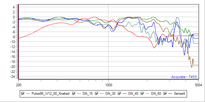

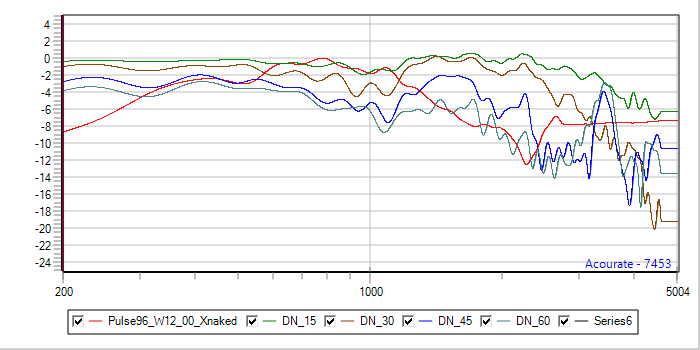

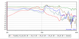

I have no data about adding fins to a baffle. But I have modest data adding a ring at the back of a naked midrange driver, dating from some time ago. Driver was a Seas Excel W12CY001. The ring was 23mm in dept.
I assessed the polar behavior in increments of 15° from 0° to 60°.
0° red
15° green
30° brown
45° blue
60° grey
The three graphs of each setup show
A. The curves 0° to 60° such as after normalizing the max. of the 0°-measurement to 0dB
B. The the differences between 0° and the angled 15° to 60° measurements
C. Is B, but all curves normalized/nulled to max = 0dB
Naked:
Backring version:
Watch the behavior of the polar in the useful range of this midrange, e.g. between 700Hz and 2.5kHz. Both versions do have an annoying anomaly between 1kHz ... 1.2kHz. The ringed version was mixed blessings, whith a tendency of worsening the polar behavior.

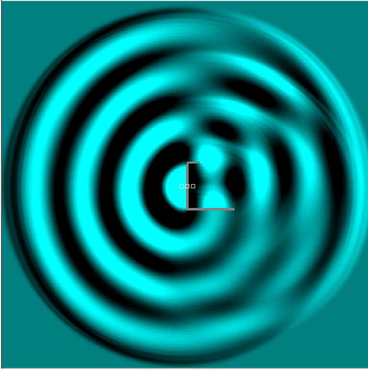

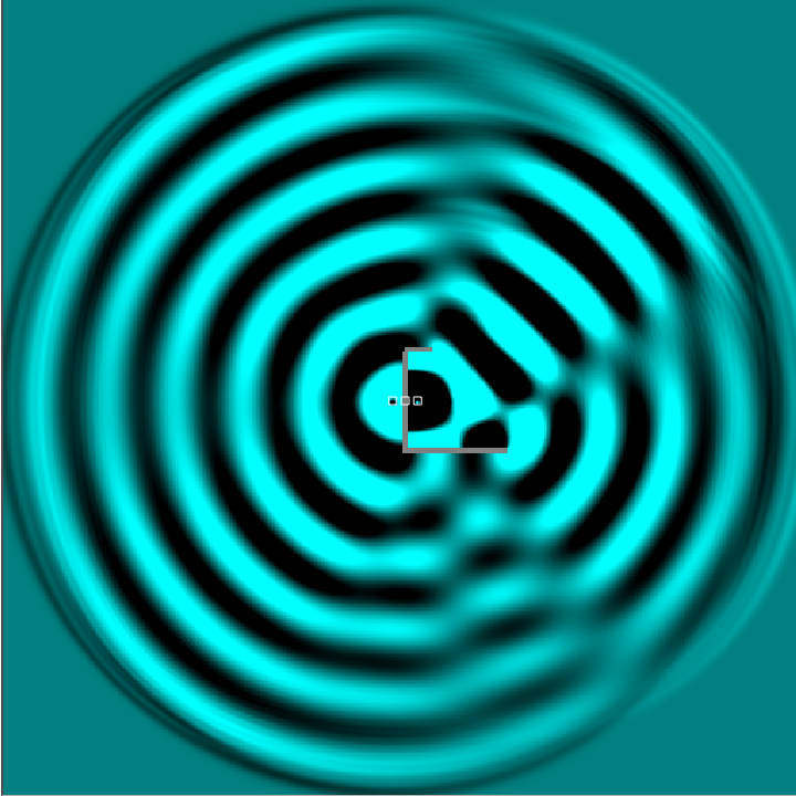

The distances are relative. Even though hornresp does coordinate it's designs with frequencies. I've been doing freestyle baffles.
Therefore I'm just trying to get some relevant frequencies to go with them.

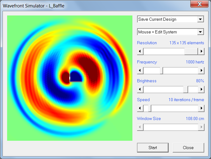

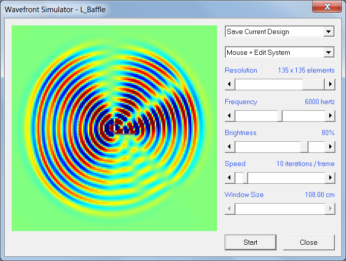

First 12/12/3
