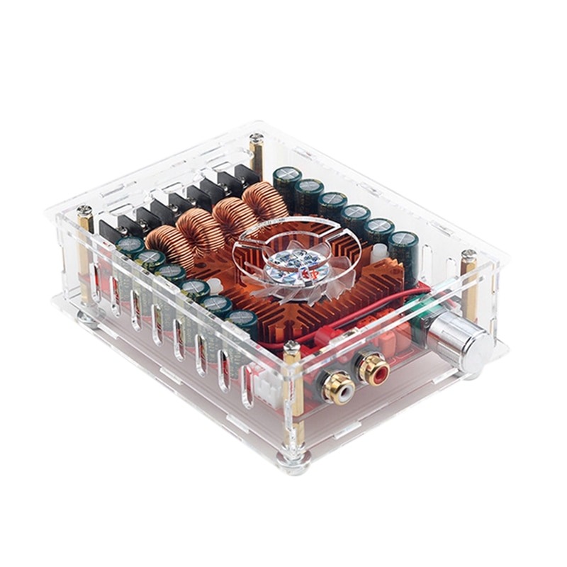

Hello,Is TDA7498E a good chip ?
Yes, I think it's a good chip, you get a lot of power for the money.
I purchased my TDA7498E class D amp 2 years ago, connected it to my computer and my Technics SB-X3 old speakers and played some FLAC and APE music files, some CD quality, other 24-bit Hi-Res and I have to tell you that I'm astonished by the sound quality.
I just purchased the cheapest I could find in Aliexpress, it cost me only € 17,69 and it included an acrylic box similar to this:
Maybe the price is a little more expensive now.
Please pay attention that there are a lot of different models and some can have fake or non-appropriated components.
For example, I saw in a review that the amplifier came with the output filter that it's simply wrong for 4 ohms. Another manufacturer might well have it correct but not in the case of the reviewed amplifier. Also for power output, few of any type of chips will give the rated power. 32 volts is simply not high enough but that is what they recommend.
But I'm happy with the sound quality and I use my TDA7498E class D amplifier with a 4 ohms speakers and a 32V 5A power supply, I do not get the rated power but I might get around 90W per channel with my Technics SB-X3 4 ohms speakers which is very good for the price.
