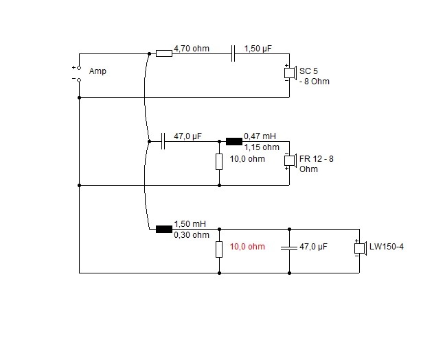

I already tried adding a 10 ohm "grounding" resistor in the crossover to solve this, but the distortion above 70% persisted (and it did not sound quite as sweet as without this for some reason).

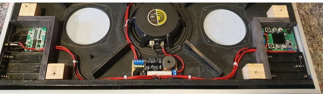

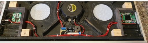

I already tested with a 200W RMS into 6 ohm amp and it worked perfect - but that is not the mission. Unfortunately, I like lithium batteries too, but space really comes at a premium in the flatlands 😟
I also tried this ZK-1002, https://www.amazon.de/Bluetooth-Amplifier-Performance-TPA3116D2-ZK-1002/dp/B087FG37Z7/
but a single channel was not powerfull enough, so I tried (in desperation) bridging the two channels. That worked perfectly for 8 hours untill it burned out 😟

I'm sorry to say this, but you lack basic understanding of electronics.
The 10 Ohm resistor in your x-over only increases the load for the amp and lowers the bass level.

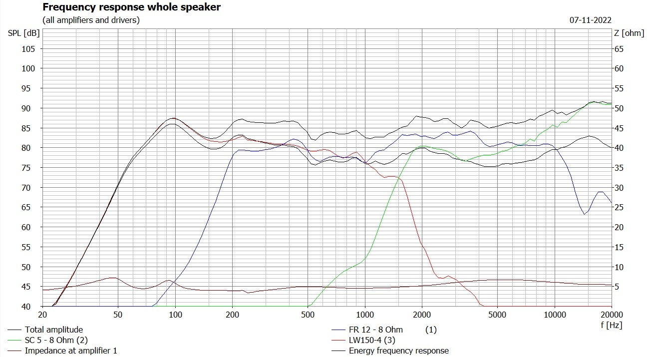

A bridged amplifier with a 24 volt supply can output a peak to peak voltage of 44 volts or so. Two in series can do 88 or so. Within 2 dB of the goal at 6 ohms, however from the curve shown and Fletcher Munson sensitivities, I would use 4 ohms for the loudness perceived. So probably not noticeable. Lithium cells would more likely produce just a bit more than 25 volts unloaded.
Of course impedance of the load is not a resistor, so voltage and current will not be in phase and power will probably be even lower.
