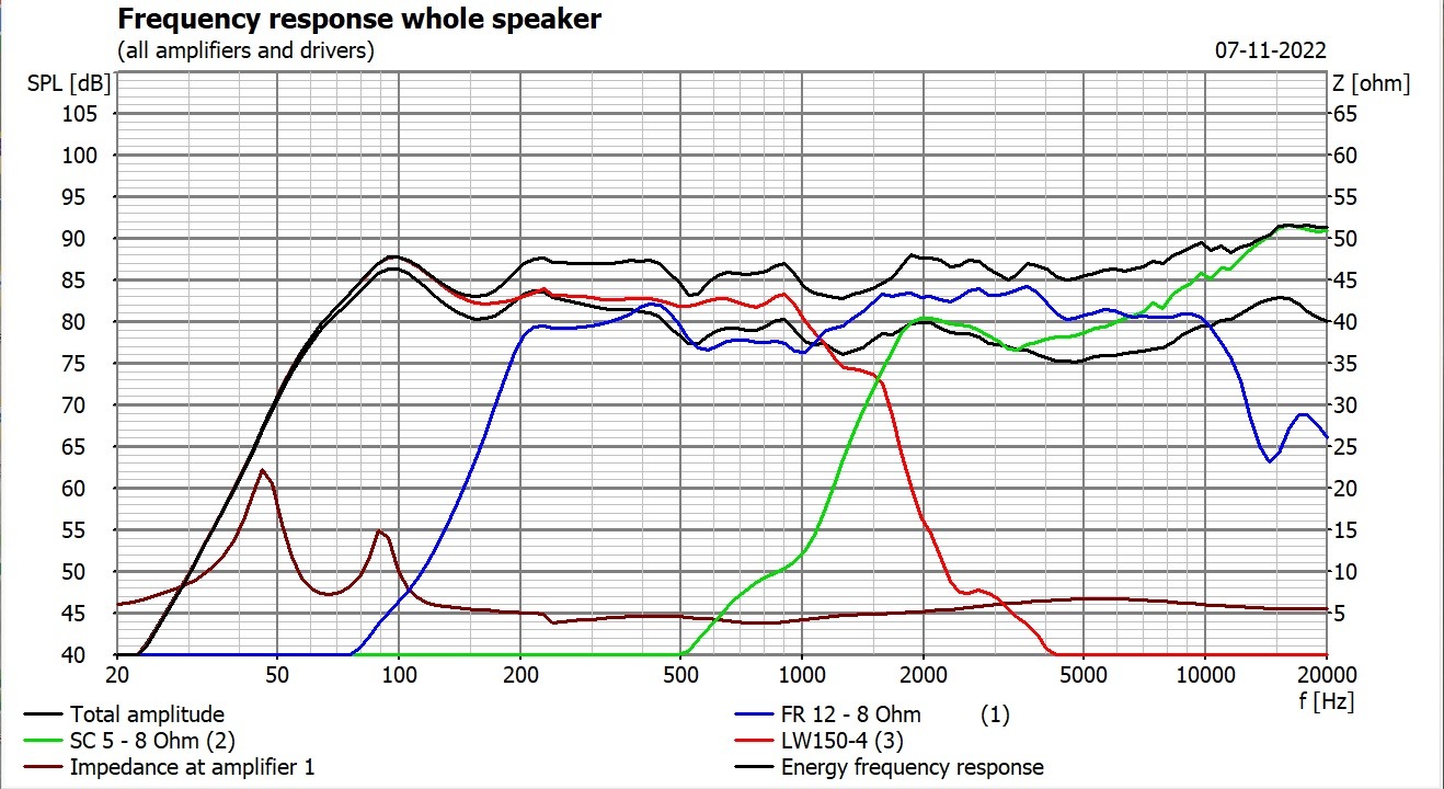

This thread is useless without a +51V or higher power supply.
You can argue EQ, Op Amps, 1ohm speakers or the phase of the Moon until the cows come home, no TPAxxxx or any other amp, chipamp or discrete will put out 200W into 6 ohm as required without such a supply.
