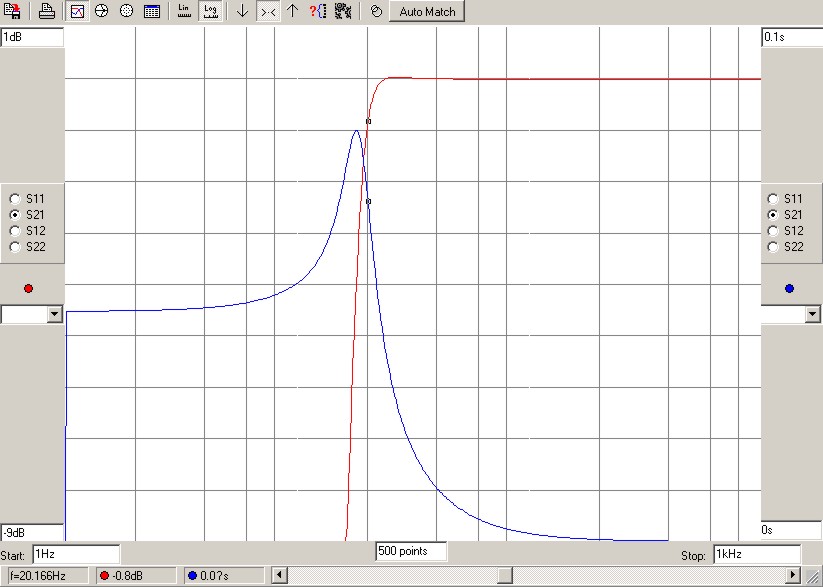

Seems a mechanical solution is best for damping rez. Then, add a HP filter if still needed. If that is done... pls measure the group-delay as well.
THx-RNMarsh
Agreed. For a BW response, the simulations show ~70mS GD at 20Hz and it falls below 20mS at freqs above 30Hz.
How did this thread go from a conventional filter solution to arguing about Ib noise and proper termination/coupling for cartridges?
I haven't measured GD; maybe when I get proto PCBs. The plot is from RFSIM99, a linear simulator.
Measurements of the frequency response are posted in post #201, taken with a Standford Research SR770 FFT Network Analyzer. They very closely match the simulations.
