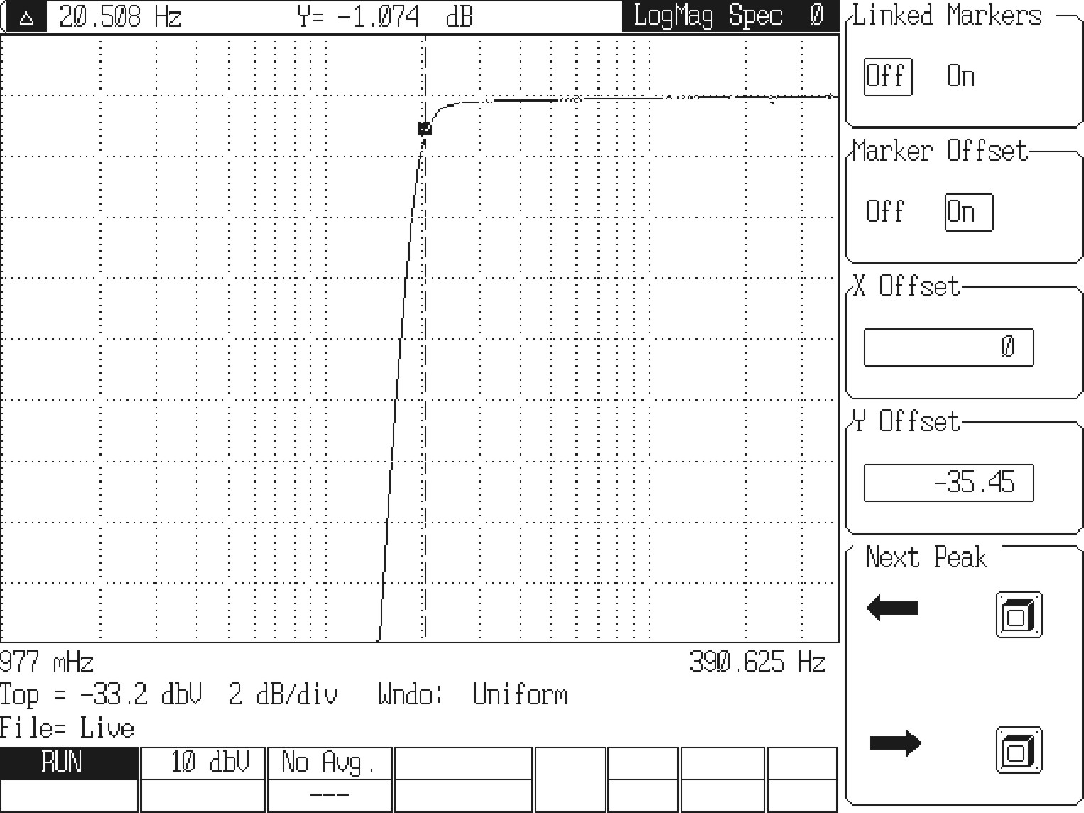

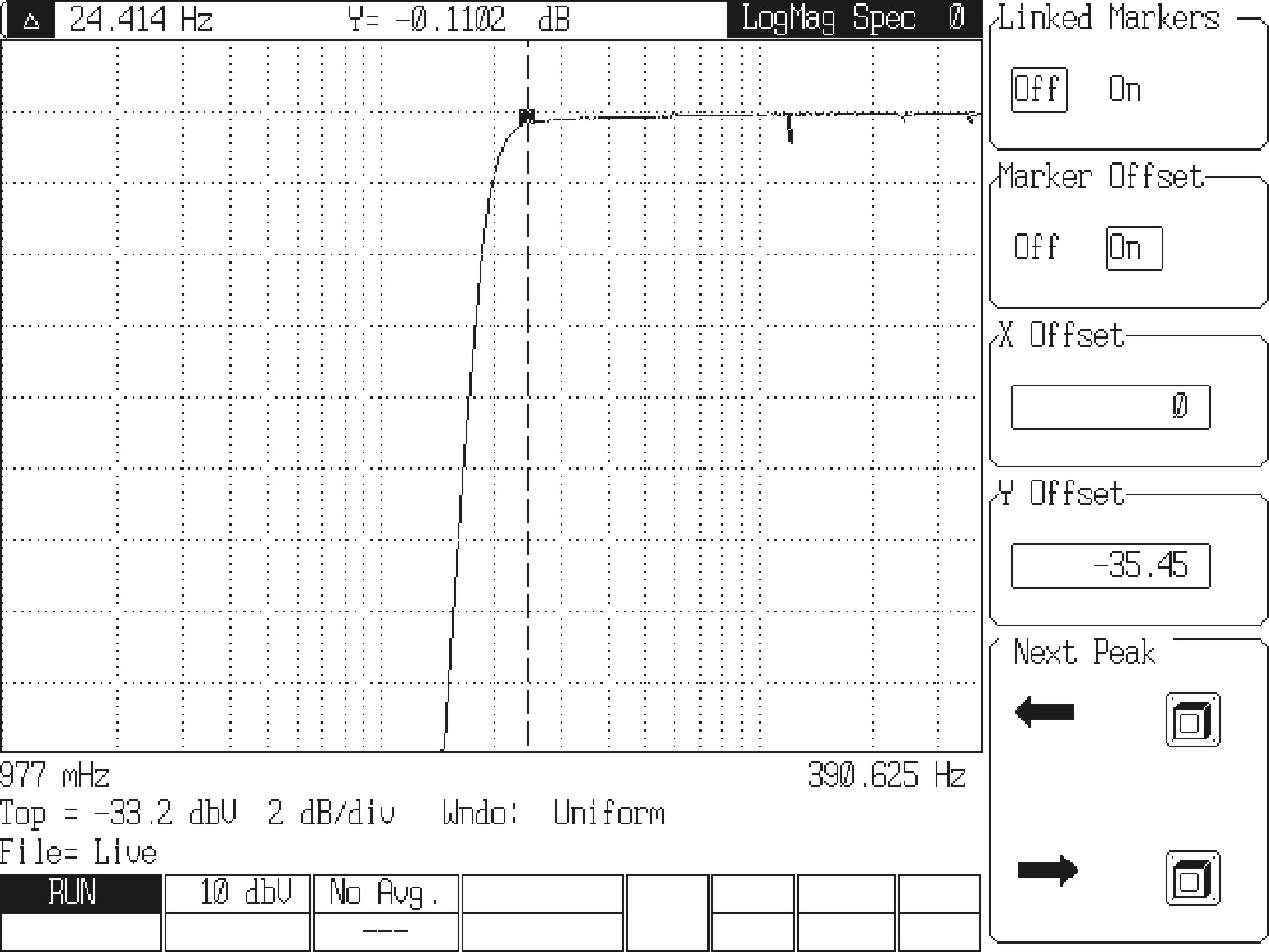

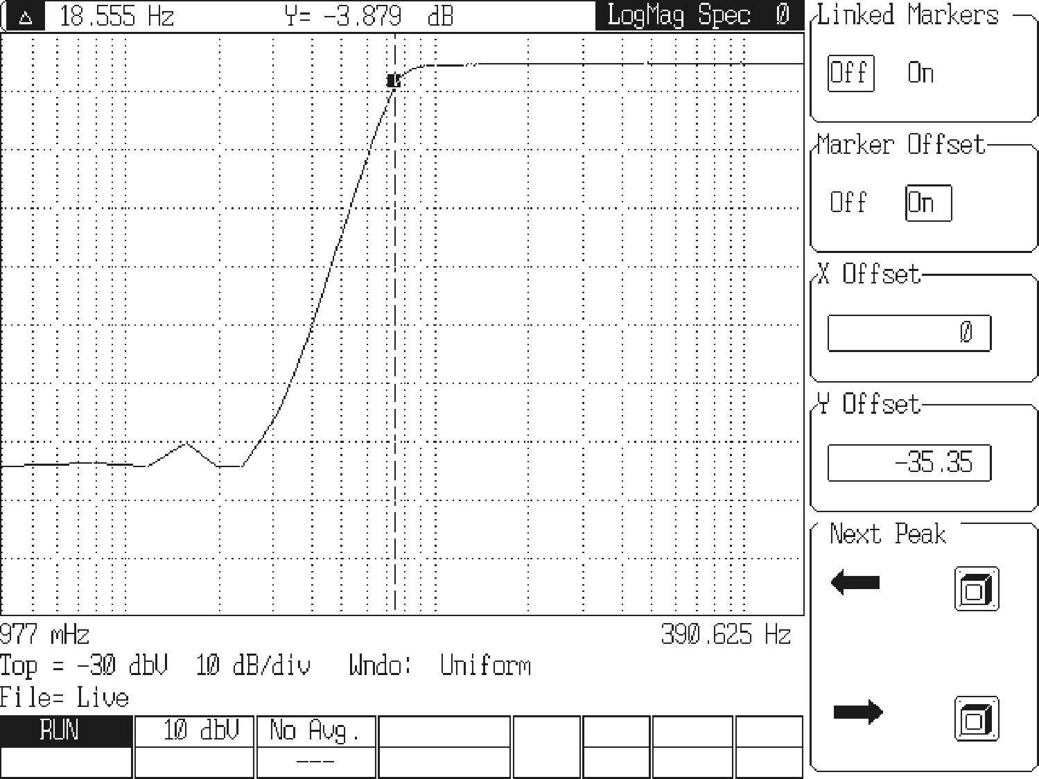

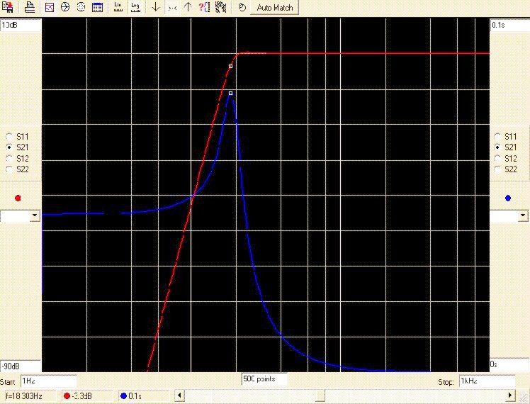

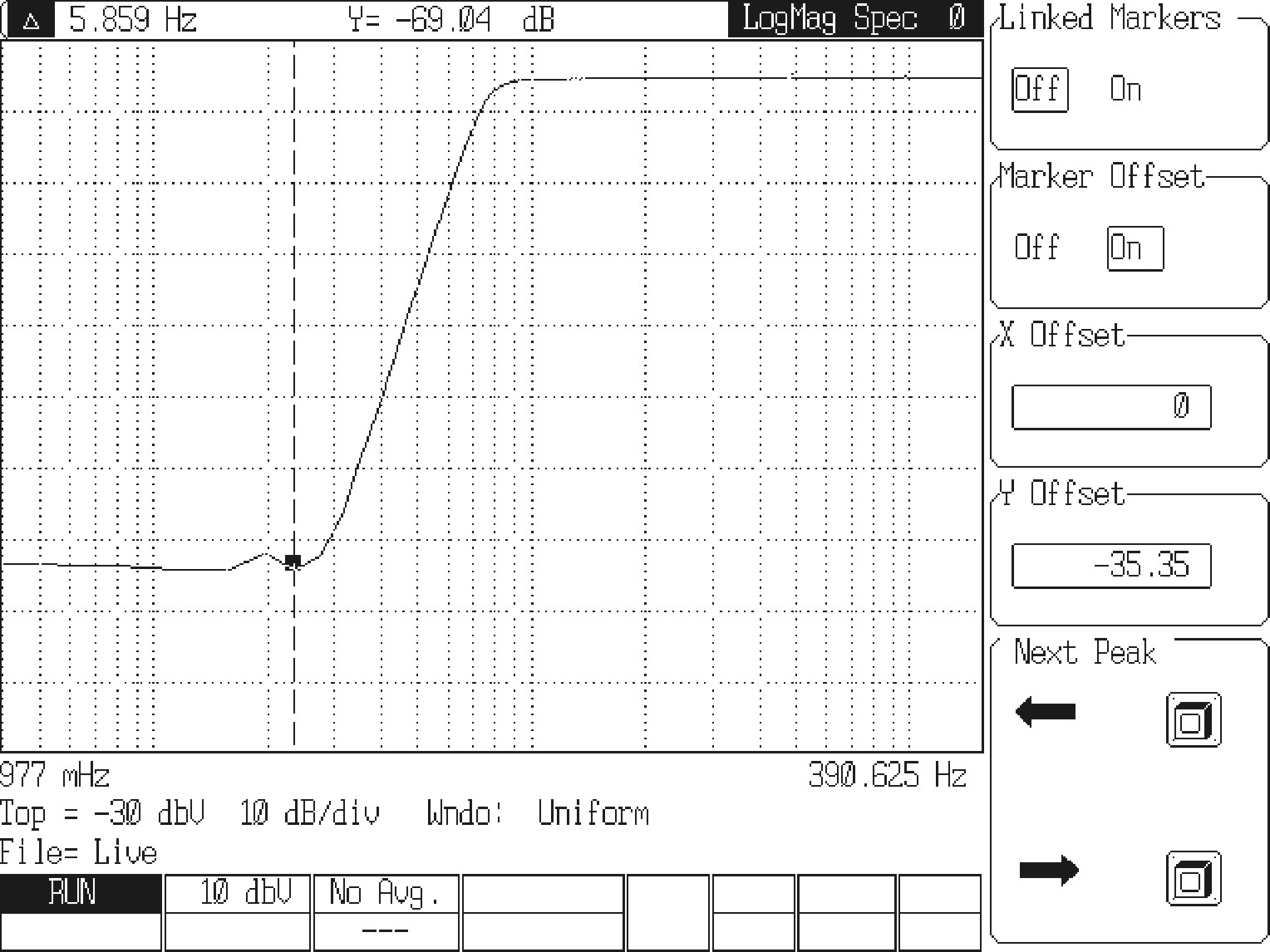

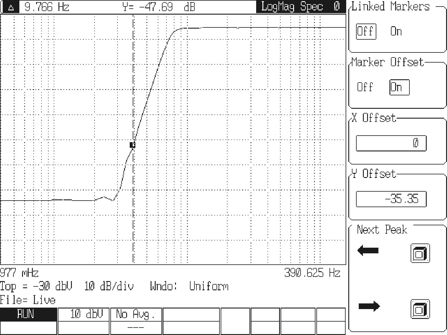

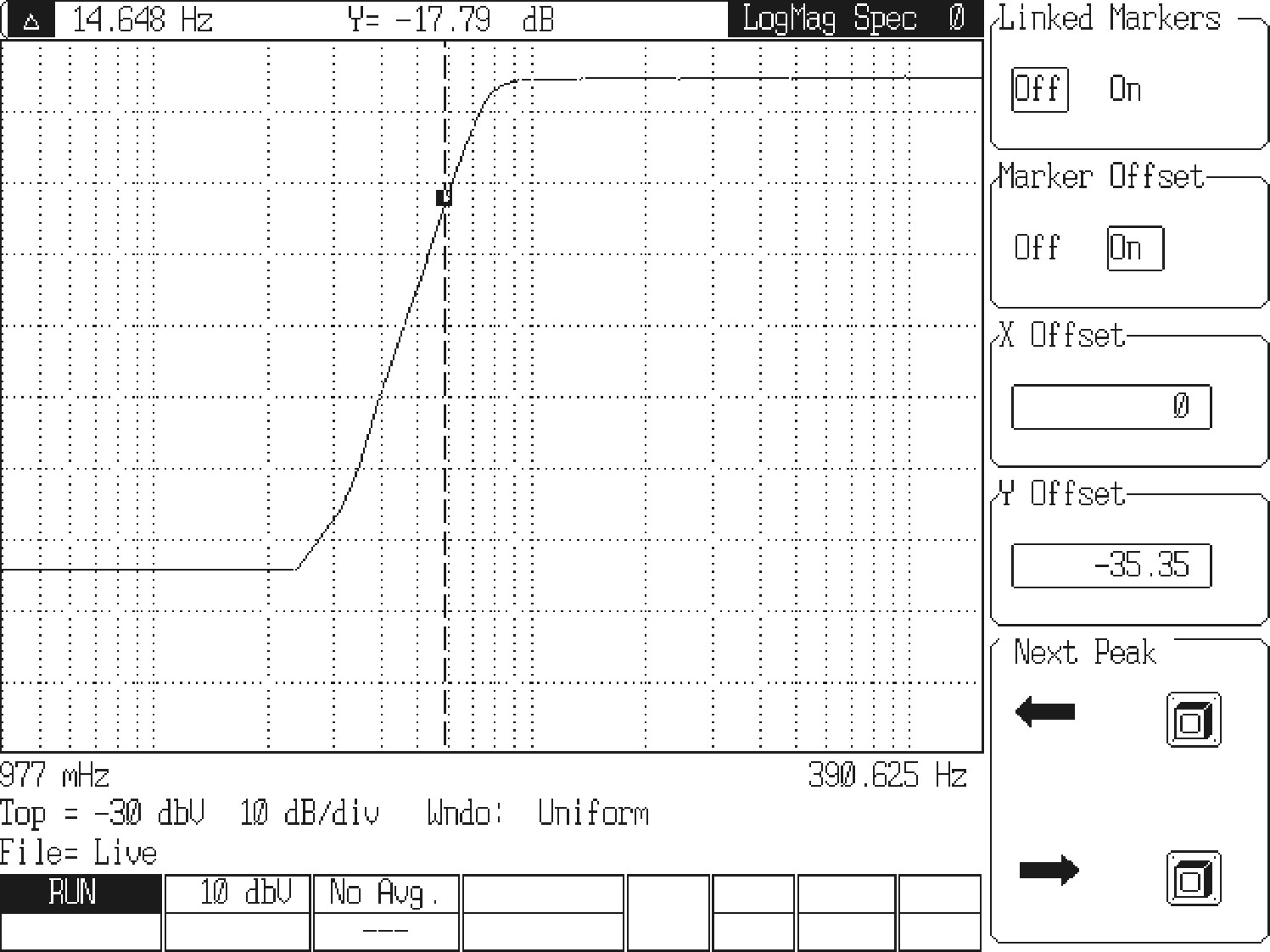

8 pole BW 18Hz HPF
While the general consensus seems to be focused on eliminating the cause of subsonic oscillations at the cartridge/tonearm interface (which I agree is the best remedy), I've experienced this problem first hand after changing cartridges and have (so far) been unable to cure it. Assuming I can find a mechanical solution, I still wanted to try a conventional subsonic filter in the vein of the OP. I first proposed this circuit in post # 154, but have refined it somewhat by reducing the caps to reasonable values (220n), and was able to achieve excellent results using E24 5% resistors and 5% Wima polypropylene caps.
I breadboarded the design and the measured results closely correlate with the simulations:
-48dB at 10Hz
-3dB at 18 Hz
-1dB at 20Hz
-0.1dB at 24Hz
I sent the Gerber files to OshPark and should have a working prototype in a couple of weeks. If there is interest, I can share the PCB via OshPark and make the schematic and BOM available as a DIY project.

So I guess there's still no interest in differential rumble/warp filtering...
It's and interesting approach, but is it effective? Hans has pointed out that oscillations in the vertical mode may not be exactly 180° apart, therefore they will not sum to zero; this would seem to imply that the motion is not purely vertical but may have some random horizontal movement as well.
I just looked at the response from my new cartridge during oscillations caused by record warp on a dual trace DSO and the signals (~10Hz) are closer to 90° than 180°. In this case at least, a conventional HPF will be more effective.

The result looks like this:
This particular filter is set for a 300 Hz vertical.
There is no peaking. The mono sum (red) is unity.
Both the vertical (blue) and crosstalk (violet) slopes are 12 dB/octave.
There is over 35 dB separation at 1 kHz.
