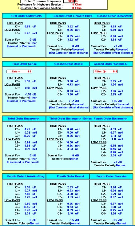

I don't understand the question and it's been many years since I read Linkwitz's AES article, but as far as I recall, it was about a two way loudspeaker with the tweeter above the woofer. The Linkwitz-Riley filter ensured that the main lobe was horizontal and that there was no +3.01 dB bump on axis. The summed response was an all-pass response.
Basically the compromises he accepted were the phase shift of the all-pass response and the -3.01 dB dip in the power response (power integrated over all directions). He argued that the all-pass response was no big deal, because all-pass filters are only audible when their quality factor is very high.

Power response dip, so quite a hole in some directionsa 3.01 dB dip
Nulls are the same with even-order Butterworth and Linkwitz-Riley. With odd-order Butterworth, the radiation pattern gets tilted, so you still have nulls, but at different (vertical) angles.Sometimes maybe. What about nulls? (I suspect you're talking about something different?)
