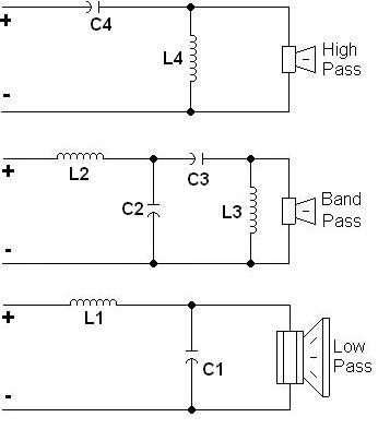

Sorry about that. 300 is a typo. It should have been 3000Hz.150 and 300 Hz ?
That doesn't make much sense for a 3 way.
Linkwitz Riley just has a filter Q of .5
Far as the very generic filter topology of a 2nd order 3 way
To answer your first question, yes the topology of the filter is the same.
And yes the inductor and capacitor values would slightly change.
To change the Q of the filter cutoff.
Linkwitz Riley Filter has a Q of .5
Butterworth Filter has a Q of .707
Additional components could include padding resistors to match driver levels
Impedance compensation, Baffle compensation, notch filters etc etc.
Every driver is different.
Generic filter calculators usually don't yield optimal results
Might be more useful to describe your project
and what drivers your using.

Thanks for the info but they both look the same so is the difference in the values of the caps and inductors?
Yes. The topology is the same, but the behaviour is determined by the values of caps and inductors.
