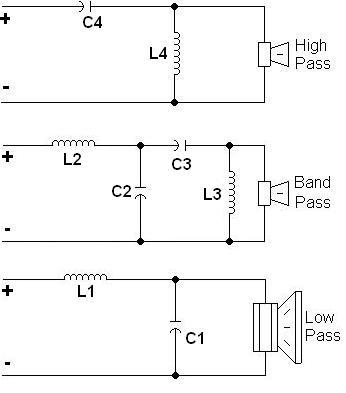

I'm not sure to follow you about difference between horizontal or vertical plane, the kind of filter used isn't the only parameter at play. You talk about coax, but there is other way to achieve 'control' over vertical directivity.
I think i agree with MarcelvdG pov in general. There is some other details which i would check too to make a choice between them but it is application related.
A 3 dB bump in the on-axis is a lot - depending on the Q of course. I think I prefer the LR 4 filters in general. I'm fond of smaller midranges and waveguided tweeters in 3 ways. I could simply try and make a filter with BW instead to see if I like that better.For Linkwitz-Riley versus even-order Butterworth, rather whether you want a 3.01 dB dip in the total power response or a 3.01 dB bump in the on-axis response.
On the thread topic the even Butterworth and LR are no different if you EQ them globally for a flat response.
Which is because two Butterworth makes one LR - right?On the thread topic the even Butterworth and LR are no different if you EQ them globally for a flat response.
You can use the global equalization to correct for the 3.01 dB peak in the on-axis response and cause a 3.01 dB dip in the power response, or the other way around.
Pick your poison eh? 😉You can use the global equalization to correct for the 3.01 dB peak in the on-axis response and cause a 3.01 dB dip in the power response, or the other way around.

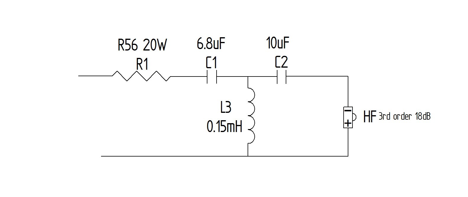

Looking at a schematic that is developed for a constant impedance of 8 ohm and giving it a name would be somewhat of a gamble.
What about the roll off of the driver itself? Shouldn't we at least mention that? An electrical crossover, or even an active one with a
name does not guarantee the wanted acoustical crossover. That would be the first thing I would like to make clear to the OP.
Yea, in theory the LR crossover would have a dip in the power response. But what would happen if we create (named) crossovers with on line
calculators and slap it on real drivers? I bet you'd have more to worry about than that power response dip...
Isn't it our job to warn about these kind of differences? Be it with passive or active crossovers?
