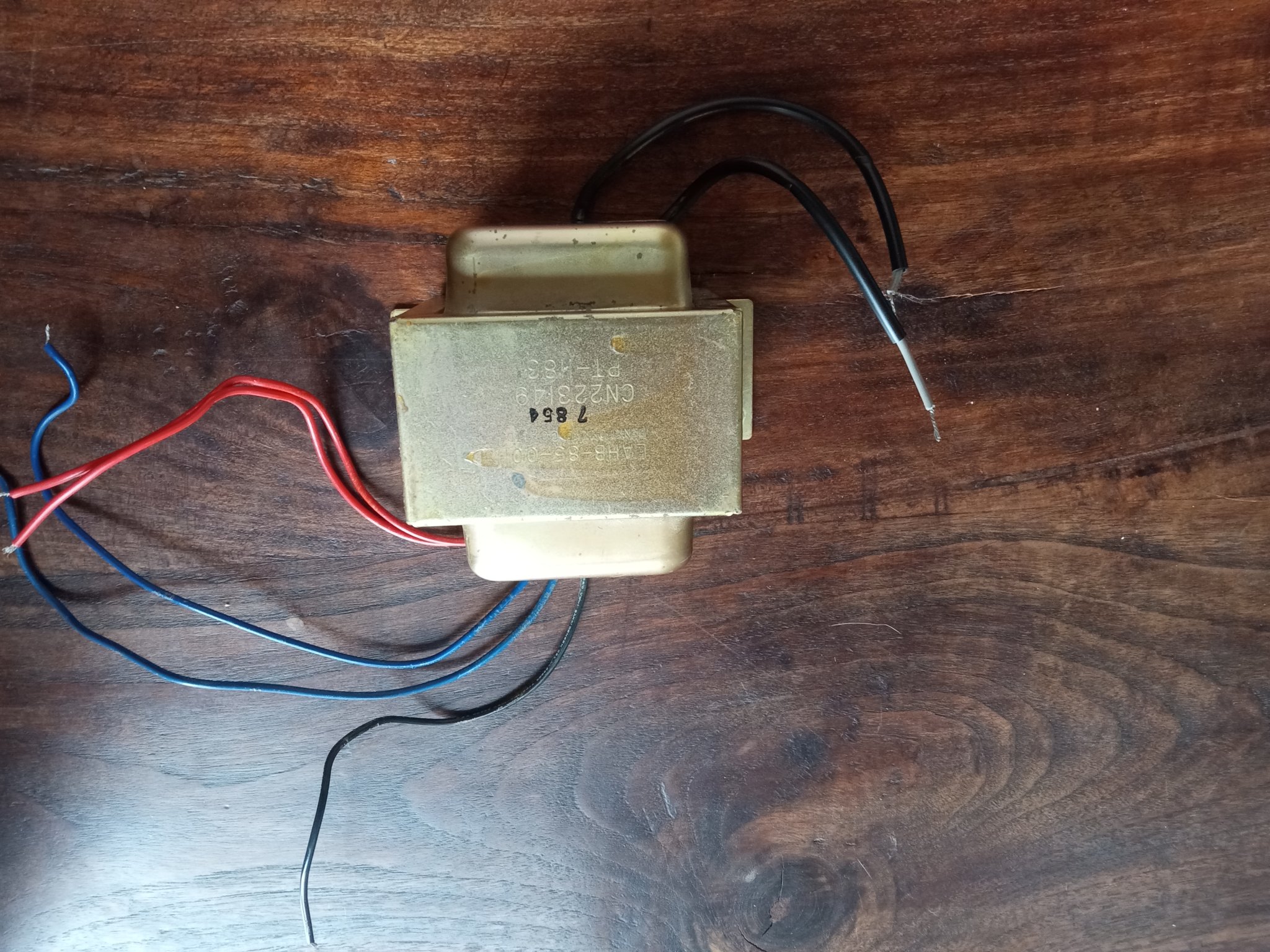

Hello,
I would like to ask for advice on determining the output voltage on the secondaries of the attached transformer, to see if it is suitable for use in a future build. I gutted it from one of the many commercial amps I tore apart looking for some parts. So here is a pic and some info I have obtained already.
The transformer has written on the top:
LAHB-85-00
Denki Onyko Co Ltd
CN223149
PT-1183
My measurements with DMM and no mains power:
There is continuity between:
1. 2 thick separate black wires, measured 3.3 ohms.
2. The thin black wire and both the orange wires, measured 0.7 ohms on each blacl/orange combination.
3. The 2 orange wires, measured 1.0 ohms.
4. The 2 blue wires, measured 0.3 ohms.
There is no continuity between :
1. The thin black wire and the blue wires.
2. The orange wires and the blue wires.
Also, I got brave and hooked up the mains to the 2 black thick wires as I thought these were the primaries. I then proceeded to test the thin black wire ( I assumed as ground) in combinations of the blue and orange wires. Below are the results.
Voltage at the mains: 122V, measured at 2 black thick wires
Voltage with the thin black wire / 1st blue wire was 7.8V
Voltage with the thin black wire / 2nd blue wire was 3.4 V
Voltage with the thin black wire / 1st orange wire was 29.3V
Voltage with the thin black wire / 2nd orange wire was 29.3V
I am just flying by the seat of my pants trying to learn something here, and any testing advice would be welcome. Have built a bunch of projects, but transformers were always a given.

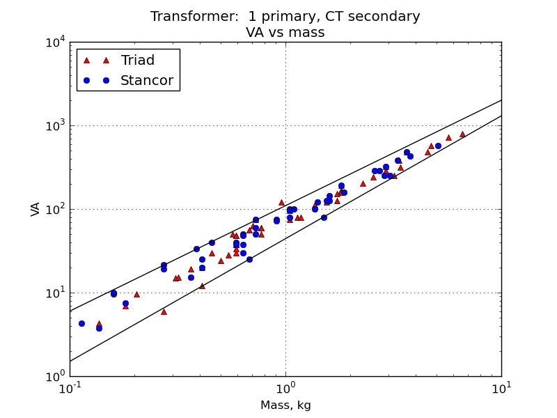

At https://forum.allaboutcircuits.com/threads/assessing-an-unknown-transformer.38273/
I found this graph, which is a first hint about the power rating of a transformer:

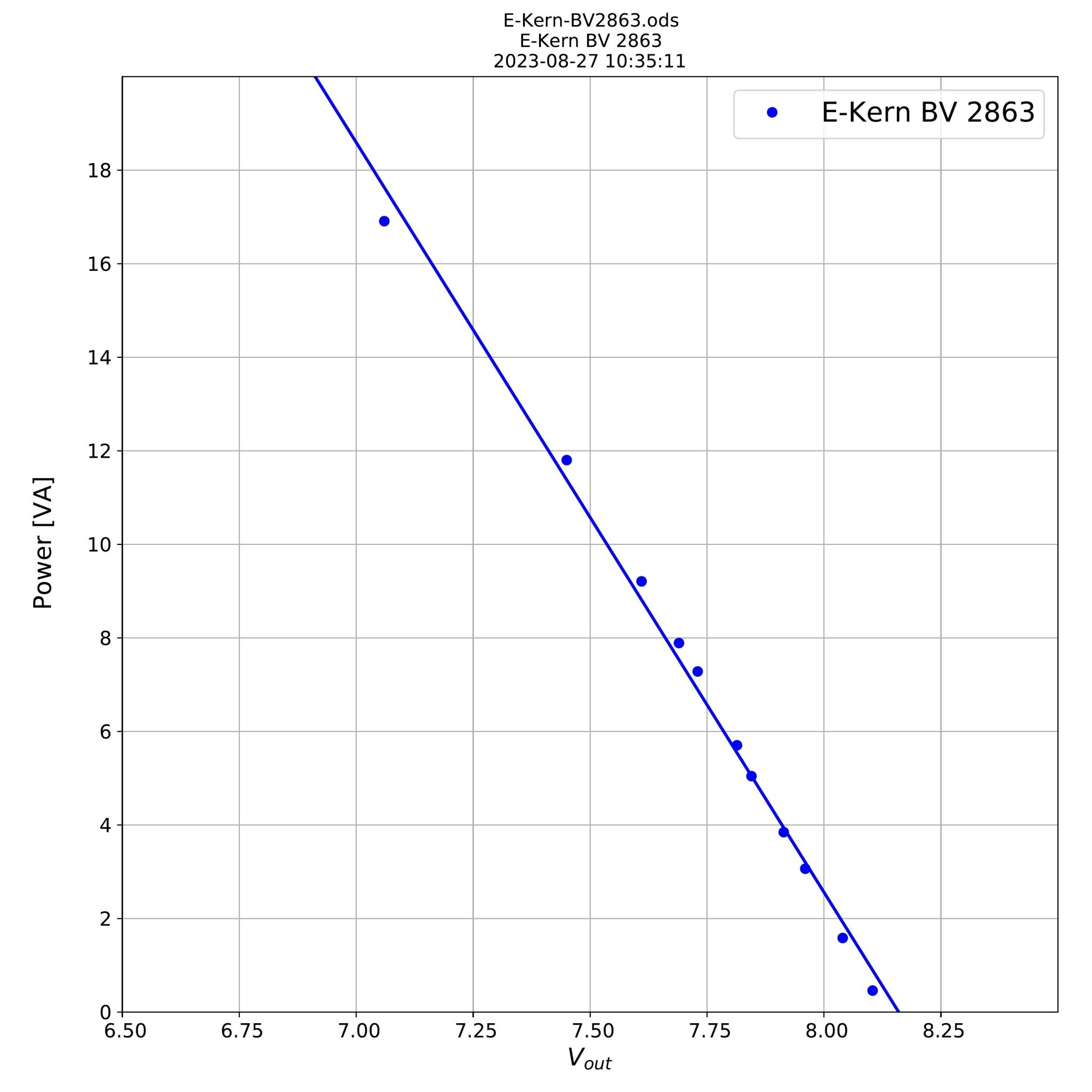

Regarding the regulation, I made measurements on a small transformer (23x51x62 mm core size, 430g):

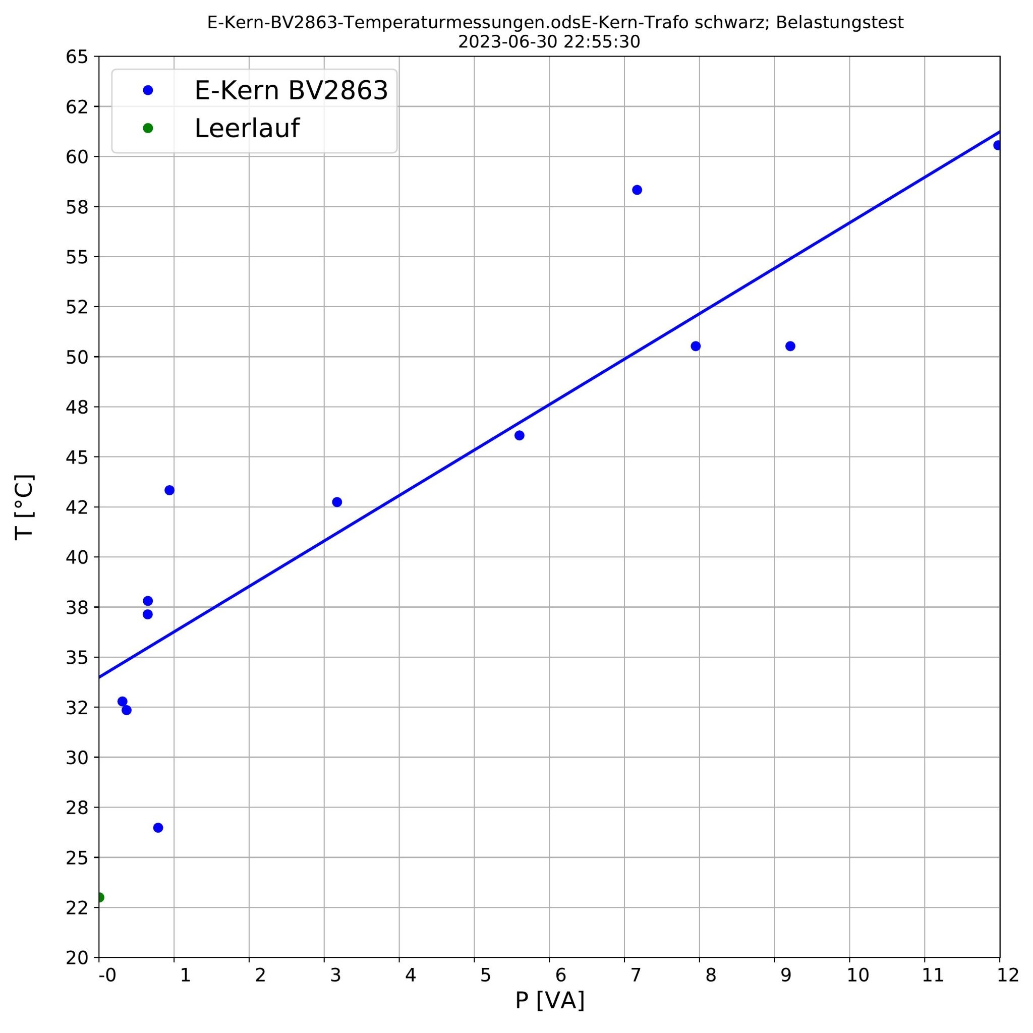

For estimating the power rating, I used the physics of temperature-dependent resistance of copper. The temperature coefficient for copper is 0.00393 / °C. So I measured first the resistance of the transformer secondary winding at room temperature without load with a Kelvin probe (four-terminal leads going into a 34465A DMM), then the transformer was loaded with various ohmic loads for at least 1.5 hours. Then the resistance of the secondary winding was measured immediately (to avoid cooling). The results look like this:
Not a perfect relationship, but it is possible to estimate the maximum power for a given/wanted/accepted rise in internal temperature.
Inserting the mass of the transformer into the first graph would give a power rating of about 25VA, which, IMHO, would give a too high temperature of about 90°C. But considering the logarithmic scaling of the first figure, the measurements seem to agree roughly.

For getting an idea about voltage regulation (from this RDH4 chapter I learned that Americans use a different way of calculating it than the British), you should add ohmic loads at the output and measure both voltage and current (AC). Within the power rating you should get a linear relationship between power and voltage as shown above in my first post.

Thanks a lot guys for the tutorial on determining the approximate VA of a transformer, great info. I was really just looking for a confirmation on determining which of the wires were the primary and which were the secondary, and whether my testing procedure was correct in determining the voltages.
Should I have tested orange / orange and blue/blue also?
