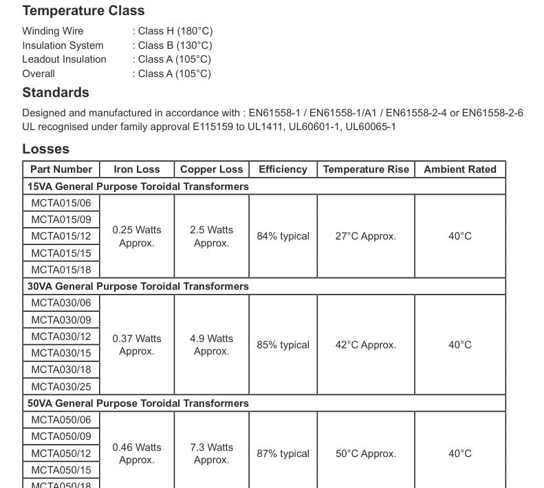

Transformers - they have a strong tendency vary according to what they cost. This is the sort of info that should be available where they are sold if bought from an electronics parts type place
Those are toroidal but the same applies to all. As you can see the temp rise fully loaded will be ~50C on a 50va part. It is possible to buy stuff that will get hotter than that and assume ambient is lower than 40C. The regulation will suffer as a result.
This range has split primaries and secondaries, They can be used in series or parallel. These are
Dual primary winding for connection in series or parallel only Input Voltage : 115 or 230V ±10% 50/60Hz.DC Resistance : 2x 2.13Ω to 79.1Ω ±15% @ 20°C Magnetising Current : 2.5mA to 47mA approx.@ 230V 50Hz (5mA to 94mA approx. @ 115V 50Hz)
The dual 115v primaries are pretty common as they can be used in the USA and Europe.
