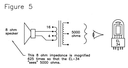

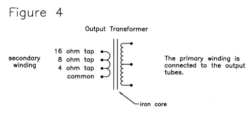

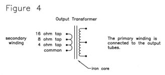

Now I'm relieved that between Tony's book and edbarx' knowledge, there is sufficient information and brainpower to rebuild civilization from scratch after the Armageddon. I would like my attached illustrations included in that pamphlet.
But until then here's my practical take on transformers: Totally opposite to three-legged fuses aka transistors, transformers are four-legged (at best) short circuits (worse actually) impervious to damage! But both transistors and transformers can be analyzed in terms of wimpy side and hefty side. Wimpy, hefty. Start with that. Any questions?
