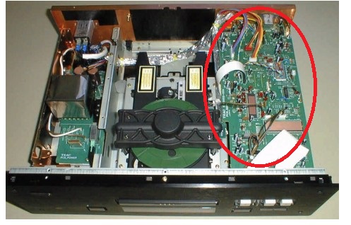

Using them as a transport
Most use the rare as chicken teeth KSS-151A laser, so forget those.
The only ones to get are the VRDS-7 VDRS-8 or the VRDS-T1 as they have lasers you can get new and cheap.
I have the later VRDS-7 bigger than the 8 and later than the T1.
But what's good is for transport use, just two connectors completely disable the dac section (circled in red) and remove it from the powersupply, then the whole lager power supply is then just for the transport and not shared with the dac.
Cheers George
