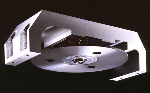

Okay, so I worked more on my heavily modded Copland cd player, and took a closer look at the thin metal sheet bent but not welded in corners, cable bridge that also serves as a stiffening connection between the drive and the double top plate chassis on the VRDS-10. As I mentioned, it's not welded in it's corners, so it's inherently flexy and wobbly.
This can be easily made better by welding it carefully around the open bent corners. Also, do a second screw each side to supplement the stability of footprint.
I chose a further step, by designing an as large and massive aluminium bridge, bolted to the upper chassis plate of the CMK-3,2-Super drive. This gave a very distinctive improvement in "deadness" of the whole drive and transmission of vibrations are heavily dampened. I spoke to a couple of friends who design these sort of things and this design works well. A small improvement in stability in sound and a darker background - more details. A little bit firmer sound. I'll say a little tightening up things, such as a firmer string on a guitar or a little bit firmer drumskin.
So, next step is to mimik the design of the Super drive CMK-3,2-S on say P-70, with it's teflon sheet and a 6mm stainless plate on top for further deadening any ringing etc. More on that and other mods later.

Right, so it's been a while. I have now modified the extra heavy aluminium bridge that I made earlier on, to entail the same dampening as the P70/Wadia 861SE drive, so that there is in effect a very efficient dampening sandwich consisting of the heavy aluminium bridge below, then a 1,5mm teflon sheet cut so size in the middle, and on top a 6mm piece of machined hardened stainless steel. Bolted together exactly as Teac did it on their drive.
Sound has become another level, and bass is very very deep and more precise. Treble is full of details and not at all tiring. Voices are just mesmerizing. Overall soundstage has become a little big bigger and more black in background. But the most present feature in sound on the change to the drive, is the attack, transients. They are really seriously fast. A kick on a drum or a fast guitar rif, is so super fast. A very very good machine now.
I can highly recommend all these rebuilding things if you can access a P70/Wadia 861SE drive or just the upper part of it, and of course the rest of the CMK 3,2 drive and then the accompanying servo board from Teac. Remember to make it play, you have to solder in 3 little legs to circumfer the filter at the connection of the Teac servo board. If in doubt, just PM me, and I will help.
