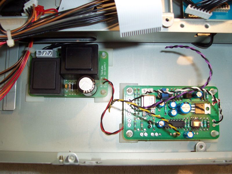

Which are the essential mods to be done to a VRDS 25 or 10SE for use as a transport?
clock with its psu, then?
Here is a pic of the Tentlabs XO3 and XO supply mounted under the main digital decoder board (board to go on top) is is the best position for it as all leads are kept to a minimum.
I have done close to ten now Vrds-T1 Vrds-10 Vrds10se and Vrds-25's
The difference in sound is very noticable with all models, more extension top and bottom more grunt to the bottom end, yet tighter, top end is more extened and floats out from the speakers, instead of being squeezed out of the tweeter, overhaul a more relaxed presentation yet more dynamic.
Cheers George
Cheers George
georgehifi said:Here is a pic of the Tentlabs XO3 and XO supply mounted under the main digital decoder board (board to go on top) is is the best position for it as all leads are kept to a minimum.
Thanks, I'll use for sure XO3 and XO supply, but i was thinking also to upgrade the digital outputs since the main use of the 10SE that I'm buying is as transport.
Any more useful mods? I have about 400€ budget, covering also labour.
Besides, I wrote to Guido Tent and I'll buy the components from him 🙂
When you instal the XO3 make sure you use it's better spdif output, it sound better that the Teacs 10SE's.
That's it you'll have a word class transport that will be near impossible to beat.
Cheers George
Cheers George
georgehifi said:When you instal the XO3 make sure you use it's better spdif output, it sound better that the Teacs 10SE's.
??? Does the clock have a spdif output ?
Vrds-T1 Vrds-10 Vrds10se and Vrds-25's, which one is best as transport ?
What brand decoder chipset does teac use ? Sony ?
Yes the XO3 has a spidf output, the 10, 10se and 25 have the same mech and laser the T1 is a little cheaper in it's mech and laser but still very good. Yes Sony decoders.
Cheers George
Cheers George
Cheers to you!
What do you think of the shunt regulators? You sure that I dont need to do other mods for transport usage?

Telstar said:
Cheers to you!
Tentlabs power supply has very good galvanic isolation because he uses chokes in it as well, stick to it.
(galvanic isolation ) the noise of the xtal itself isn't fed back through the power supply into the rest of the system. I think this is what Guido said to me one day.
