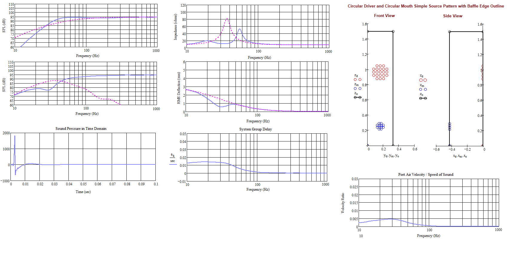

Did you not see my sim? Nice roll off but decent output to 25Hz. Only for low power though (severely xmax limited).As in the field coil under discussion? A good driver I'm sure, but I doubt it could achieve any of that.

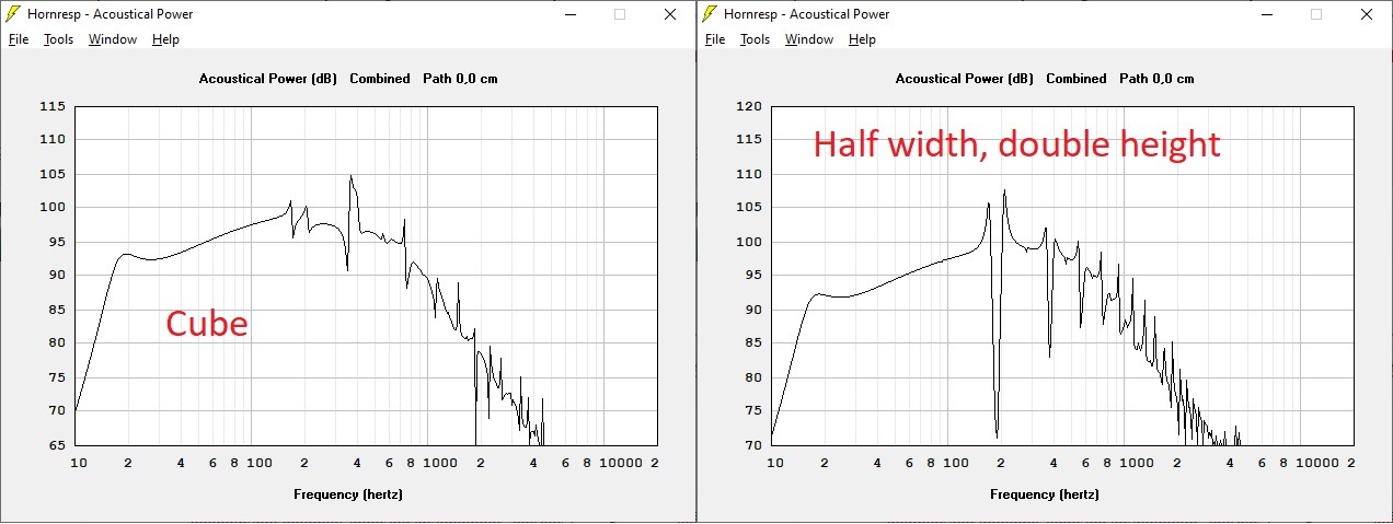

Here's a picture of two completely identical sims in terms of volume and tuning frequency, one is a cube, the other is a tower.
I have experienced this firsthand after making sawdust, it's like a ringing originating at lowest resonance, absolutely horrible if you have a midbass or fullrange driver, not a big problem for a sub (provided you use steep crossovers to deal with it...).
If you halve the width because you want a slimmer design, but you still need the same volume, you end up with: Less than ideal starting point for bracing and breaking internal modes.

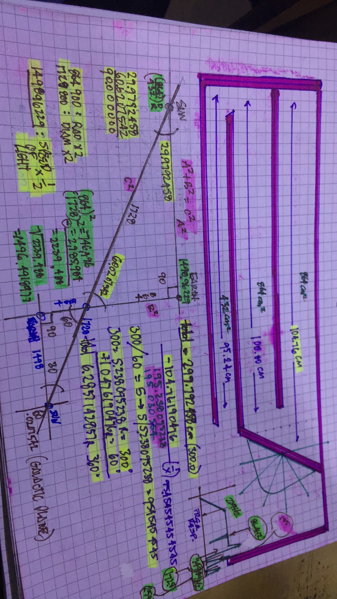

there’s something you can look at in horn response which starts to explain everything and not in a conventional manner or that it’s going to be a miracle right away without taking the time to look hard at it . it’s going to however point out things that no one looks at. All that Martin King did was give us some numbers he’s an engineer he doesn’t know where they come from their math constants. However look at what some of the numbers that we already know actually mean and use radians and, I realize and recognize why that would be so important and so much more accurate and so much more relevant because those are higher orders of circles math, already in spherical trig. Jobs with a 05238 loophole because that’s the speed of light at an angle. Pi /6
in an offset driver transmission line you are required for certain 104.76 cm followed by exactly 195.24 cm in a 300 cm pipe as he asked the driver entry that perfectly isolates the location and first fold in that so that it eliminates the initial void created by the phase 270/90….anomaly at three times the fundamental which itself is already a harmonic of a bigger wave so drawing it is all the stuff or using math will reveal that 300×03492063492 is 104.76.
But 300 is 5.238095238 in radians and 10476 . 300 is 5.238095238 in radians and 10476190476 is 60* makes all of those complete at 6.2857142. 360° or 360 cm if you take all of that and transfer it into a door pipe along with the idea of it and the concept of the driver location for the short side of the qw pipe.
Look at what frequencies are represented it all of those numbers in the space in between them when folded at 90 cm so you have 270 has 3 folds and use 345.6 m/s so that it is easy to see and also it makes exactly connection to the math (no oddball decimal points and all kinds of stuff you’ll never recognize occurs )which allows us to see anything as it’s the function of speed of light or the radius of the sun or 12 seconds in a day it’s very important it’s why nobody ever quite grasps the concept of quite a few things a quarter wave there’s a couple numbers thrown around they don’t pertain to anything in particular their math constant or piece of trigonometry but what they are outside of that that and what they really represent is infinitely more important to check out and see because it leads to understanding all of this stuff it would seem?
nobody’s gonna be able to explain that by typing it but if somebody had a chance to try to go through all that and sift through it I could represent it I’d like to take a shot at cause I have in the last A year or so taking the hardest most complex and closures and breaking up up in the parts to make them simple in the results are astonishing.
